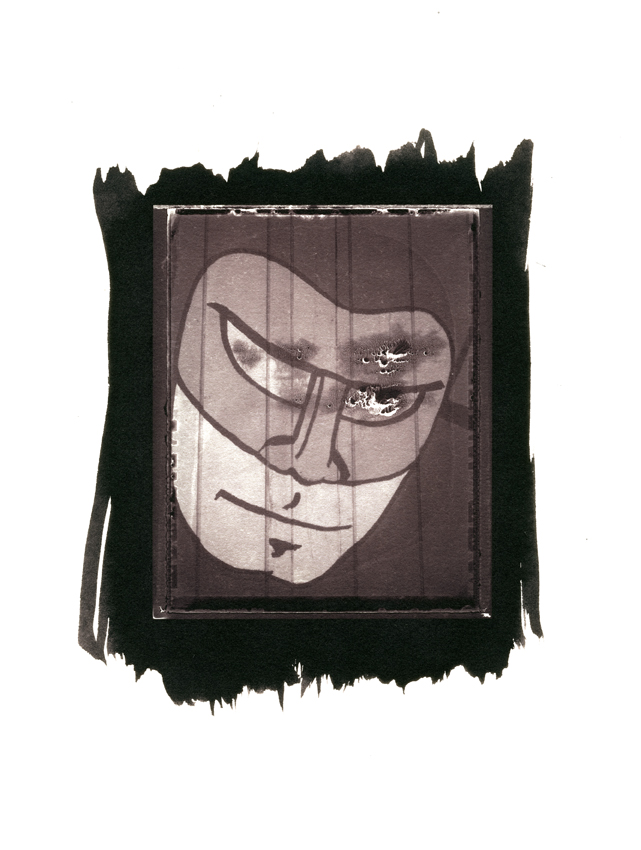

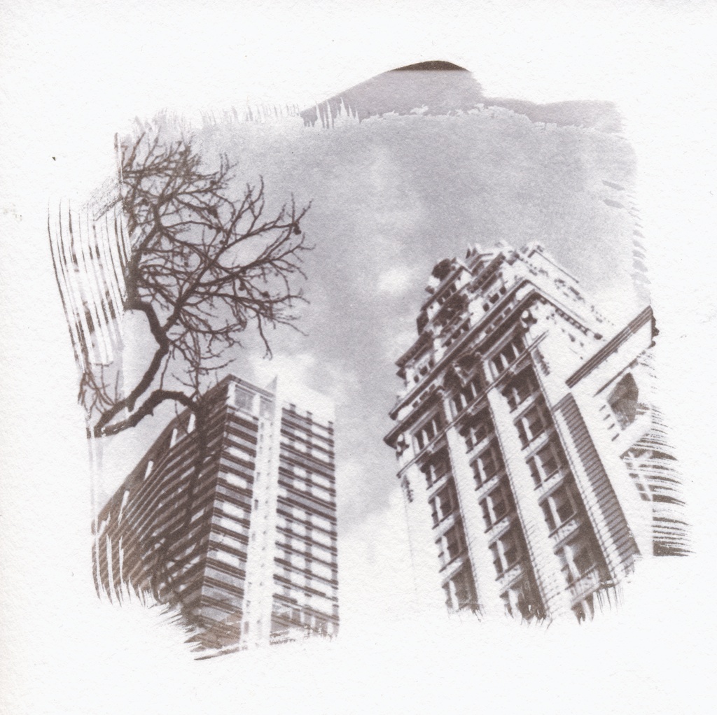

Hmm, that is actually what I'm seeing. Perhaps it's working as intended. I've attached an example, which does follow what you say. Apart from a coating issue on the right side, I'm fairly happy with it.

Guillaume Zuili
Aug 3, 2005
3,005
Los Angeles

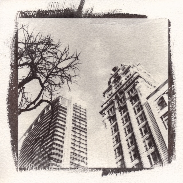

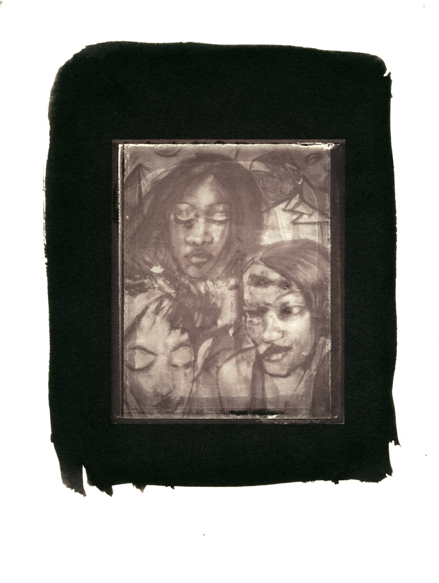

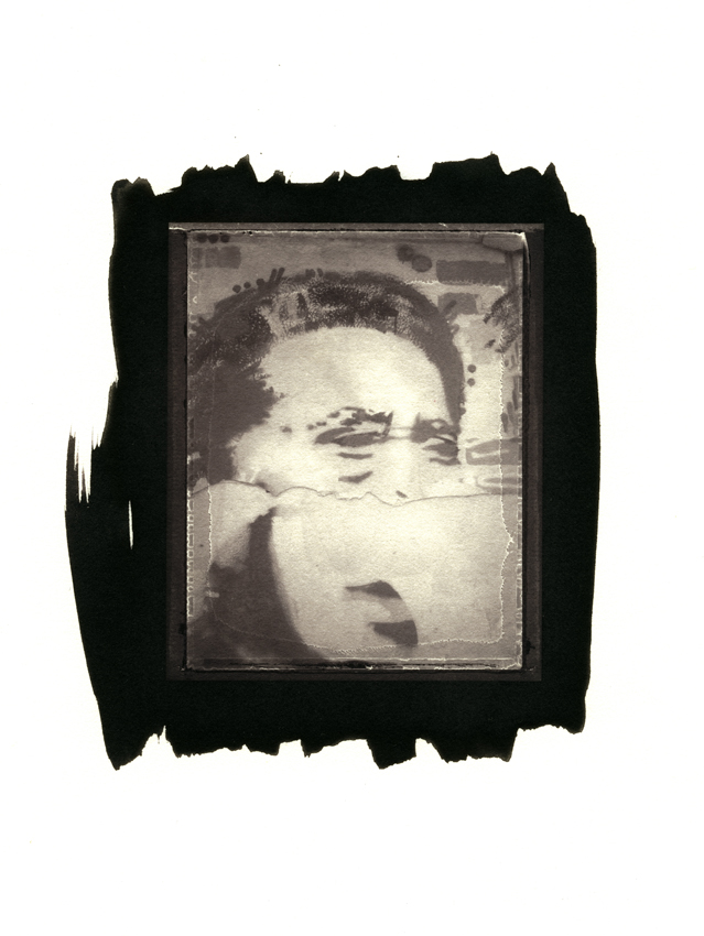

Samples
Here are a few with Borax Gold Toner. See the density of the black around. With toning brown goes away to almost blue black.

Guillaume; I agree that there's not much black in that print, but even with the step wedges, which do go to full shadow values, I'm not seeing the blacks you're got in those examples.

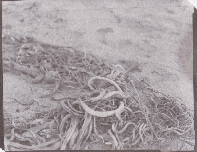

As promised, a scan of the print with good DR, but still a grey/brown tone. Still, it's not bad, but I'm interested to see how the gold-thiourea does. I also verified from the newer step wedge that I had underexposed before, so I wasn't getting full shadow values.

I don't know if it's from the scan but it seems like you still have some potential for a better dmax. This looks like my prints with single layer, double layer were way better. (Again, could be the scan or maybe it's due the difference between or chemicals and/or papers...) I'm sure you'll get a much better result with gold-thiourea. Good luck again!

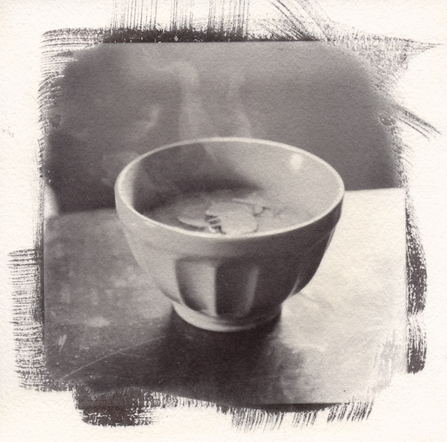

Well, the gold-thiourea was quite successful; it gave a nice neutral grey all over the print. I'm attaching scans of two prints I did today. Now all I have to do is work out what do with the rest of the 0.2% gold chloride solution I have, since the gold-thiourea uses 1%. Thanks for the help everyone!
