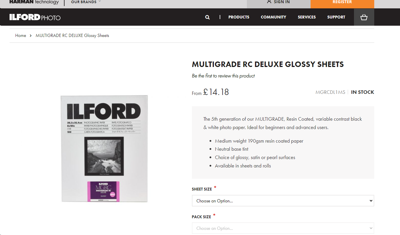

Any experience using a gold toner with the latest (5th gen) Multigrade resin coated paper? I understand this paper is more malleable than its direct predecessor, so should I expect it will cool down considerable. Thanks.

Exactly which Multigrade RC paper? "5th gen" does not help me out.
MattKing
Apr 24, 2005
53,312
Delta, BC Canada
That "5th gen" is an informal designation for the current, neutral tone paper - the most recently released version.
As described on Harman web page:
