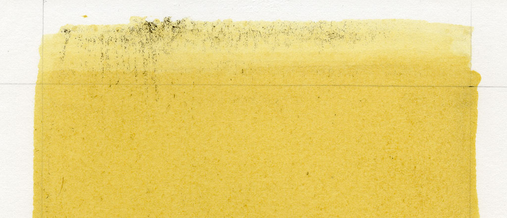

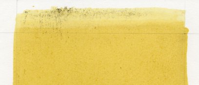

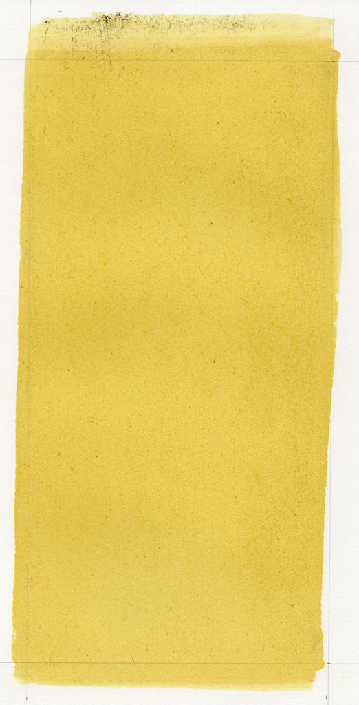

OK, people. I did a test print with 8 drops of 2% L-ascorbic acid (Vitamin C) added to 1.04M (~ 45%) ammonium iron(III) oxalate.
As soon as I added vitamin C into AFO a brown precipitate formed - probably rust, something (we) Pt/Pd printers avoid as hell! This precipitate then dissolved to tint the beautiful bright emerald green color to a darker browner shade...
Then I added an equal amount of 0.52M (~ 13.6%) Li2PdCl4 into it and coated a piece of COT 320 paper - using a puddle pusher. See the attached results.
As you can see very clearly the paper is full of precipitated Pd speckles, extremely concentrated in the upper part - where you pull the puddle pusher out of the coating area and soak the excess. (I could already see the vast amt. of precipitated Pd inside the bead that forms in front of the puddle pusher...)
It wasn't surprising at all to notice these speckles in the coating solution; since there's already Fe(II) in the sensitizer which will instantly precipitate elemental Pd upon contact. This is something we absolutely don't want because:
1. You get flawed prints with speckles - obviously...
2. Your actual strength of Pd is weakened because some is lost to the *unnecessary* Fe(II) in the coating solution - this Pd simply can't be used for the image; it will either stain the paper or washed down the drain w/o any useful purpose. No good fate for some expensive material we pay $$$...
3. We want metal to be precipitated by action of light in accordance to the negative we put over the paper, not by including mumbo jumbo additives into the (othervise healthy) coating solutions.
Now, no self-respecting Pt/Pd printer would actually pursue with this paper; they would simply rip the paper off and look for the source of "contamination" in their materials / workplace instead... In this case we know the contaminant; it's the vitamin C in the sensitizer, plus the uneducated / wrong assertions / claims by Mr. Puckett - eventually.
I printed the paper anyway, it's drying now. I'll print another test with the standard formula (= no vitamin C addition) and compare them side by side later today or tomorrow - whatch here.

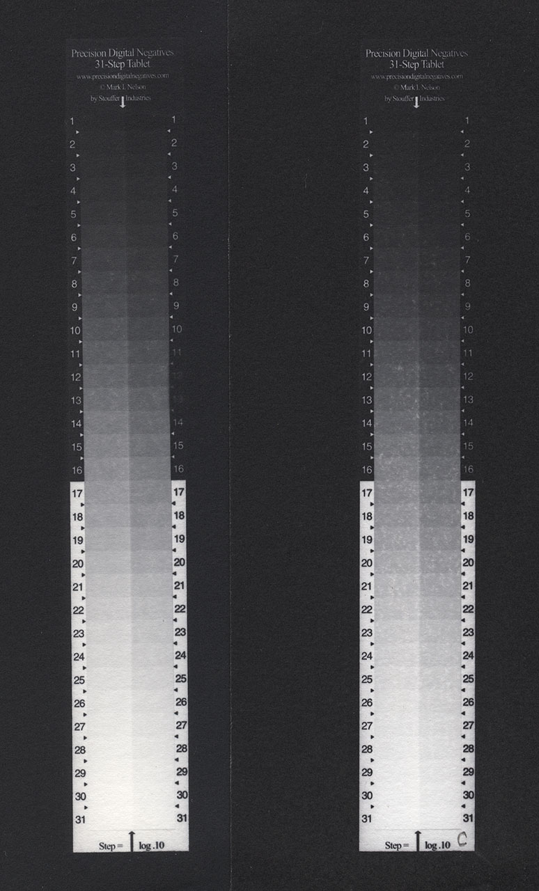

Ok. As I promised, you'll find the scan of the pop pd test prints together, attached to the end of the message. (I scanned them together in order to eliminate exposure & settings differences that may happen between two separate scans...) I'll let people decide which one's is better technically - a picture is worth a thousands words. The test print with the ascorbic acid "contaminant" is on the right (marked with a C letter) and the test print made with the standard formula is on the left.
Both prints were made on the same paper (COT 320 cut in half) using exactly the same workflow. 26C, 50% RH, air dried for 30 minutes, exposed for 16:00 minutes under a bank of BL tubes.
Hope this helps.
Regards to all,
Loris.
