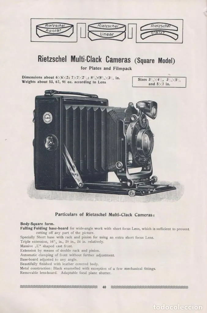

Sounds rather a special lens and now I am more curious about this lens and want to ask what is its specialty?
Seems they are constructed like a dagor type but I may be wrong.
The Linear is not a Dagor type, but you could say that it's a variation of the same theme. I read that the eight element Linear is better corrected for coma than the Dagor, so you get better results when using the Linear as a convertible (the back component only for longer focal length). The Linear is also faster, 4,8 or 4,5, which makes focusing easier.
Rietzschel's Apotar and Sextar are similar to the Dagor but the second element is a positive meniscus and the third element is double concave. The Linear looks similar but has the middle element split in two, probably with different glass types. https://cloud10.todocoleccion.online/camara-fotos-antigua/tc/2020/04/01/13/198899206_198578580.webp
On the picture you can also see the Rietzschel Dialyt. It's a double-Gauss lens, and not like dialytes like the Dogmar or Eurynar, but "dialyt" means "separated", so the name is still correct. The front and back components are separated achromats that allow the elements to have different radii for better corrections.
