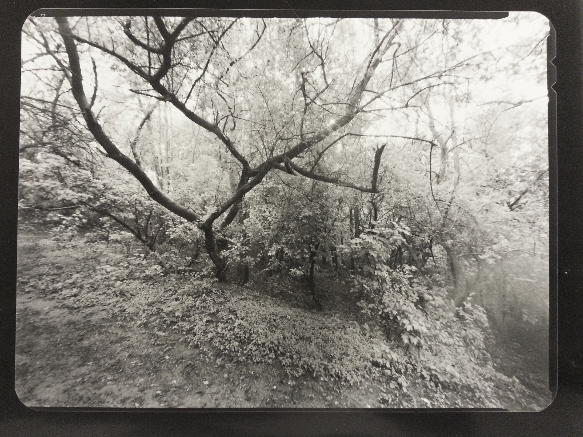

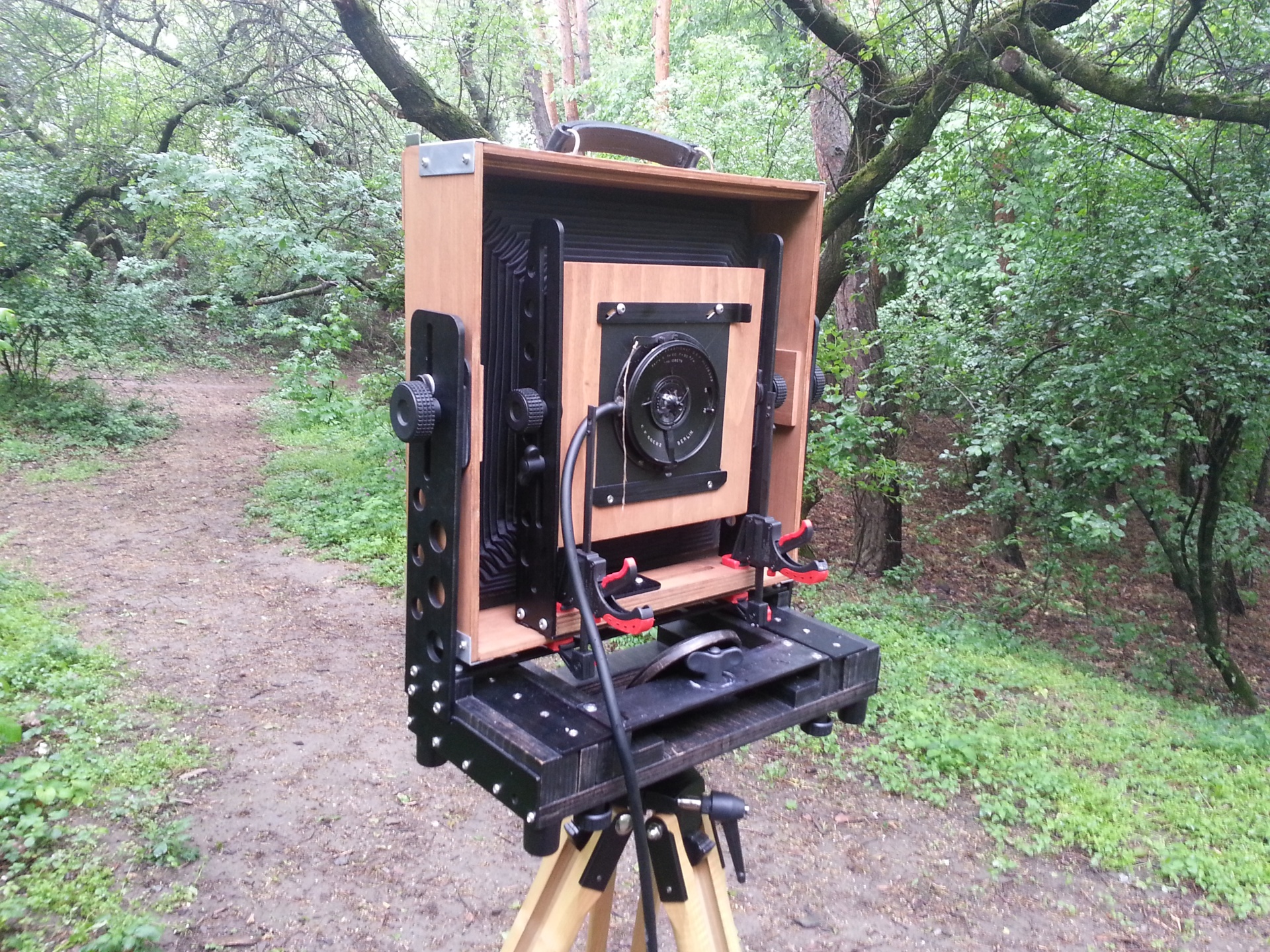

New user of 90mm here, trying to modify my homemade 8x10 (actually using 18x24 cm) camera.
Now just finding the proper infinity BFD, i am afraid first try was something wrong as corners are very mushy. Or when i was clearing the lens (quite dirty due to bad storage) i moved something - but as there are only 2 elements, I doubt it.
For my apologise: it was really dark so i didn't see it on GG and i was in hurry, rain was coming.
I've adjusted distance from film to lens and will try again.
If somebody knows proper back focal length please write :smile: but i think according to f32 it doesn't need to be precise.

Make sure your front and rear standards are parallel. I use a laser.
Imaging how hard it would be trying to get a sharp side-to-side image with a 90mm lens on a Hasselblad holding the lens on with some wood clamps.
durotomik
Dec 27, 2010
6
Ic-racer,
You're right. This was just an quick improvisation to see if it works at all. I made another test yesterday with different focus and it looks promising.
I just wonder how much is depth of field on 'film side' - i was trying different focus and few mm didn't make any difference on f32.
