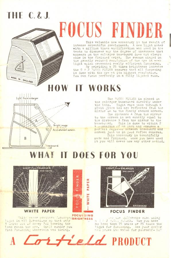

17. And really, what is this? A negative viewer? A grain magnifier? How does it work??

Hi Debbie
I have an answer to your point 17 as I have one of these myself. It is called a focus finder and here are the instructions on how to use it:
Cheers
Ian

Hi Ian,
thank you so much for your help. So I already have a focus finder now, that is brilliant!
Cheers
Debbie
