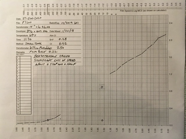

I've ordered a wedge (have a 4x5 one, but that's a bit impractical for film) and actually received that exact book a few months back (along with the 4x5 wedge) for free, though I haven't dove into it yet. Either way it'd definitely be nice to compare developers in a more objective way, even if still judging density by eye. I'm also really interested on degrees of highlight compensation, which are very difficult to judge using standard subjects.
So this is off topic for this thread, but maybe someone has ideas and I'm not sure its worthy of its own thread. Anyway, I took the recipe for my EXG1 developer and changed things around quite a bit, aiming to create a high definition version of the developer, primarily by reducing the carbonate, halving the glycin, and adding an equal amount ascorbic acid. Roughly measured pH was 11 before developer and 10 afterwards. I assume the pH drop is due to ascorbic acid oxidation products being more acidic than ascorbic itself, when combined with the weak buffering system in place. Theory is that the ascorbic acid would create edge effects and is also known to increase speed (ie, xtol). The results are frankly great, a good reduction in grain levels but a definite increase in apparent sharpness with the addition of some minor edge effects... however, with this new formulation I did finally get the famous 1 stop of speed loss with glycin. Specifically I did tests with FP4+ and Ilford Ortho 80. The Ortho 80 came out absolutely perfect. The FP4+ appeared to just have a straight up loss of 1 stop in speed, the shadow detail that should've been there just wasn't until I over exposed it by a stop (at which point it looked great). Kind of off-topic, but what approach does one use for diagnosing why the loss in speed and what can be tried to return it back to box speed? Phenidone is an easy way out, but I'm skeptical about using phenidone due to its tendency to fog at this pH level and reputation for being difficult for maintaining sharp results and easily running away with highlights (which this developer already does to some extent, only weakly compensating). Additional carbonate for stronger buffering might work, but I fear this would lose the sharpness effect as well since the ascorbic acid products would be more easily removed in development. I've thought about just doubling up both the glycin and ascorbic acid, but unsure what the result would be really.

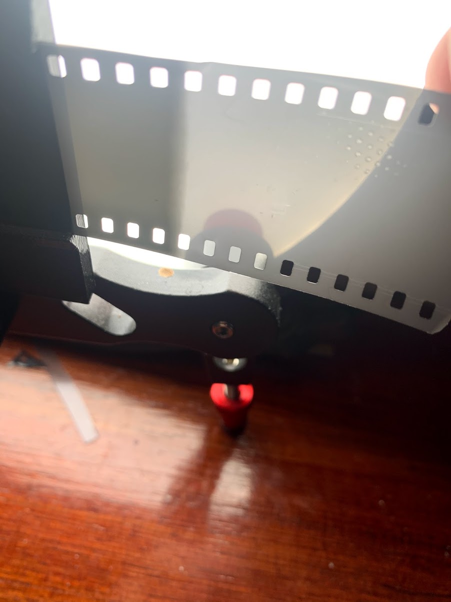

Interestingly, this developer also had a very peculiar effect I've not seen in any other developer. (see attached) the right most side of the picture is the film leader, ie, what was exposed to light for a very long time outside of the canister. The lefter side is what was pulled out of the canister to load it into the camera. I didn't do this in a dark room or anything, so the expected result should be either both equally black due to being very exposed, or the right side slightly more black. Instead, the right side is significantly lighter than the left side. I assume this is a strange "inverse" compensation due to the ascorbic acid reaction? Very strange and not sure what it actually means

If you say "good reduction in grain levels but a definite increase in apparent sharpness", then what is your reference developer you compare this against?
If you look at the development process, there is the initiation of development, when tiny developable silver specks start building up, and there is the rapid development phase, in which silver builds up quickly. Phase 1 is governed by the reduction potential of the developer, and by the degree to which the developer adsorbs to the silver halide grain. Phase 2 depends on these same factors, and in addition on how quickly fresh developer is brought to the grain and how quickly oxidized developer is either restored or removed from the grain.
If phase 2 is much faster than phase 1, then you quickly build up contrast, while smaller developable silver specks remain mostly undeveloped, and you see this as "speed loss".
PS: People have seen better sharpness with Metol than with Phenidone. Since you want to make an acutance developer, you could try to add small amounts of Metol to your developer. In both cases you'd have to reduce pH by quite a bit.
PPS: Since you now have brought Ascorbic Acid into your developer, make sure you have read and understood most of the stuff Ryuji Suzuki has written about this topic. Study his DS-12 developer formula and try to go from there.

Cleared highlights... I read that the other day when I was trying out some Benzotriazole.
I could be wrong but if you are talking about negatives, then it’s to reduce fog. If you’re talking about prints ... reducing fog is the same as keeping highlights clear.
So I think that’s what the literature means by keeping highlights clear.... positives
Bill Burk
Feb 9, 2010
9,312
As for losing speed... Benzotriazole gives that to you... I got P3200 down to EI 250 even with a slight degree of development above ASA parameters
