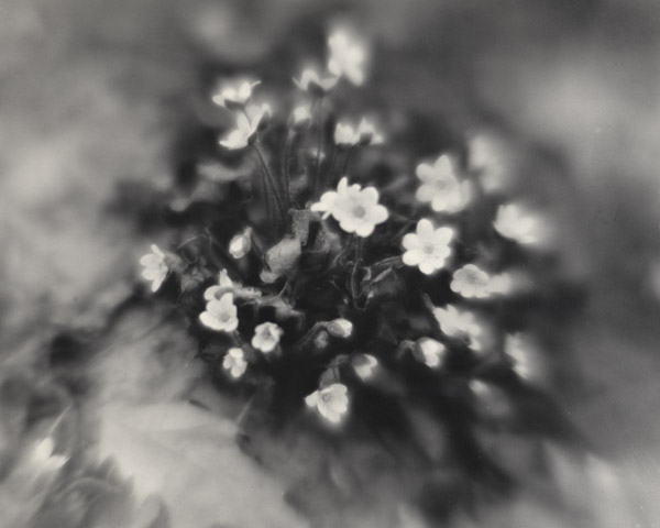

I sometimes play with single element home made lenses in large format and they get serious "glow" in areas of high contrast. In 35mm, I believe the LensBaby lenses are single element and show that feature now. I don't seem to have any decent images on my computer with the home made lenses but I've attached a test shot I did with my latest (not yet perfect) creation.
