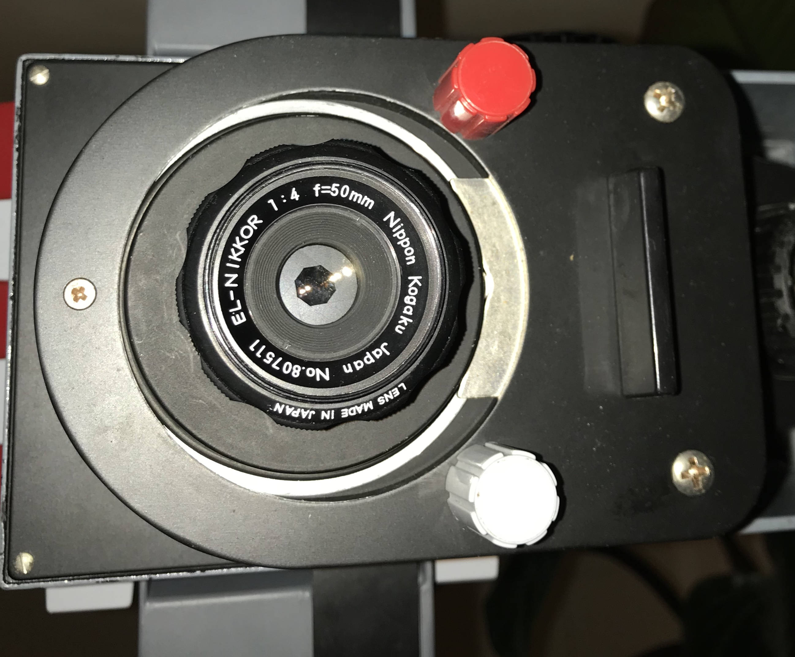

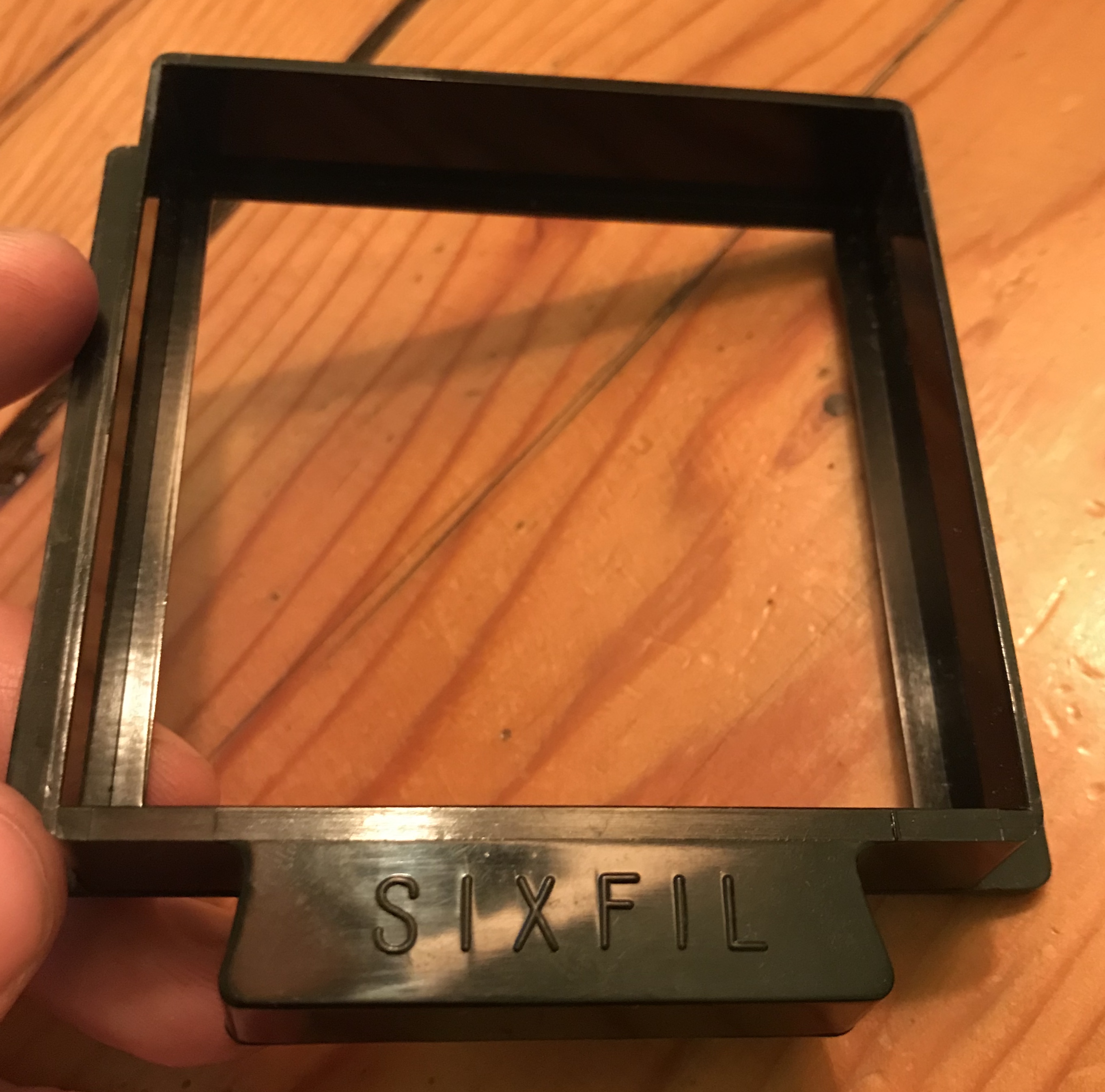

Hi, I will attach some photos so you can see what i have and what i ordered.

  • The SIXFIL is for above the lens variable contrast or color filters.
  • Last pix has the lens mounted on the wrong side of the lens board. Lens mounts on the beveled side of the board.
  • Both Componar 75mm lenses look like they may be the smaller 25mm mount lenses.
  • The Nikon 50 looks like it is mounted on a flat SIXPLA board, rather than the correct recessed SIXTUB board. You won't get it to properly focus on the flat board, other than close, cuz the lens can't get close enough to the film. Note that the Nikon 50 has a 39mm lens mount.
  • Hard to tell, but I "think" the first pix has the 75mm mounted in a recessed SIXTUB, which is for a 50mm lens.
