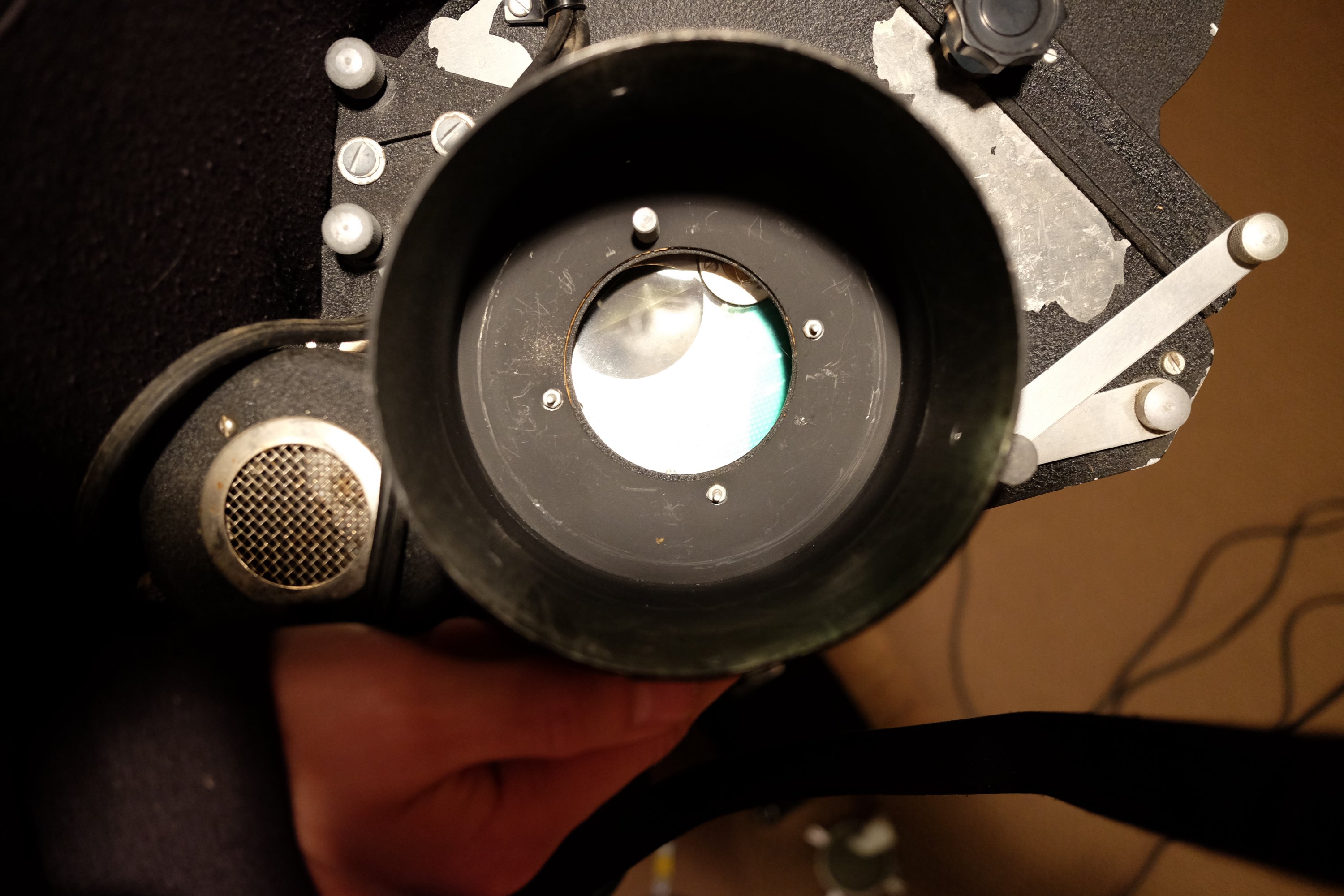

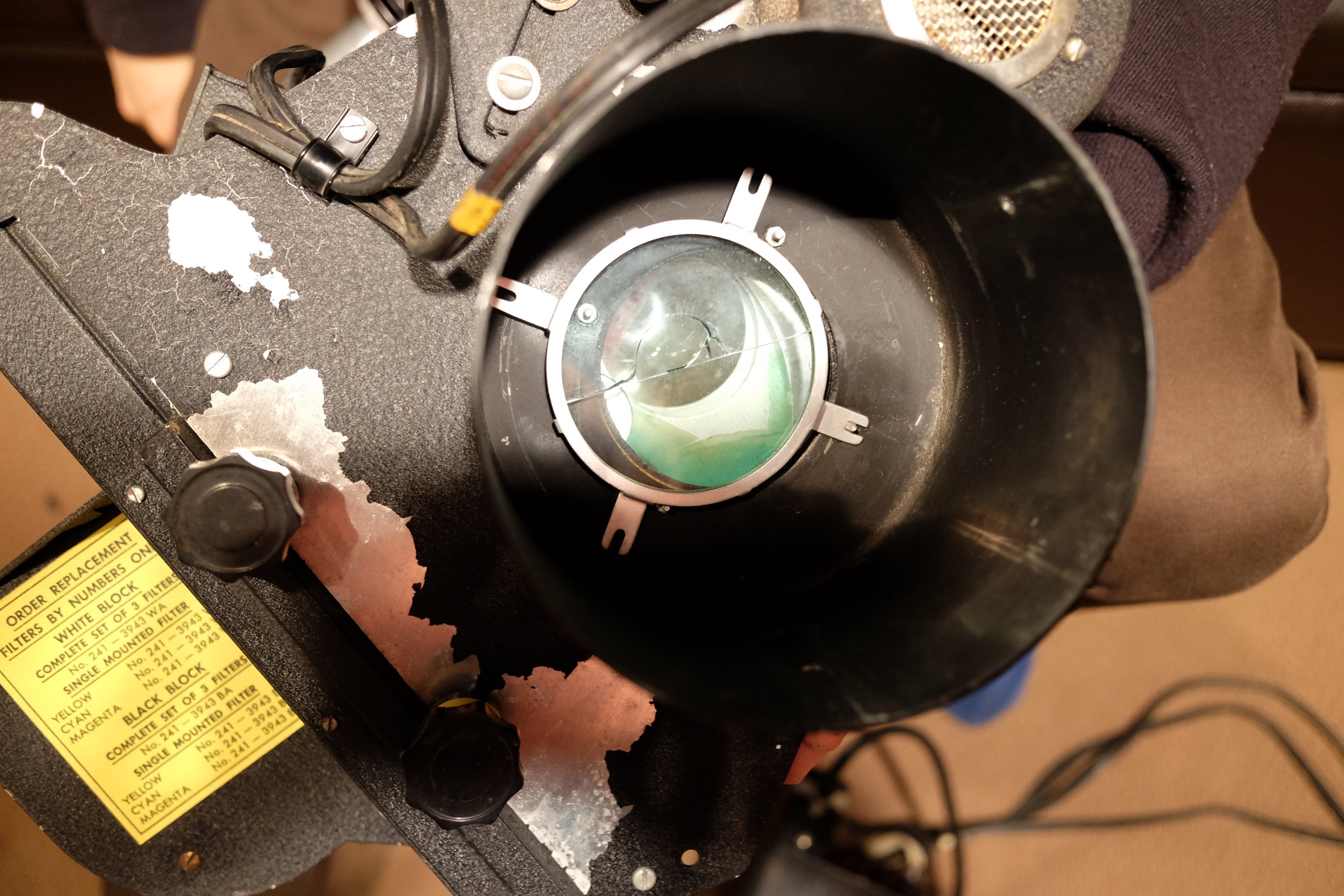

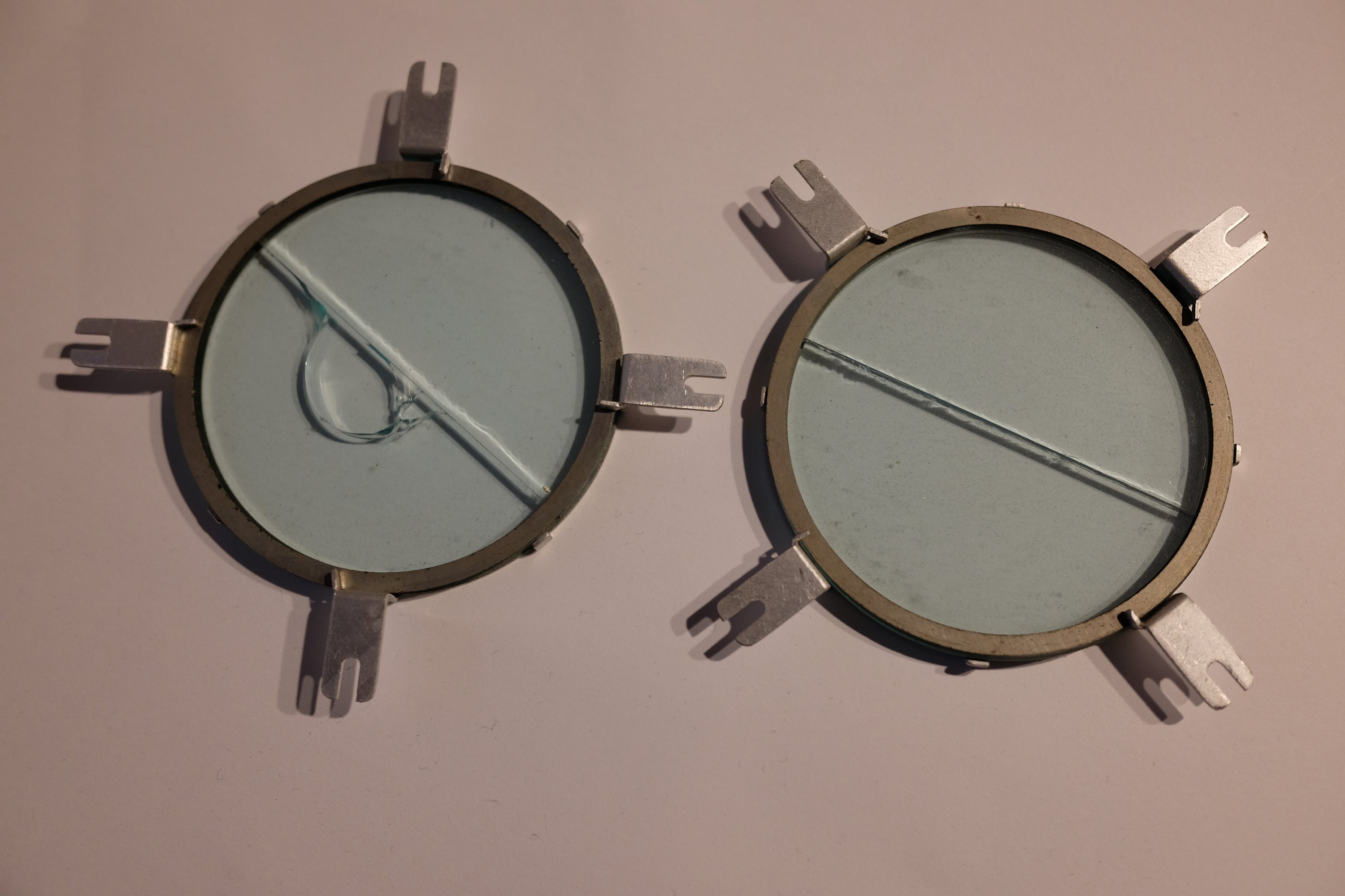

I recently picked up a Chromega D4 enlarger locally quite inexpensively. It was really quite dirty and had not been used for many years. It seems to work fine and now that I've cleaned it up it looks ok. The most obvious broken part I've discovered is a glass "filter" that goes in front of the coloured filters. It doesn't seem to be a lens or anything. They both seem to be made of two glass semi circles in a metal ring. These metal housing rings are too large to be attached to the bolts on the enlarger, it seems as though someone replaced them and could not find the right size. What are these glass discs for? Is it just for protection of the coloured filters?

i've never seen a D4 before, but my D3V has a glass disk
made of heat absorbing glass that goes between my light source and
negative stage, maybe this is the same sort of thing ?
i was able to get a replacement at my local glass-shop
good luck ! ( and all the best for the NEW year )

Looks like a heat absorbtion filter.
darkroommike
Mar 22, 2007
1,738
Iowa
The color gives it aways, heat absorbing glass. Not sure the item was a stick part or an add on. Though cracked they may still work.

A word of caution regarding heat-absorbing glass...
Never touch it with your are bare hands/fingers, not even briefly.
The oil on your hands transfers to the glass, causing a thermal discontinuity.
This will encourage the glass to fracture at that point when heated.
This is the same caution that applies to handling halogen lamps.
Always wear gloves.
But they seem not to be cracked primarily.
I know a lot of glass filters that are split to enable free expansion, though I never have seen such in a lighting path in an optical system.
ic-racer
Feb 25, 2007
16,719
USA
AgX is right. I'd keep using them. However, realize that color head does not have Dichroic filters. So, I'd be more interested in the condition of the color filters.
If I had that head, and I was to use it for B&W, I'd replace the Yellow filter with an Ilford #00 and replace the Magenta filter with an Ilford #5. The Cyan filter is not used in B&W printing.

Further to Sirius' suggestion, KHB has a lot of useful information that is specific to your enlarger here: http://www.khbphotografix.com/omega/Enlargers/D4.htm
I'm guessing that you have the earlier, non-dichroic filter colour head.
The Accessories list makes reference to three different versions of "Tri-sected Heat Absorbing Glass", which I would guess are what you are concerned about.
If yours is the original Chromega head, here is their take on it: http://www.khbphotografix.com/omega/Chromega/Chromega.htm

Thanks so much for all the replies! Yes, the head is the non-dichroic regular chromega. I notice that KHB recommends against using this head (or at least outlaying cash to acquire it). I consider it to have came free with the purchase of the rest of an enlarger (I paid $50 for the whole setup). It looks like a dichroic head could be had from ebay for several hundred dollars if this doesn't work out. It came with two sets of replacement filters and several bulbs. Do the filters fade in the dark, or just from use? It appears as if I won't be able to get the proper heat absorbing filters, so I guess I'll clean these ones off and reinstall them.
