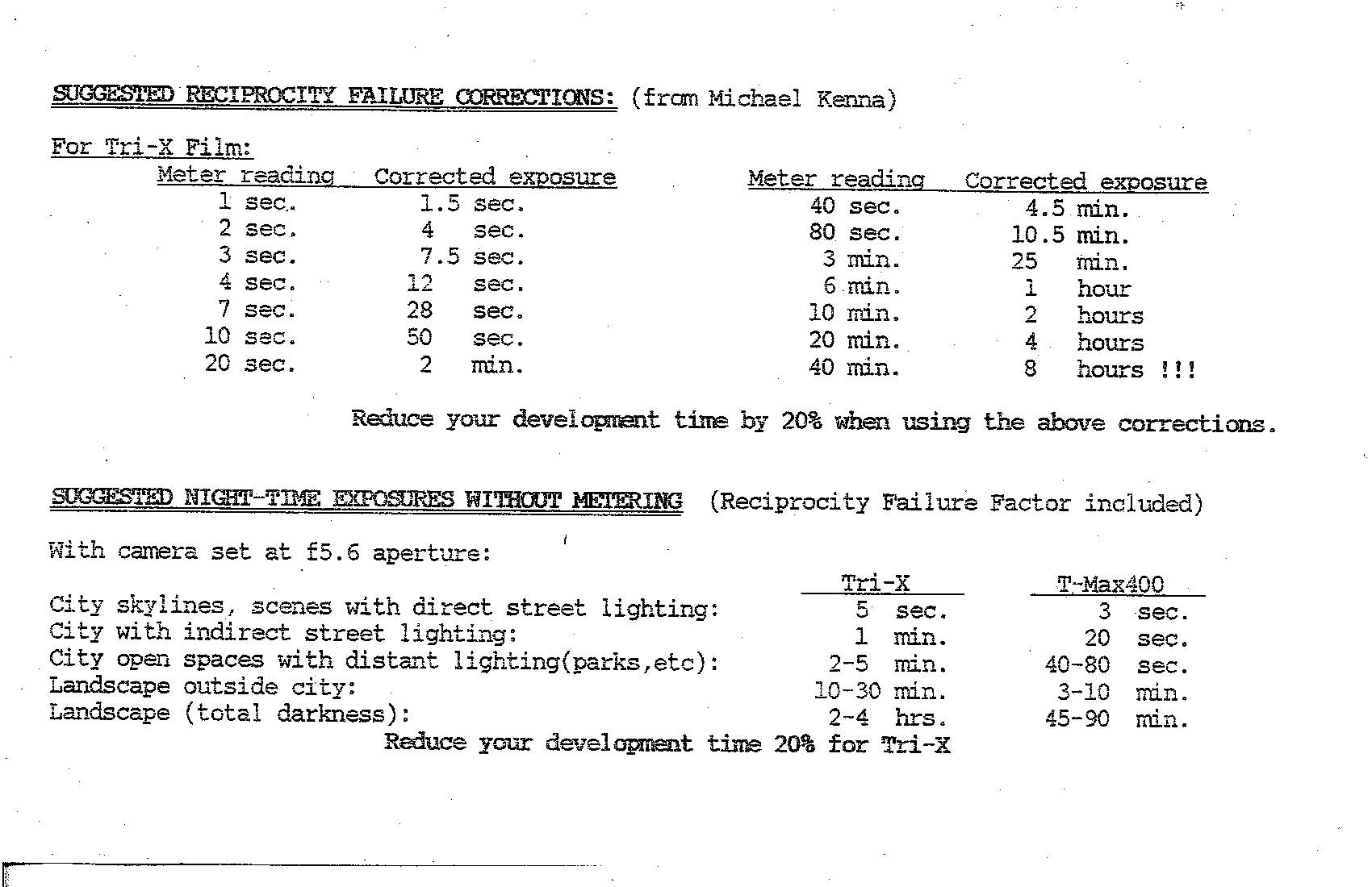

Michael Kenna seems to be able to handle low light. Here are his suggestions (from a workshop years and years ago!):
Please note that with the RF corrections made, one gives conventional film less development -- not more development (no development change for TMax).

Vaughn's crib notes from Michael Kenna are worth carrying around in your pocket. I do.
