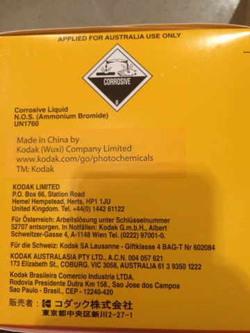

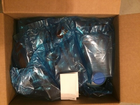

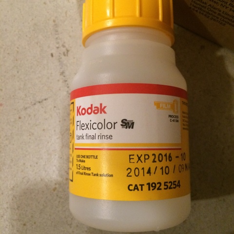

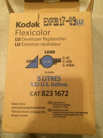

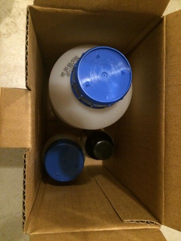

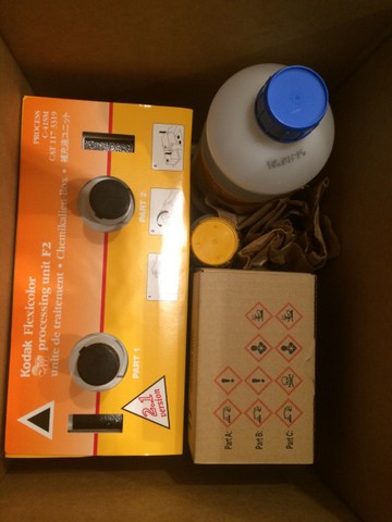

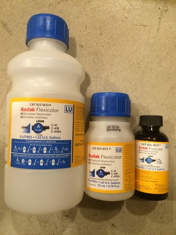

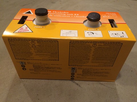

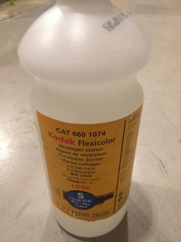

What I received in the mail:
bvy
Jul 22, 2009
3,285
Pittsburgh
Looks about right. Make sure nothing is leaking, discolored or egregiously out of date. I also had no trouble ordering the F2 package in spite of what some others have reported. Good luck!

Everything is in good shape, the F2 containers seem very well designed. The box is solid but this lids look weak. All the bottles seem to be made from HDPE (2) instead of PETE which everyone says is better for O2 resistance. The bleach and fix will be reused. I have a bunch of little bottles of hypo check fixing tester.

Final rinse should be discarded when it becomes discolored or "dirty."

Check out cis49-2009_12. It has instructions to mix smaller amounts than the 5L/20L total package volume.
Specific lines for your developer concentrate are in Table 2 - Line 2, Developer LU Replenisher LORR.
Then, look at Table 4 for amount of water and starter to add to concentrate for working (aka "tank") solution. Warning - some math is required :smile:
Now to find mixing instructions that are better than whats on the bottle. Will find the Kodak PDF
I thought PET was better than HDPE for oxygen resistance. It is most important for the developer part C, which doesn't look like an HDPE bottle, is it?
Actually part C is in dark brown PETE #1 plastic. Thats the only bottle made if that.
Wayne
Jul 8, 2005
3,620
USA
That's probably about the ONLY chemical shipped in PET. Virtually all liquid photochemicals come in #2.

I am hoping to mix and start developing this weekend or early next week. Once I have mixed my replenisher, do I add the starter to all of it or just to the portion I plan to use?
The instructions on the starter bottle show :
LORR
763ml Replenisher + 30ml starter + 207 ml water = 1L
non LORR
860ml developer + 18 ml starter + 122 ml water =1L
Which approach will prolong shelf life of the mixed replenisher? I am planning to use a 1L container 1 shot (I will test for reuse as well), and mix the liter every time I develop but I could mix it all at once. I will be using the bleach and fix many times as well as the stabilizer.
Also, do you just shake the crap out of the container to aerate the bleach during bleaching? Can the film be exposed to light at this point?
Edit, just found the schedule for the lorr replenisher and that seems easy enough as a way to save a lot of money instead of guessing at using the stuff twice. Page 4 below:
