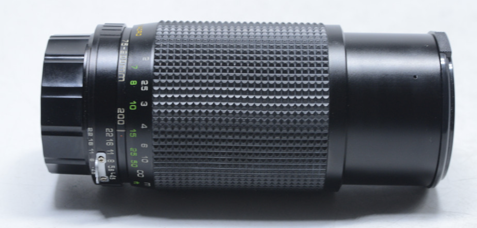

My chiropractor remembered me when his family was clearing out stuff that had belonged to his uncle (who had worked as a private investigator), and gave me a Quantaray 75-200 f/4.5-5.6 zoom. It's a Nikon mount and latches onto my Nikkormat FT2, but it lacks the "rabbit ears" that tell the camera what the aperture is set for while metering with a wide open aperture. The lens is 100% manual and has no electrical contacts on the mount.
I've heard/read that the "rabbit ears" can be added to (AI? AIS?) lenses made for several years after Nikon and compatibles quit putting them on new lenses, to make them compatible with the older cameras like the FT2; this requires drilling and tapping two small holes in the aperture ring, presumably at just the right place. I don't have the tools to do this job myself, and I'm not sure how good this lens is (i.e. is it worth paying someone to mount the linkage?). Any opinions? Obviously, I could use it in stop-down metering mode, but one of the things I like most about my FT2 is not having to remember to hit the "preview" to meter (I'm a long time M42 user, and the preview button has been part of my 35 mm life).

To me, it's definitely not worth it. Opinions will vary but to me the lens is, at best, ..."kinda, meh" (the lens caps are probably worth more than the lens) but you can discover that for yourself. Mount it on your Nikkormat and make photos (you could use a hand-held meter). For what it would cost you to have someone mount rabbit ears on this, you could buy a much better Nikkor lens - even a zoom if that's what you want.

Quantaray 75-200 f/4.5-5.6 zoom was made by Sigma and was bottom level kit lens. Finding a donor lens with no Ai clip or rabbit ears would likely cost more than just buying a different lens.

Unless you already have a similar lens, and have a use for this one (given the variable aperture, I assume it is pretty compact and light), it's pretty easy to convert it to AI functioning. You mainly just have to glue a tab in the right spot. I've done a similar modification with Rokkor MC lenses to make them MD lenses. No problem at all. Who knows? You might like the lens.

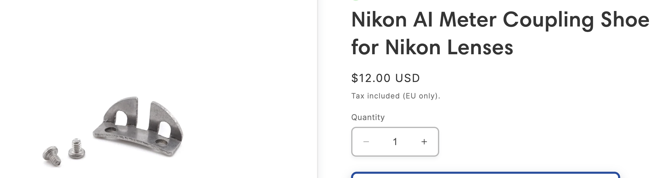

The rabbit ears are only a few bucks and would be easy to install on an inexpensive lens like you have. Line up the slot with the "5.6"
It is an inexpensive lens; glue it on (as mentioned above) if you don't have access to drill and tap.
