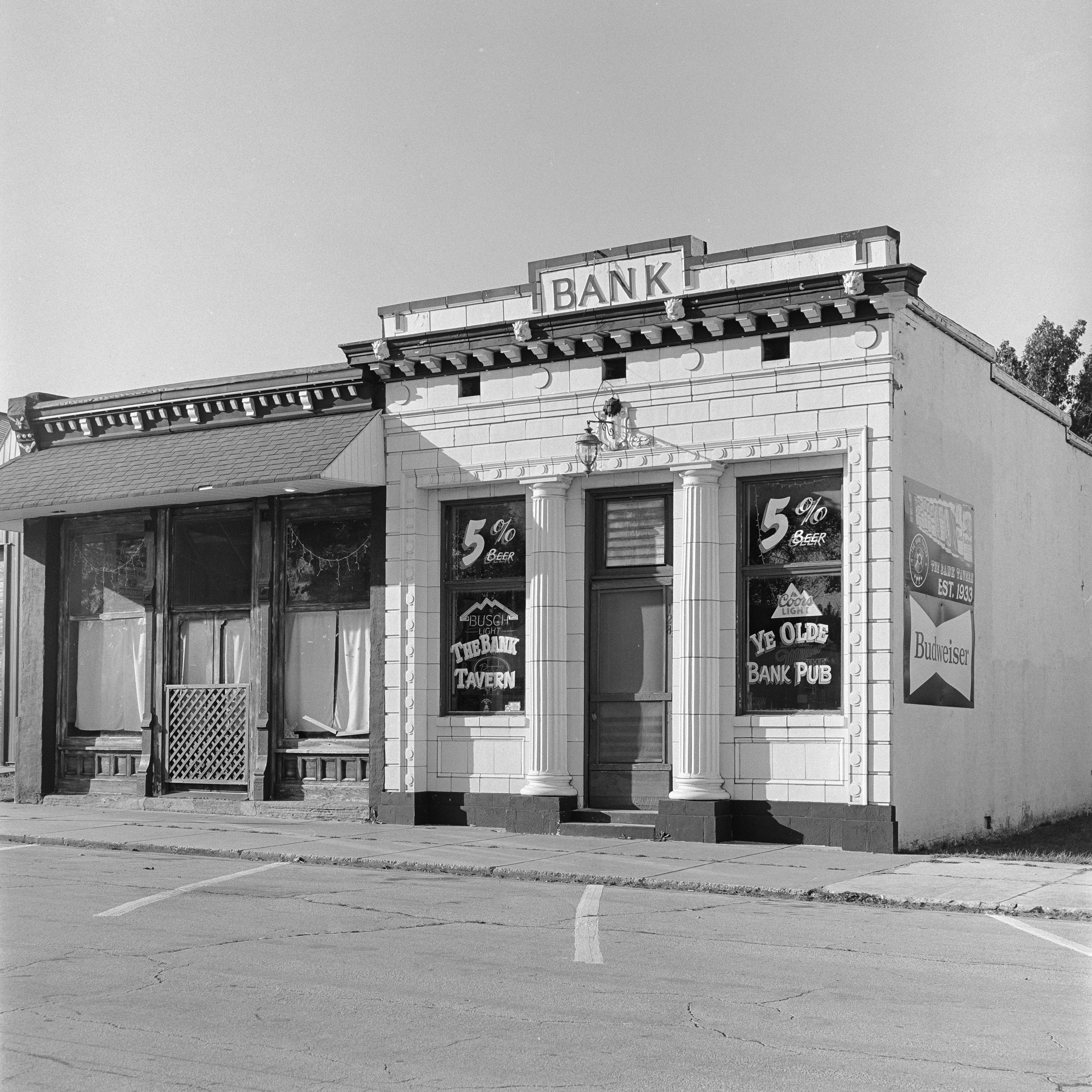

Thanks. That looks good. If I understand correctly, the negative is 120 Kentmere 400, and the negative was made with a CZJ Sonnar 180mm f/2.8 lens @ f/5.6. And then you copied the negative with a Pentax SMC D FA 50mm f/2.8 macro lens, using 6 overlapping shots, right? But on what digital camera?

Yes. Pentax K-1 with pixel shift enabled.

I have, but I don't have that exact shot uploaded. Closest one is this:
My conclusion is I don't usually need that much stitched detail, and the limitations of the camera's lens and pressure plate start to show in the 6-stitched shot. 2-stitched shots work better for me on 6x6. Might do 3 or 4 stitched ones on a 6x9 if I had a sharp camera in that format like a Fuji GW690, alas mine is dead.
Two stitched shots is what I do for 6x6cm, but with fewer pixels from my 16MP APS-C sensor. My resulting digitized images are about 4600-4700 pixels square, which is adequate for my purposes.
This one is TriX shot using a Mamiya C220 Professional and 80mm f/2.8 lens. For digitizing, I use a 75mm f/4.0 Rodenstock APO-Rodagon D process lens attached to my Fuji XT-1 camera using bellows.
Looks great to me.
