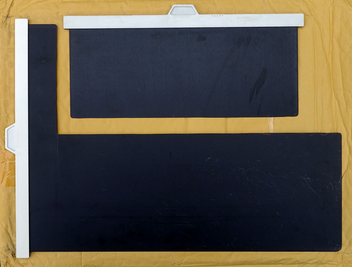

I am getting ready for a month at Zion National Park. To add a little flexibility to my image-making, I modified two 11x14 metal darkslides I had laying around. One gives me two 5x14 images on a single sheet of 11x14, the other will give me an 11x11 image on 11x14...I have a box of 11x14 film that is fogged at one end.

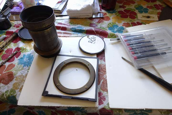

I decided to bring the Suter Aplanat B No. 6 (~500mm), so I re-mounted it in a homemade Sinar-type board. The board is made of a piece of 8-ply rag matboard drymounted to a 4-ply piece of solid black matboard. The woodscrews holds the lens nicely. Will easily hold for the month! My main 11x14 lens is a Fuji W 360mm in shutter and in addition I have a RD Artar 24" (610mm) in a barrel.

How did you make such nice cuts in the darkslides?
I used a 6" coping saw and Stanley coping saw blades (20 TPI -- finer would have been nice). I scribed the line on the black darkslide -- the silver line was easy to follow. I cut on or biased slightly off the line. After cutting with the saw, I used a file and slowly took the rest of the metal off to the edge of the line. The original cut edge with the saw was not very straight!
I rounded all the corners with the file and used a Sharpie to blacked all the cut edges. I like the metal slides as I have broken the others out in the field and in my pack. These I can pound flat if needed!

I'm curious as to the modified slide for the 11x11 - Sounds like you're leaving the fogged sheets intact, and shooting with the back off centre, so I'm not sure I'm seeing any advantage to a change in the dark slide. Does it just leave you with a reference line for ease of handling the full sized negatives during your post work?

I contact print and include the film rebate as part of the image. So the modified darkslides provide a rebate on the 11x11 and the 5x14 negatives.
Using the front rise/fall (or front shift for vertical 5x14s) I can center the lens on the section of the film that I will expose. I can take advantage of lenses that may not cover a full sheet of 11x14.
