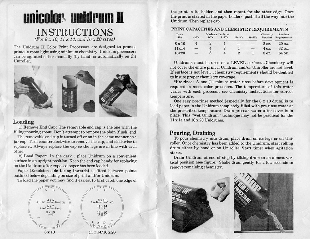

The attached shows how multiple prints can be done in a Unicolor Unidrum that has inside notches.
I have a Unidrum but haven't used it as gasket leaks are common and a pain; however, there are APUG threads discussing how to remedy that.

That works fine -- where it gets tricky is trying to process multiple prints without the spacers. I fashioned some makeshift spacers from nylon ties. This works okay with prints, but as I also process 4x5 sheet film in an 8x10 drum, I need something a little more reliable. The original Unicolor spacers seem impossible to find. (For those unfamiliar, the spacers allow you to put two or more sheets of paper or film along the same channel in the drum without the risk of them overlapping during processing.)
