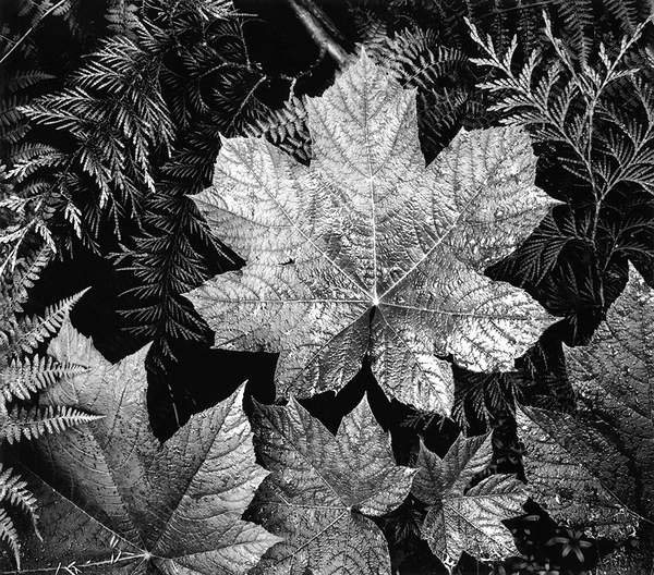

I'm wondering how its possible to get foliage to have that silvery, glowing look associated with images such as A. Adam's "Close up of leaves in glacier" (linked) or "Aspens Northern New Mexico". I'm not talking about the wood effect with IR film, that's a separate beast. I'm still parsing out how to manipulate exposure to effect images, and have been really disapointed with the flatness of foliage in my images so far. My best theory so far is underexposing the scene so that the leaves take up more in the mid-tone range, but i haven't been able to replicate this very closely. Or was this something that was done during printing? I'm not sure if it's relevant but I've been using Tmax 100 and older PXP in medium format.

Adams talked about how he made that photo in one of his books. I think he used a green filter and increased contrast by using a longer than normal developing time. I'd look it up, but most of my books are packed up in boxes now and i have more than 3000 books to look through!

Yes, I've managed to get a similar effect (accidentally!) through a combination of green filter and extra development. Of course assuming good light and leaves that are a cooperative color.

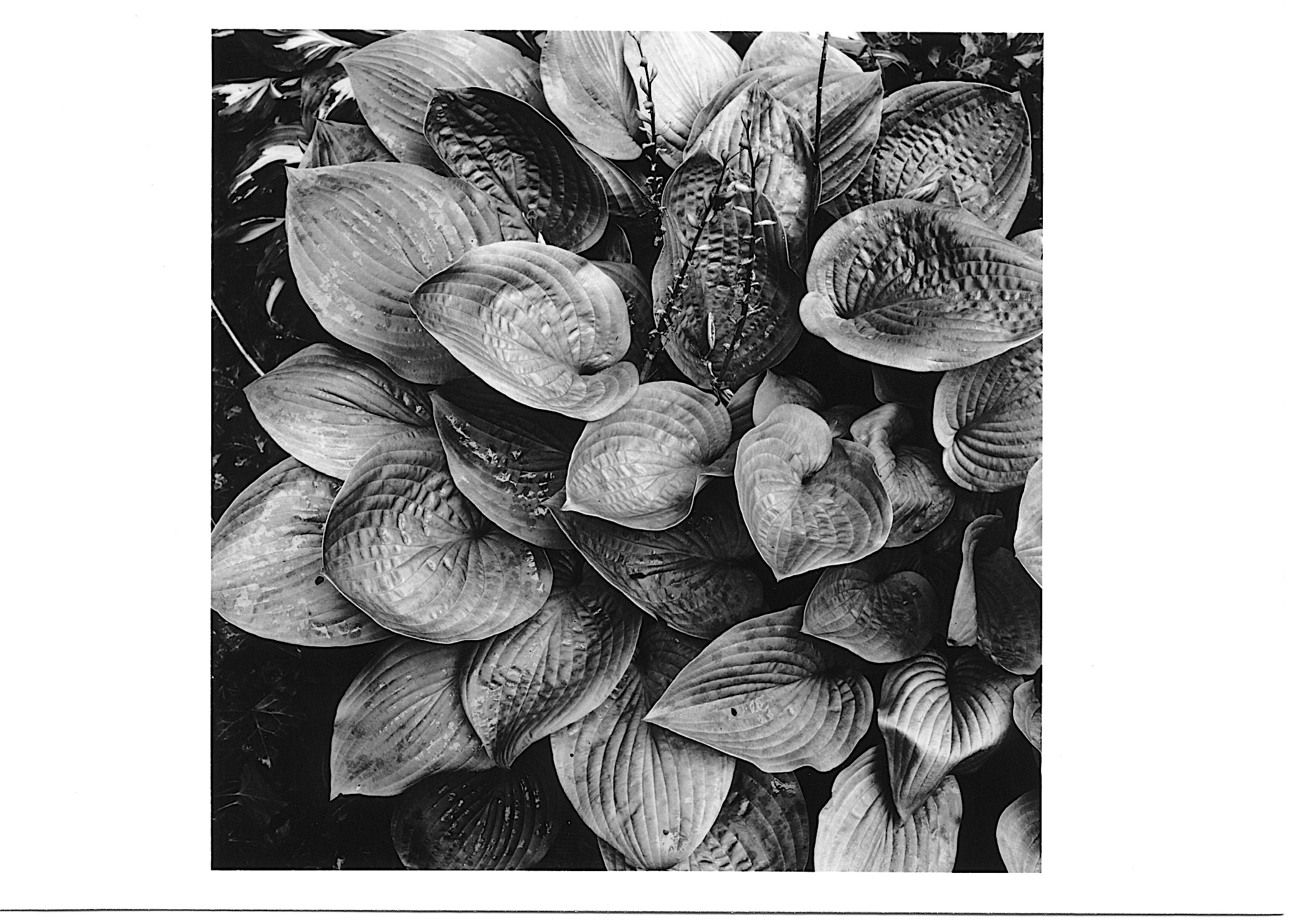

Light and exposure plus shiny leaves.
This is shot almost straight down, and illuminated by a cloudy sky above.
The direction and quality of the light is critical.

Use a green filter and take a spot reading of the green leaf. Use that reading and put it in Zone 5, then correct for the filter.

Matt, so what I’m gathering from that is the foliage must be well lit, ie on the edge of a clearing rather than deep underbrush? Just to clarify
In this case, it was in the midst of a forested area, but there was enough open space directly above to supply diffused but directional light.
This shot was essentially from the same location, just on the other side of the walkway, and turned the other way.
You can get another sense of the light by looking at the large leaves ("skunk cabbage") in the corner.
The subject is a regular poster here

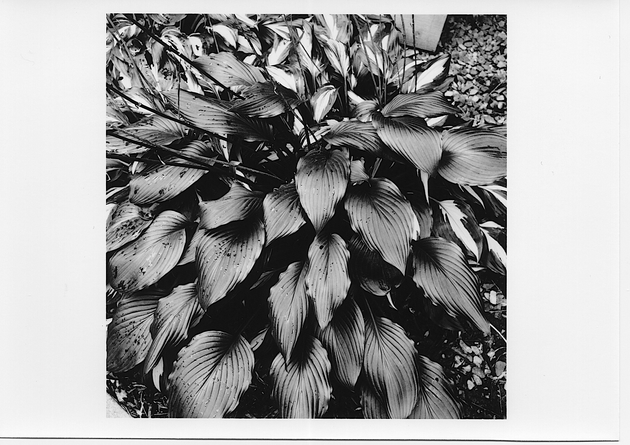

ic-racer
Feb 25, 2007
16,802
USA
I like this version better and get similar results printing with a lot of contrast. The 2 following prints show this.
