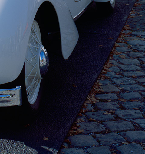

Crop 1:
Crop 2:

If you look at 800% or so, you will probably discover that the magenta is actually a mixture of reddish and sometimes a bit of green pixels, mixed with the proper dark color pixels. Since you are scanning slide, the darkest parts will be very dense, and thus cause electronic "noise" pixels, which in my experience, generally turn up as these reddisch pixels...
Not much you can do about it, except getting a less "noisy" scanner with higher true DMax (which will be difficult as well at reasonable cost, you are quickly ending up in the Imacon / Drumscanning range).
By the way, the overall scan looks a bit to bleuish or cool in my eyes on my (calibrated) monitor, but lets wait what others with better monitors have to say.

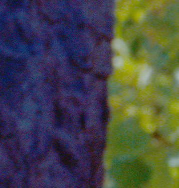

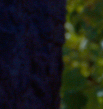

I did not come to think of that. Just to see what comes out, bellow is 100% crop from 2400 dpi scan. Yes, the scan is slightly blue, however such a cast would be easy to remove. I did not adjust the scan before posting.
I understood that it should be possible with this scanner to make a scan with higher exposure (and blowing out the highlights). Doing such a thing could yield better shadow quality. I could merge two scans later. Now I need how to figure out how to do that. I guess just a simple multi scan would not solve much here.
However - I have seen some scans from Guy Tal with this scanner and he did not seem to have these issues ...
Unadjusted:
The same crop with levels pushed to 2.0 to see the noise in the scan:
Seems like your theory is correct.

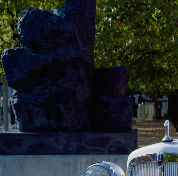

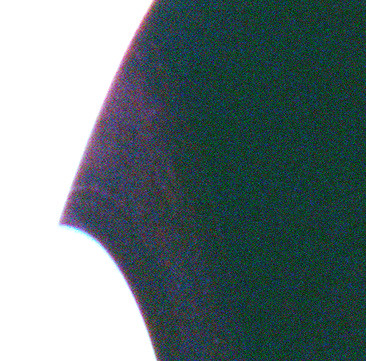

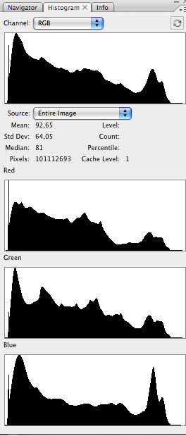

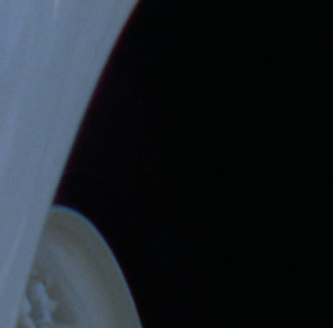

From the images (see below) it seems the what has been proposed is correct. The fully black area (first crop) the black is black, but the tire that is just on the edge of fully black (better seen in the adjusted crop) has a magenta cast. Closer look to histogram reveal sharp peaks in low values (around 6 - 8) mostly for red and some for blue, but very little for green.
One can get some reasonable cure using the color sampling tool for shadows in the Levels window, but it takes a lot of clicking to get the right one. Of course I would like to preserve as much of the shadow detail as possible.
I would like to take a scan with different brightness of the bulb - but I do not seem to be able to find this - it should be in the SilverFast in the Options->Special but it is just not there ... I hope to have an answer from SilverFast soon.
unadjusted crop - 100% @ 2400 spi:
The same crop with strongly pushed levels:
Leves of the whole image before any adjustments - you can see the peaks:

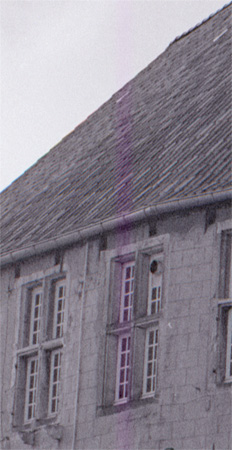

One more issue: - the scans have around 30 pixels wide (with 2400 dpi scan resolution) a light green strip. Always the same place and always the same color. I get with both SilverFast and with ScanWizard, so I exclude a software problem for now.
The strip is inly in the green channel - the red and blue seem to be fine ...
It can be hard to spot in a color scan, but in the BW it can be very obvious (see bellow).
To try to solve the problem I unmounted the top lid and the glass bed - to be able to access the interior of the scanner - and with a photo-brush wiped the part I though could have something to do with scanning. I also (holding the scanner on the side) used a canned air to blow the interior of the scanner a bit. But no change ...
I am contacting Microtek - hope for some reasonable answer. I have still a few days left on my return warranty ... :surprised:
The strip looks like this (Bw scanned as color positive and inverted):
pellicle
May 25, 2006
1,175
Finland
that's definately an obstruction. It could be on the scan head (or optic) or it could be on the 'calibration area' (assuming that the Microtek has that)
it its warranty I would most definately send that back

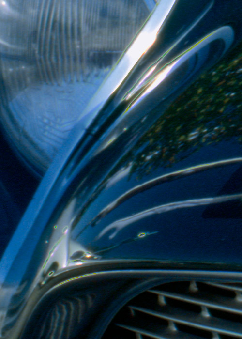

Still - just before I have sent the scanner out I was scanning a 4x5 slide (E100G) and when using the ME (Multi Exposure) mode (which does help to cool down the shadows) I realized that there is a problem in there:
If I do not use the ME feature (Just making a "normal" single pass scan) I get:

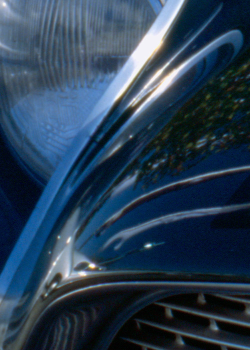

But turning the ME feature on makes strange artifacts around high contrast places:
Both above are 100% crops from a 2400 dpi scan:
I contacted SilverFast and will continue on this issue once the scanner is back. They do recognize this as a problem, which is good, but need more input which I can not provide right now.
As I wanted to make a print, I used the single pass scan, you can see the final (adjusted) picture HERE. I printed the image to 50x70cm and looks very nice (with some shadow noise I hope to improve)
OldBikerPete
Aug 29, 2005
386
Melbourne, A
I think you will find that those artifacts are caused by the software clipping at the lowest density parts of the transparency and then alternativley clipping or not clipping on the multiple passes. If you look at the histograms and the place at which the software has chosen to set the white point. I expect that you will find that the software has chosen a white point which will cause some small proportion of your highlights to be 'whiter than white' and the software has internally 'rolled over' to black - sometimes - at those places.
If I have not made this clear, please say so and I will try to elucidate further.
