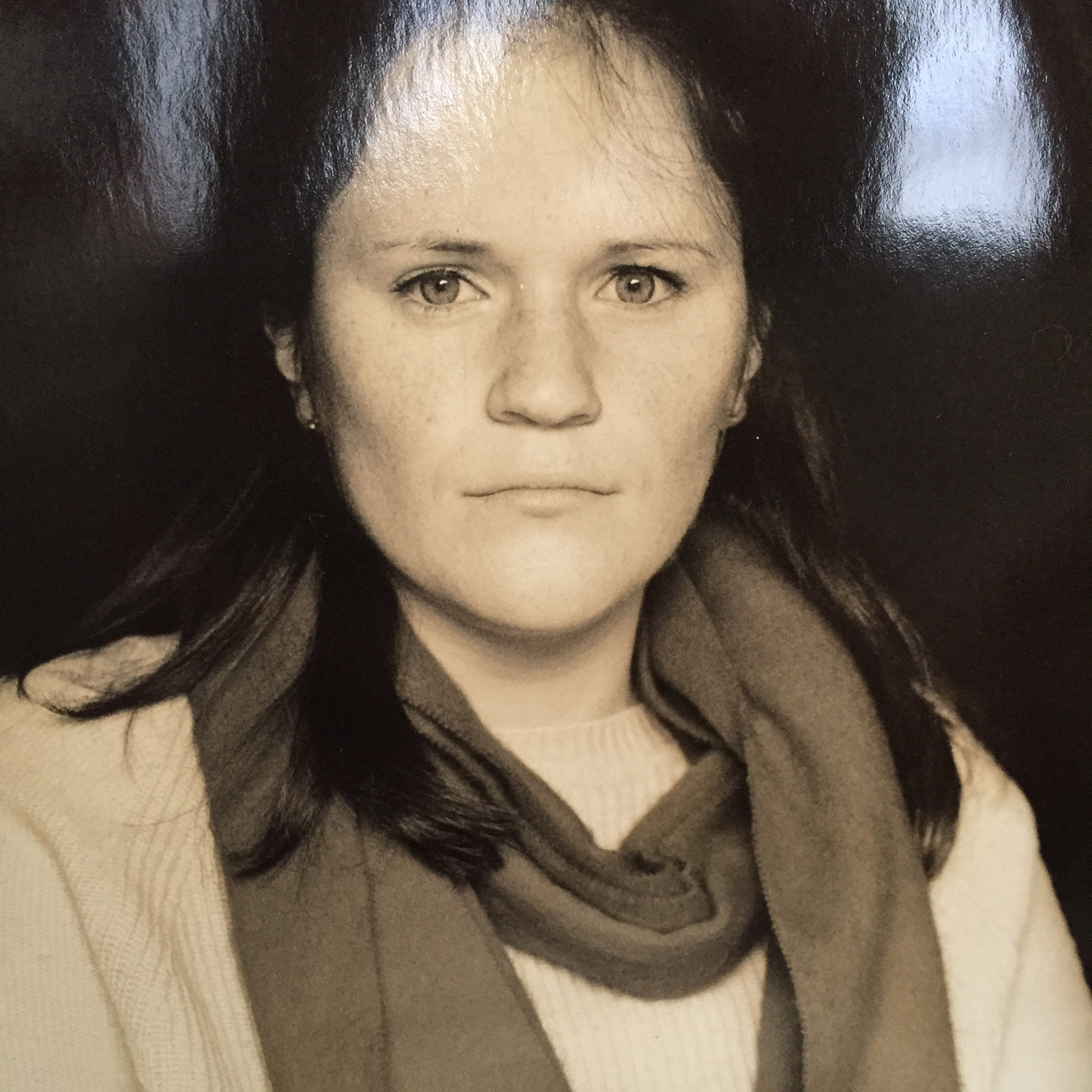

Hi all,
Thanks for the help I received on toning in my other most recent thread.
I'm wondering if anyone knows any tricks for extracting more shadow detail out of delta 3200, which has eluded me.
I'm not sure if asking for "more shadow detail" is the same as asking "how do I straighten the toe of 3200"? It may be.
An example: 120. Delta 3200. Window light in an almost black room. Shot at an ISO of 800 and then added an additional two stops for N-2 development. PMK. I think my adjusted time was 12.5 minutes @ 75 F.
attachment.php
Paper: MG FB IV. Main exposure @ grade 2, 50% @ grade 5.
As you can see, the highlights and above zone V look good. But the shadows and lower midtowns just drop straight off to DMAX.
I'm fairly sure it isn't the paper or printing procedures, because examination of the negative under a loupe doesn't show much detail in the shadows, either.
Not sure if Delta 3200 is the right film for shadow detail–honestly, I don't know, but, I really find fast speeds essential to my work. I know it's true speed is closer to 800 than 3200 (same say 1600), and I'm shooting N-2 for an EI of 200. So, I suppose I could shoot tri-x at rated speed if it provides vastly superior shadow detail, but if I ended up finding I need contracted development as I often do, and shoot N-2, then I'm at EI 100. Plus I like the grain structure, so I want to stick with it.
Thanks for any tips!
-S

Looks like you have taken a beautiful photograph and made a beautiful print. Love the toning and I personally wouldn't change a thing.
You should expect the black background in this setting to be completely clear and without detail. It probably meters several stops lower than your subject.
You could theoretically get detail in the shadow by metering the room and "placing" it on Zone II. But I don't think that would be a good way to handle this portrait.
If anything you might add light. But to my eyes... save that trick for an occasion where it's your idea to add light.
This print looks great as-is.
Thank you for the compliments Bill! This is an iPhone snap of the curled print no less.
However although it doesn't look bad or off or as if there's been some mistake—many people like this look, and so do I—but I can't help wondering where the shadow detail is, not just in the background.
If you look at the lock of the subject's hair (which is dark brown), part of it actually falls on the same plane as her face, so it is getting the same exposure, which is light from a large window @ ei-200 (true speed of Delta 3200 = 800 - 2 stops, then developed at N-2), and yet even with N-2 development there is no visible "information" in the center of that lock of hair in the negative.

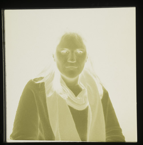

Here is a quick DSLR snap of the negative on a light table. A recap: exposed at ISO 200, then developed in PMK @ 75F for 12.5 minutes, which should be roughly N-2 development if the true speed of D3200 is 800-1000.
attachment.php

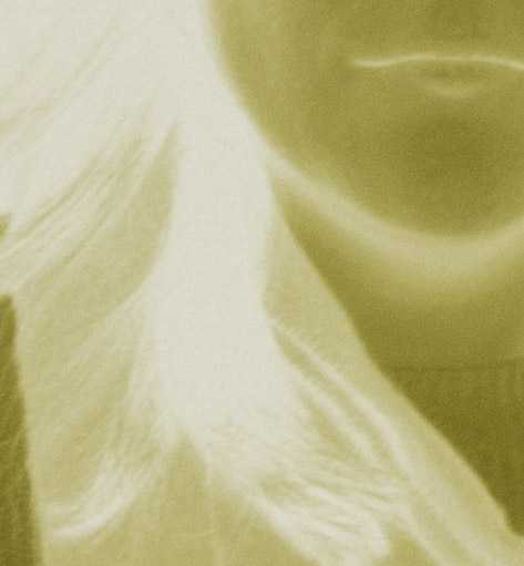

A close up on the area of the lock of hair I was taking about, which received the same amount of light as did the face, because it is on the same plane of focus. You can see clearly that no detail is present at all. Just ain't nothin there.
attachment.php
Although I am grateful for the compliments, recording information in the shadows is important to me, and I would at least like to see how a negative with detail there would print. Maybe I discover I don't like it.
What's interesting is that the base exposure for this negative was grade 2, so, even though it isn't extremely dense, it does have relatively high contrast already.
I think there are a few routes to pursue:
1. Keep exposure at EI 200 and develop the negative a few more minutes, with the goal of coaxing out whatever latent image may be present in the shadows, although the highlights will increase in density as well, and if memory serves me disproportionately so, so that the resulting negative will have even more contrast than this one. My concern is that the highlight density will be too much to print, and the paper will not have enough dynamic range to contain both the highlights and the shadows.
2. Keep exposure at eI 200 and develop for 12.5 minutes, then do a semi-semi-stand soup with no agitation for 5-10 minutes, which might develop the shadows more while highlight density growth slows or stops. I worry though that PMK developer oxidizes too rapidly for a 20 minute procedure like this.
3. Give the negative even MORE light at exposure, maybe EI 100 or even 50, and develop as I already have, or contracted N-3 or something. Shooting D3200 @ an EI of 50 sounds ludicrous though, as part of why I'm using D3200 is so that I can shoot available light.
4. Use a 400 speed film at 200 or 100 (someone suggested delta 400) and develop normally or N-1 or -2—though I think I would lose the grain structure of 3200 which would be a shame. In 120 it is just noticeable upon inspection, which I find very pleasing.
5. Shoot D3200 at 1600 or 3200 and develop normally. This one seems the most dubious because as stated 3200 is not D3200's native speed, rather what Ilford claims it can be pushed to for "acceptable results." And my definition of "acceptable" often differs from others. I can't see how pushing to 1600 or 3200 would increase shadow detail.
