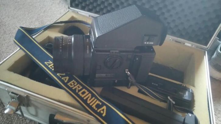

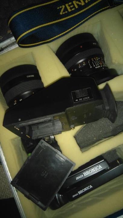

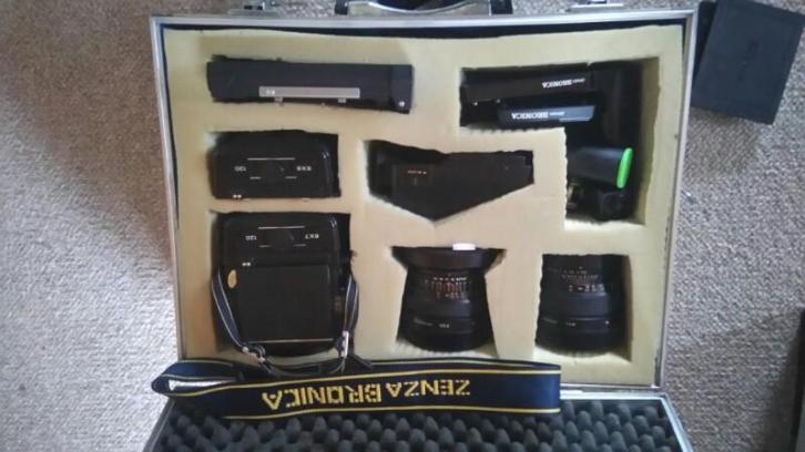

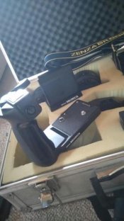

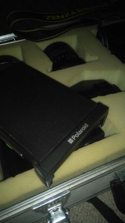

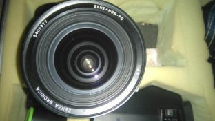

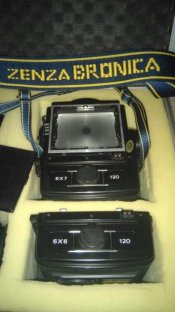

I agreed to buy a Bronica GS-1 camera and will go over this week to check & buy the camera. It comes with:
- GS-1 Body
- film back 6x7
- film back 6x6
- standard lens 100mm
- wide angle lens 50mm
- prism finder
- normal finder
- polaroid back
- speed grip
- aluminum case
(see below for photos from seller)
My question is: can you give me some tips what to check and what to look for to see if the camera is in good working order? I never handled one of these, but I'm familiar with the smaller (non-electric) Bronica SQ-B. Maybe the GS-1 has a special trick to get the shutter to fire (like a Mamiya RB67 does)? Or are there other quirks?
I'll try to get a fresh battery and will bring some film too.
Thanks,
Bert from Holland
PS: I'm only buying this camera because I like the format, I like Bronica and I like GAS :wink:
I know I don't need it, but what the heck - life is too short not to enjoy this monster too and the price is right: Euro 435 for the set. And did I mention the 50 mm lens?
Bronica-GS1-001.jpg Bronica-GS1-002.jpg Bronica-GS1-003.jpg Bronica-GS1-004.jpg Bronica-GS1-005.jpg Bronica-GS1-006.jpg Bronica-GS1-007.jpg Bronica-GS1-008.jpg Bronica-GS1-009.jpg Bronica-GS1-010.jpg Bronica-GS1-011.jpg

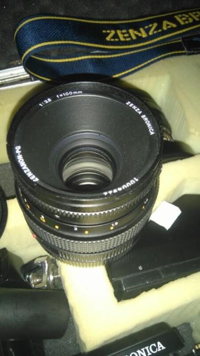

I went over today to check out the camera. I had a nice time meeting with this photographer. We have the same interests, like salt and carbon printing. The camera and all extras are like new with all the original boxes. The body functions flawlessly and was stored without the battery. The 50 mm lens is beautiful and its shutter perfect. The 100 mm lens also looks like new, but the shutter isn't working properly. It fires, but the blades are opening too slow. Probably something a simple CLA can fix. It comes with a 6x7 and a 6x6 film back too, both tested with an old roll film and working properly. And the grip fits perfectly in my hand. Comes with metered prism finder and waist level finder.
So I bought the set from the original owner (since 1988), who's gonna sail around the world. I was also given (for free) a 40" roll of Ilford MGIV photo paper, a large roll of halftone film (for making alt photo negs), two rolls with transfer film for heliography and a new roll of tissue paper for carbon printing.
I'm a happy camper!! Even without the 100 mm lens this was a good deal, since I was looking for the 50 mm lens in the first place. I already shot a roll of film and it handles beautifully. The camera is even light for its size (compared to a RB67 or Pentax 6x7). This camera has found a good home and is rapidly becoming my new best friend.
Only problem is I want to get me a protective filter for the 50 mm lens, but is an whopping 95 mm filter size.
