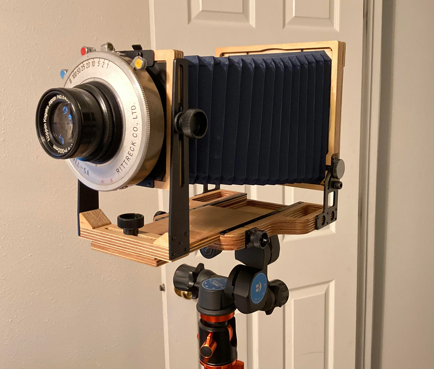

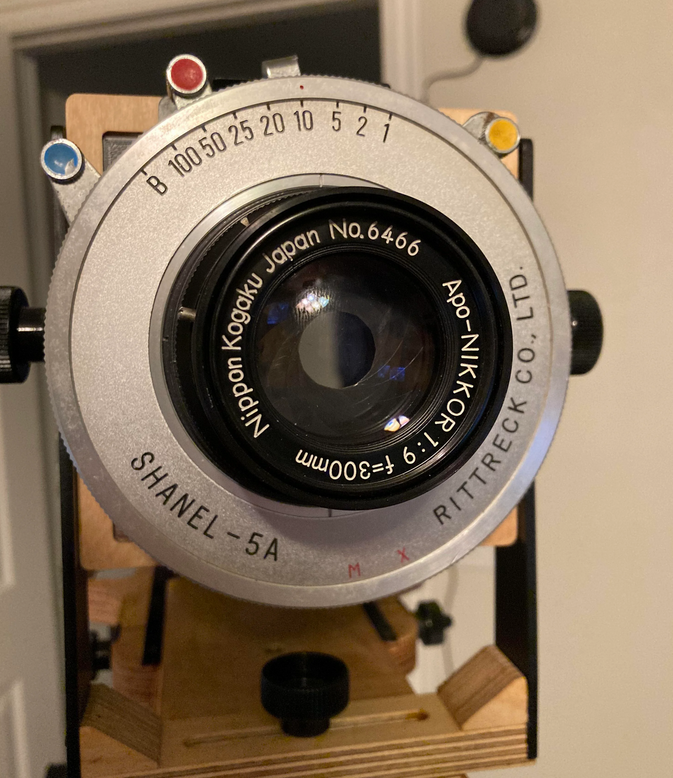

My Shanel 5A arrived yesterday in great condition. The rear threads are M63.7x1, so I printed a custom lens board that essentially has a built-in retention ring with those threads, and a bit of a standoff so the shutter can clear the front standard of my camera. The shutter is almost comically enormous, I didn't properly grasp the size of it from seeing pictures.
The lens itself is a little more mysterious. It's listed as "threaded for Compur #2" with a 52mm thread diameter and no thread pitch specified. SK Grimes' site says that Compur #2 is somewhat less standardized than other Compur designations. I ended up just measuring the thread pitch and diameter myself and ended up with about M52.5x0.75. So I'll need to print one more ring that has that spec for internal threads, and about M64x1 or thereabouts threaded on the outside so it will go into the front of the shutter. After that I should be off to the races. Thanks all for your help!

Here's the final result. Everything is a snug fit and attached strongly enough that I'm totally confident using it in the field, despite plastic threads. It all works as intended, it just looks absolutely ridiculous :D
