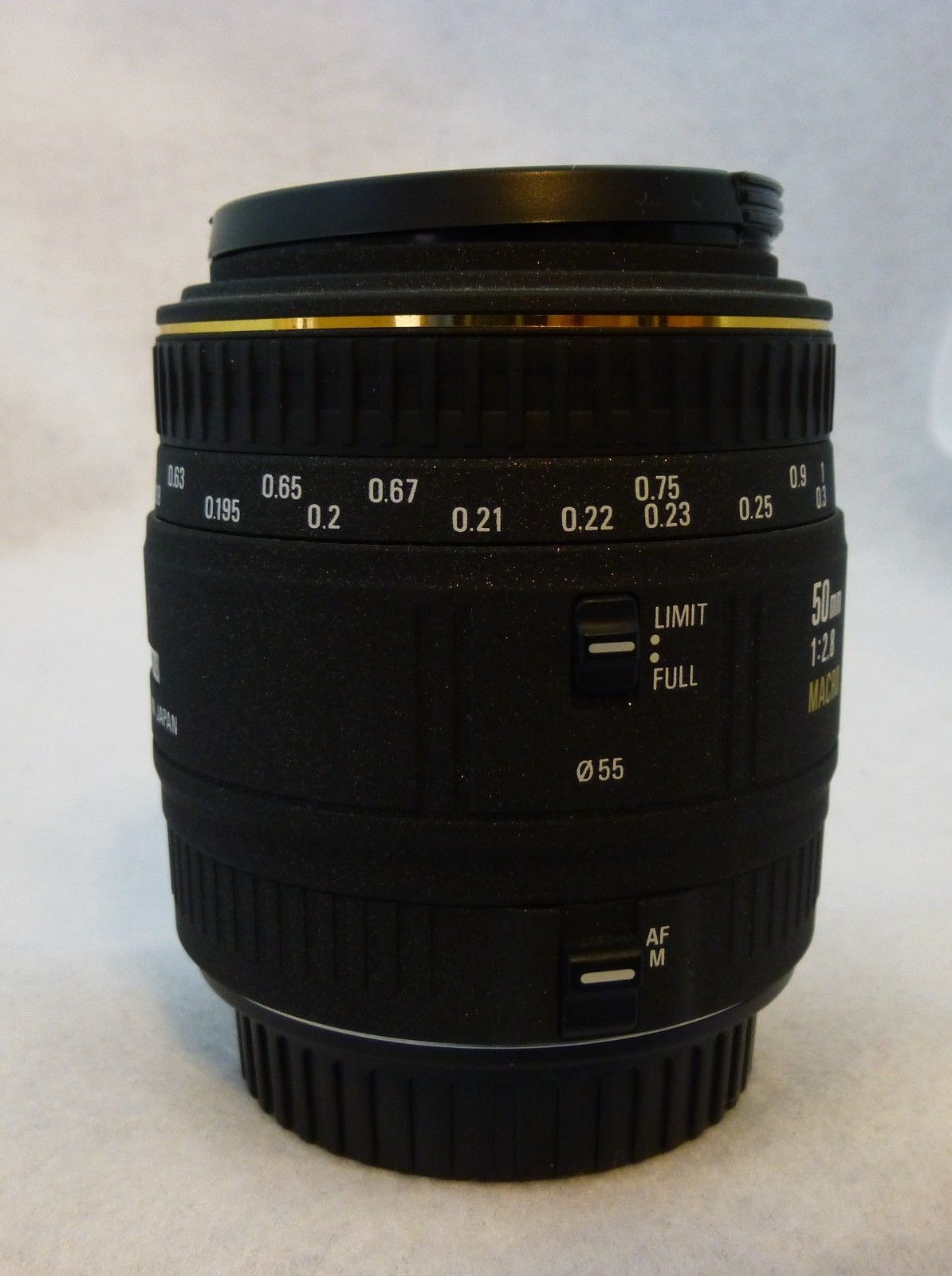

Hi Rick
Could you post a pic of your lens, please?
One with a digi-somethingy would do. Please, do one of the mount.
That would be nice and will clear for what camera would it be.
If it is Canon, then is for EOS cameras. No FD mount camera had a AF/MF switch on the lens.
Whoever sold you the lens knew a thing or 2, just not all the picture.
Some Sigmas will not work with later EOS bodies like the 3.
I know that because I had to havea Sigma EX 70-200mm re-shiped for the 3.
Early EOS bodies should work fine.
Recommend an EOS 600/630.

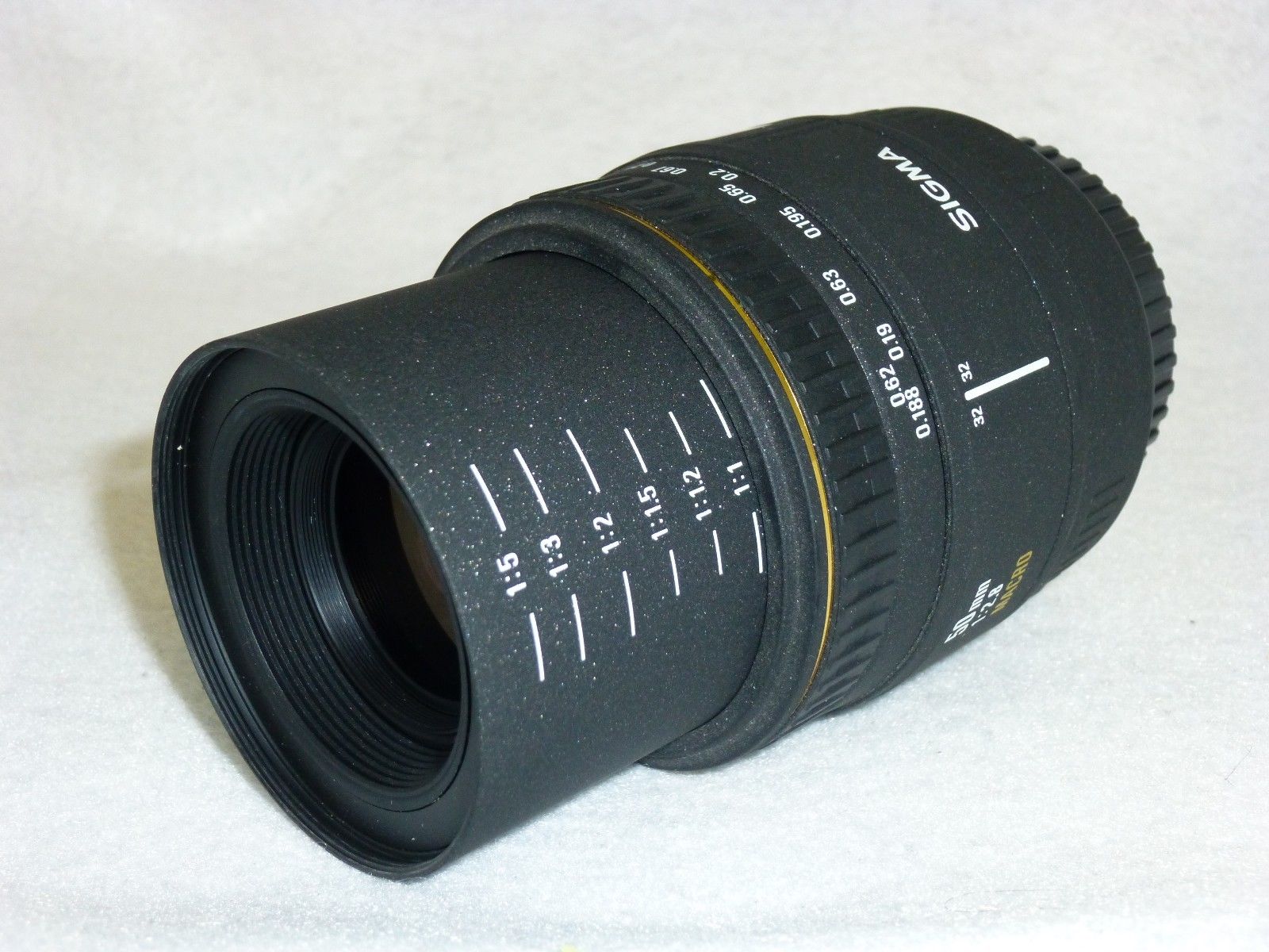

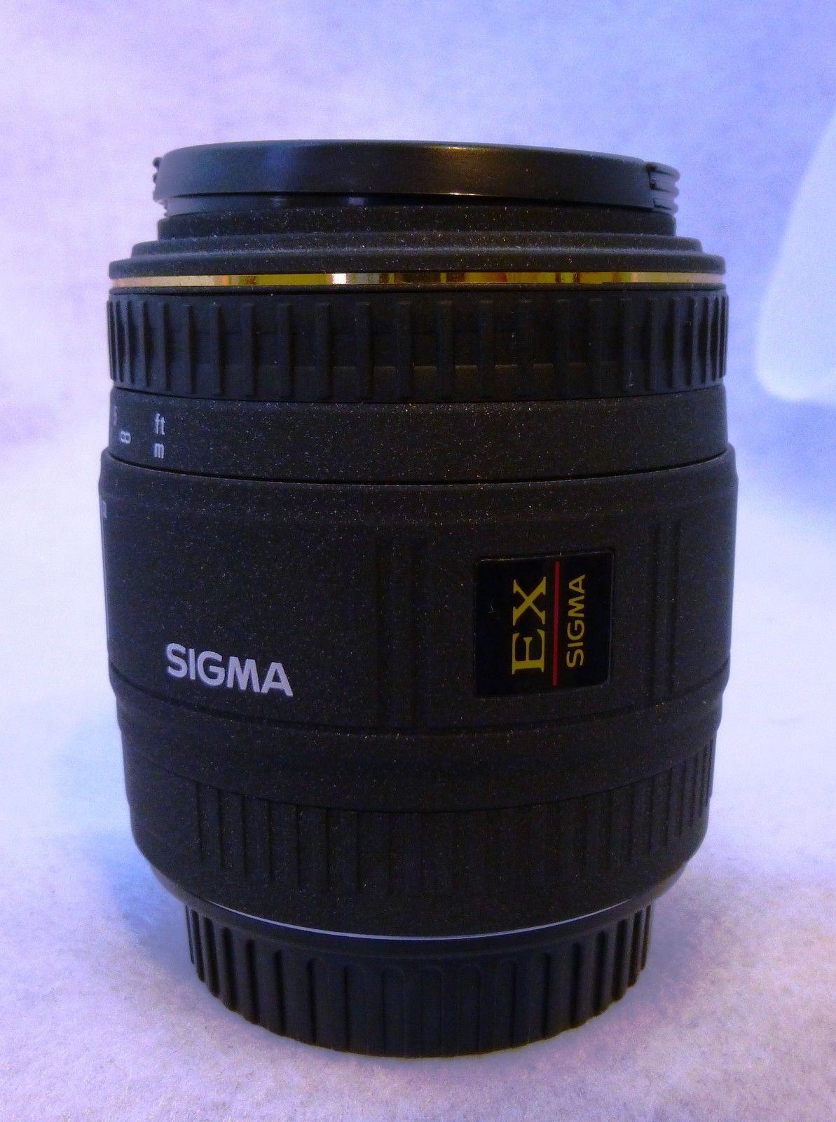

Here are photos of the lens since now it sounds like it may be for a EOS mount?
I'm at work so there are photos from the web of it until I can photograph the mount under the cap.
So with these photos, do I have to get an EOS mount camera or is it possible to use any canon? Only the manual focus works on it according to the seller.
Thanks,
Rick
Perhaps afterall I should just get a digital Rebel like has been suggested.
Thanks guys, I think I have what I need now and will report my progress soon.
