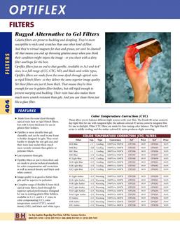

Not much to offer that has not already been posted. However, If you can't find Wratten filters and decide to go with Optiflex filters, my experience with those is that they crack and chip when trying to cut them to size. I actually did cut two of them to size for various projects, but it was a matter of chipping away at the edges to make the shape. Very difficult to work with for projects like this.
