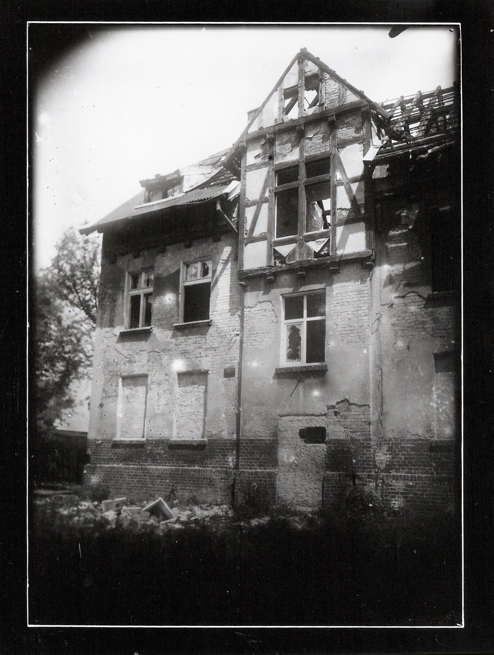

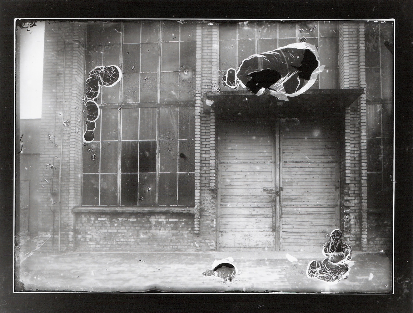

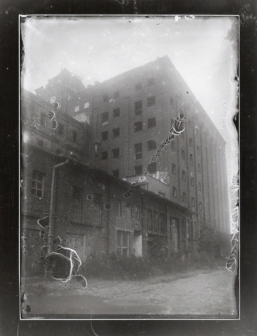

Ok, so I finally managed to scan the prints of the 9 pictures forming one cycle about abandoned ruins.
I'm not sure how the attachement system works here, I hope it uploaded well and that you can see them.
I look forward to hear from you what do you think about it :smile:
Cheers!

Great results! The minor imperfections even add to the overall image.
Please keep us updated on your future work,
Emulsion.
Real, interesting photographs are much more fun to look at than test charts. Thanks for sharing and keep going!
