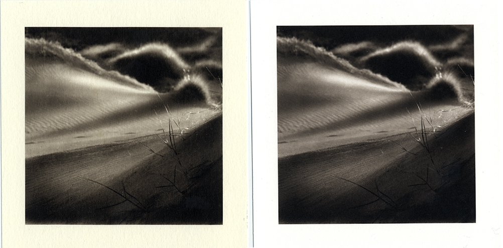

Do you have any scanned examples? Below is Kozo vs Platine. For some images Kozo is exquisite and gives great luminosity to a print.
