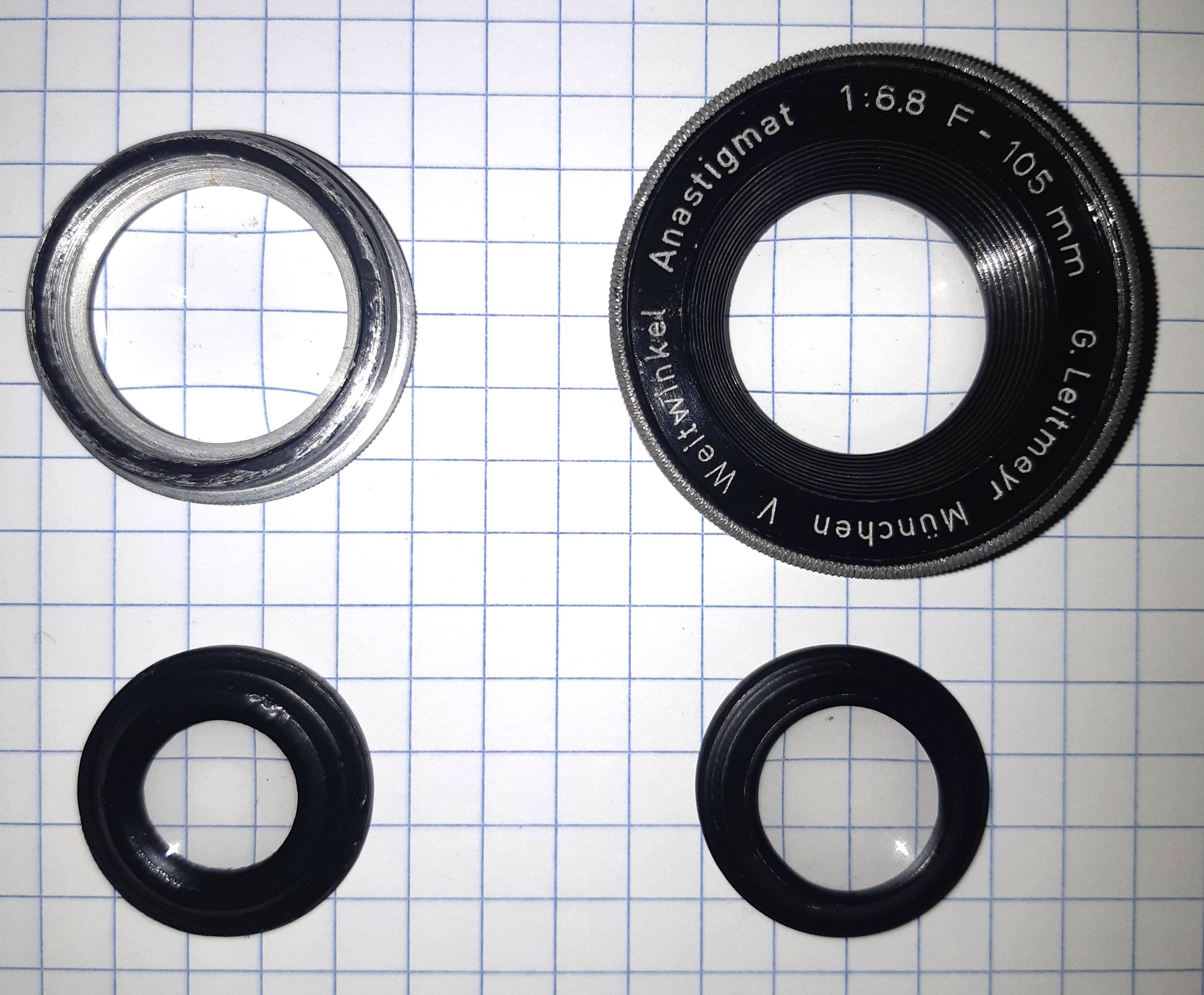

Yes, I can confirm that my lens consists of four (4x) meniscus elements, one element in each of the four holder shown in the photo. The orientation is the similar to a Meyer Gorlitz Weitwinkel Aristostigmat.

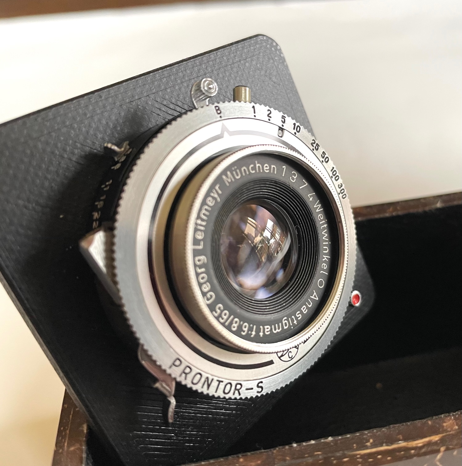

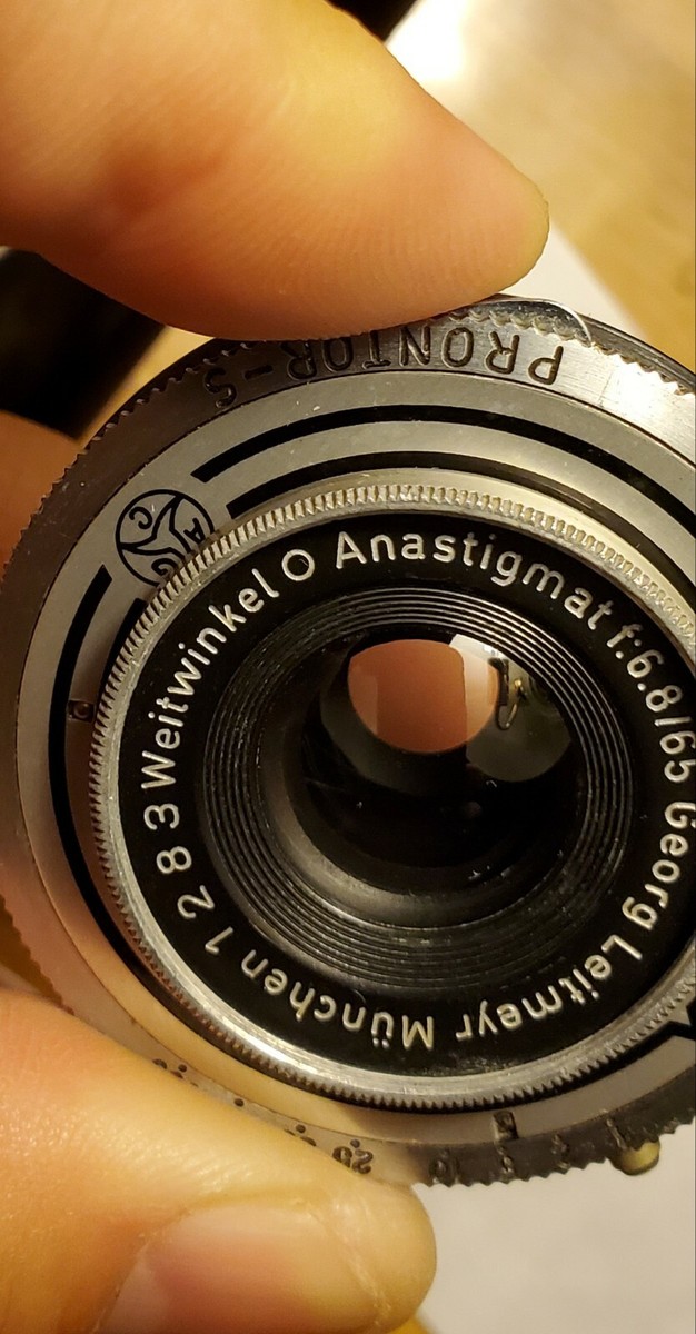

A few have an "O" instead of "V":

Your picture shows the lens to be a 105mm.
I have a 120mm Leitmeyr which is also the same formula and is supposed to cover 5X7.
