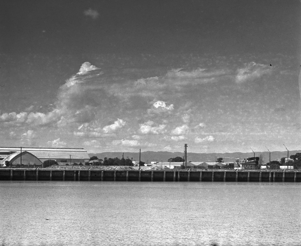

I've also had this, example below.
It was FP4+, no idea of expiry date, probably bought 2nd-hand, no idea of storage conditions before I got it, but frozen by me until I used it.
1-hour 1+100 Rodinal Stand, in a film back I'd never used before (testing out the film back for leaks, mostly).
There were also some very black (undeveloped) spots at the bottom of the film that I put down to insufficient dev or air bubbles, cropped out of the scan but you can just see the edges of them.
This is 6x7, so the mottling runs lengthways along the film. This is the second frame, and the mottling is worst on the first few and seems to disappear by the end of the roll.
I've always put it down to dirty rollers on the film back that cleaned by the end of the roll, but it could also be something penetrating the roll not-completely, like Xrays or moisture from being frozen (ie, it's worse on the bits of film that were closer to the outside before being used).
With so many variables (and already one dev error) I don't think it could be pinned down exactly what went wrong with this roll, and always assumed that I'd cocked it up.
ps, I've also had the Shanghai GP3 mottling + number imprint issue, and this looks totally different.
