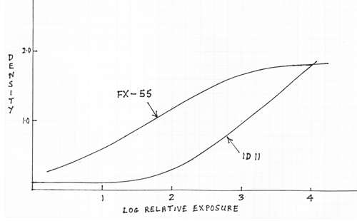

On the attachment I have plotted the curves for Delta 100 in FX-55 (from Crawley's AP article) and in ID-11 (similar to D-76, from Ilford's data).
The curves suggest a higher contrast for FX-55 in the lower mid tones.
I made prints from negatives of the same scene in different developers.FX-55 gave somewhat higher mid-tone contrast than Xtol 1+3, more than PC-TEA and a lot more than D-76 1+1.As its pH is only about 8 FX-55 gives fine grain although with low sulfite it is an acutance developer not a solvent developer.
Anyhow this first rather unscientific tests suggests FX-55 has potential for interesting tonality.
