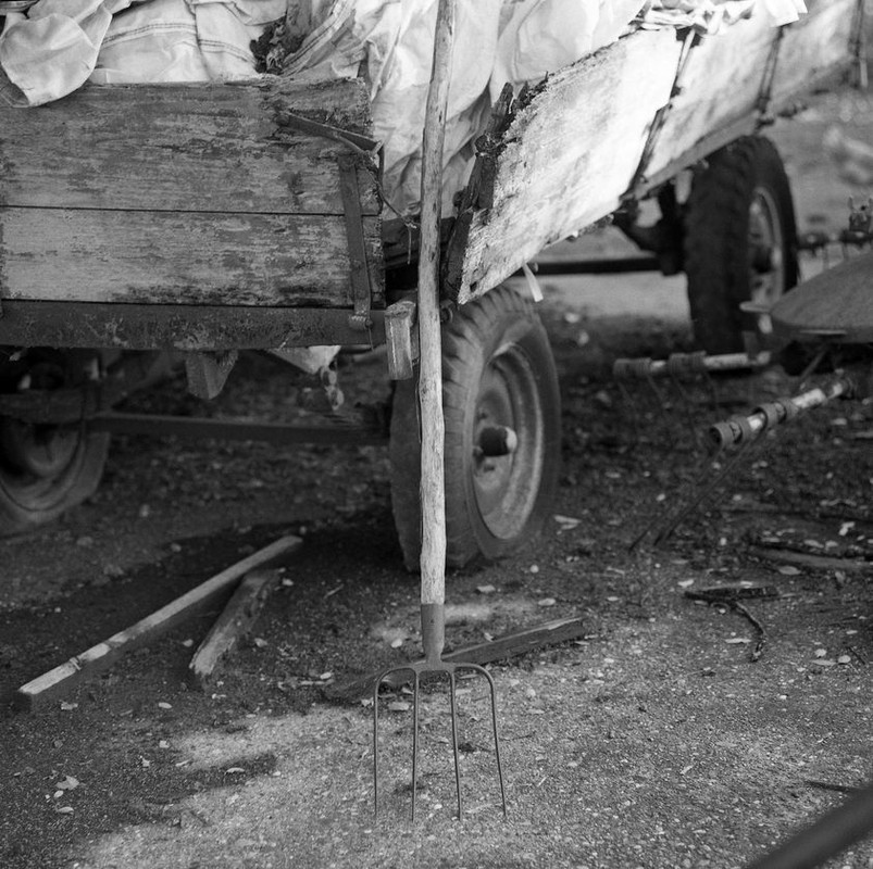

FX-55 is my main and favorite developer, along with a couple of double baths.
I have to develop a Rollei RPX-400 film (exposed at 400) in 120 format (low contrast scenes, approximately 5 stops).
I don't have the time for this film because it's the first time I've used it.
These are quite important shots and I don't want to make serious mistakes.
The only indication I have found refers to Agfa APX-400 in FX-55 for 12 minutes.
I wanted your feedback on these times, or if any of you have used this combination.
Thank you all.

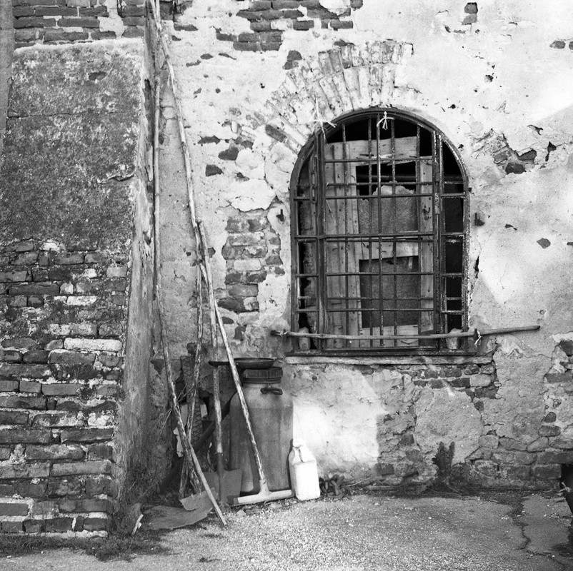

in the end I took a chance with 13 minutes / 21 °C.
I'll check after printing, but I think it's a good place to start.
The negative seems correct and printable to me.
Looks pretty good to me. If anything the highlights may have been slightly overdeveloped
