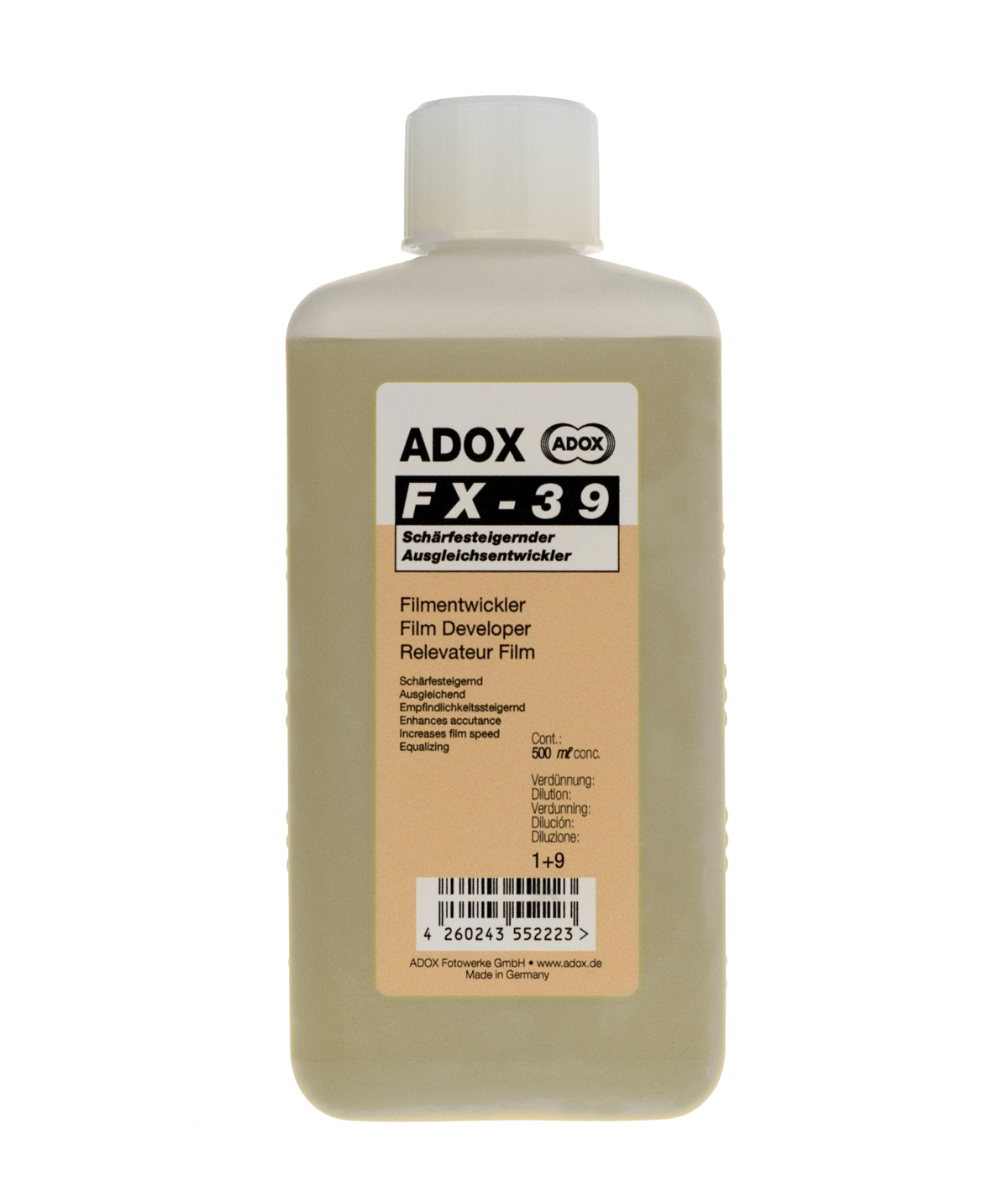

After Paterson had no interest in continuing the chemistry line we rememebered what we had promised Geoffrey Crawley about 10 years ago: "to keep his baby allive". Here he is again. We hope the 6 months interruption of supply has not led to escapades by its fans.
Stock will show by 6PM CET.
http://www.fotoimpex.de/shopen/chemistry/adox-fx-39-500ml.html

Well, not really :smile: From a marketing standpoint of view they look very similar, Schärfesteigernder Enwickler on both bottles. And since I prefer the tonality of Neofin to Rodinal I think I might prefer Crawley's brew.
