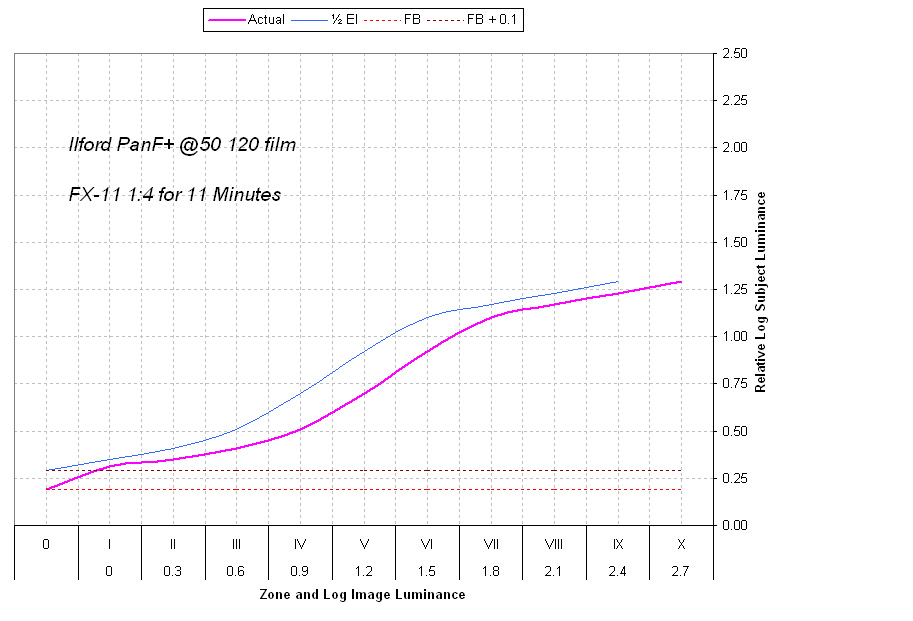

As there seems to be so little out there on this, I'll post what I come up with regarding FX-11 in case it might be found and give others some idea of what to expect. I ran some PanF+ and some Neopan 400 today. The Neopan is still drying but I got some densities done on the PanF+. I tried shooting at full emulsion speed with the PanF+ as I've never gotten better than 25-32 with other soups over the years and I was expecting some speed enhancement with the FX-11. It proved to be about right. Compressed highlights didn't jump out at me visually on the negatives so much but showed on the densitometers. My spreadsheet is set to overlay a second curve at 1/2 the EI to help me visualize the effect of 1 stop extra exposure....I mention that in case it is initially confusing when you are looking at my chart.

According to Crawley's table on page 197 of the 1974 BJP, PAN-F development time is 4 minutes at 68F in the undiluted FX-11 stock solution.
