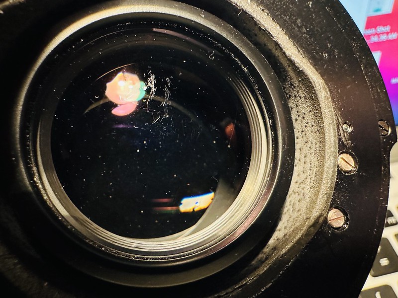

This is the rear of a Hasselblad 80mm f/2.8 T lens. Is this fungus and if so, who would you send it to to have it removed and cleaned? Or is it scratches in the coating?

It sure looks like fungal mycelial strands. Sometimes strong UV light will kill and somewhat reduce that. Or you can try a tightly sealed desiccation box filled with fresh silica gel, and leave it in there several months, to see if that helps as well. But it would be best to send it off for an internal cleaning, if the value of the lens warrants that. Someone else will have to give a tip where to send it.

Fungus, if that is scratches you should be able to feel it with your fingernail. Once in the cement between lens elements fungus is difficult to destroy. Keep it absolutely dry as Drew has mentioned.

No not fungus IMHO looks like light scratch marks in the rear coating. Try to identify the surface it's on, if on the very rear unlikely to be fungus. The strands normally grow and appear to be joined together from a starting point, often at the edge. Looks like the whole thing needs a good clean anyhow then it may be easier to tell. no way to feel scratches that shallow and trying may just create more.

Some marks to the left appear to be fungus but the marks to the right appear to be scratches. I suggest that you first try lens cleaning fluid and gently wipe with a cotton ball. Then set the lens by a window for a week or two to see if the Sun's UV light clears up what appears to be fungus.

Fungus will be on the inside, but to me that looks like the coating has ben scratched off. Even so if it were fungus you'd want to stop it, but UV light will do that, or having the lens cleaned, but it doesn't mean fungus (if it is) hasn't already etched the glass. I think the bottom line is that whatever it is it isn't going to make a difference to the image if you use a lens hood.

Maybe it’s not fungus and that would be great—I hate fungus in lenses. I’d still like to send it to someone who knows how to clean it if it’s fungus. Any suggestions?

It looks like scratches, really. They look like the scratches you get when e.g. keeping a couple of lenses without caps in a box or carrying bag and allow them to rattle about. The filter thread on one lens can then scratch the lens elements of another.
If it's fungus, take a q-tip and some ethanol or another light alcohol and remove it. Easy enough. However, if fungal growth has etched the glass, no cleaning will ever remove the damage. The same is true for the scratches you appear to have on your lens.
I don't see any reason to send this lens off for cleaning. Do whatever cleaning needed yourself, and live with the remaining damage.

Like several people mentioned, I also tend to believe it is scratches rather than fungus. Or could be scratches due to previous owner trying to remove fungus.

PS Looks like scratches to me.
