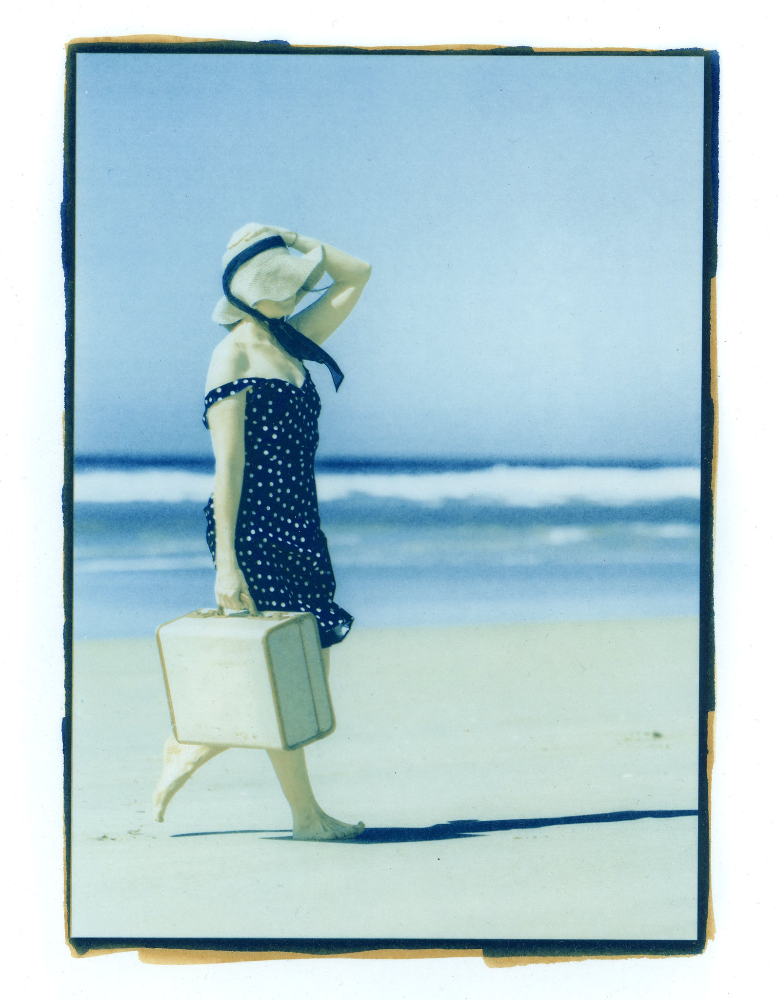

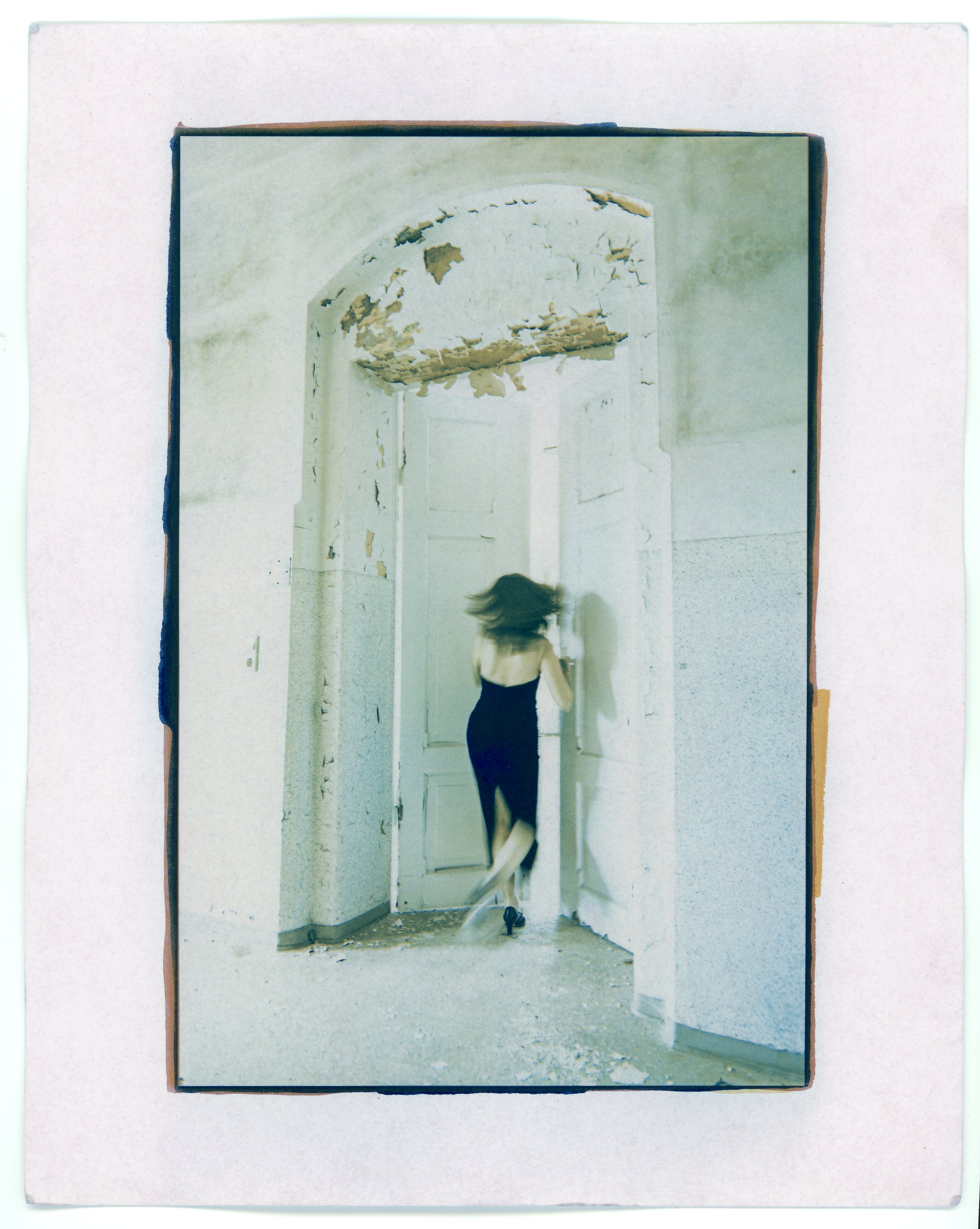

Here are a couple of multi-colour cyanotypes (only cyanotype chemistry is being used, but for tri-colour images, the magenta layer is toned with, in my case, madder root):
This is a duotone print:
And this is a tri-colour cyanotype:

That's absolutely fantastic, @maverickaesthetics ! I take it you do the madder-toned layer first? Absolutely fantastic work!
@skahde no worries; just wanted to point this out before we have two trains of thought crossing all the time; it tends to result in confusion sooner or later. Please feel free to bring up your question in a separate thread!
Feb 7, 2024
27
New Zealand
Thanks, Koraks. Yes, you have to print the magenta layer first. Bleach the cyan layer (printed with the magenta/green negative) and tone with madder root. Then print the yellow layer (blue negative) with cyanotype and bleach back to yellow. Finally, print your cyan (red negative) layer as a regular cyanotype. Madder roots stains the paper quite badly, which reduces the overall contrast - which is probably my biggest issue with this process.
I might start a new thread with some images and notes if there's interest...
In the meantime, I have written a long-ish article about the process at https://www.alternativephotography.com/multi-coloured-cyanotype-print/. It's based on the work of Annette Golaz, whom we have to thank for the modernisation (and sophistication) of the whole toning cyanotype process. I've tried most of the published methods that came before her book and they were marginally acceptable at best. In no way could they have been used for anything resembling a full-colour print. But with Annette's experiments, we can now actually do fairly convincing full-colour cyanotypes...

As a side-note: Bob, I have the second print from above (the one with the door) as a gum bichromate version in the same gum exhibition as you next week. I never thought this possible even a few months ago...
Ok on coating very simple... We use two brushes, the exact same one Richelson(sp)
One is for Pt Pd and one which is now 25 years old for gum, - We take very good care of our brushes
IMHO the secret of coating is Gliding and the word Brushing should get out of your head... you are not pushing the liquids onto the paper but rather
gently gliding and letting them sink into the papers water base level. at around 55% .
We are very gentle with our coatings and with the fine edge of the Richleosn (sp). we will gently apply to the whole paper surface once then with maybe
three strokes across without the edge of the brush curving apply the liquid , that is it. so absolutely do not brush rather than glide, I you ever have handled
a newborn consider this when putting anything on paper.
I have seen people do the opposite and drive the liquid into the paper - result grainy ugly prints.
