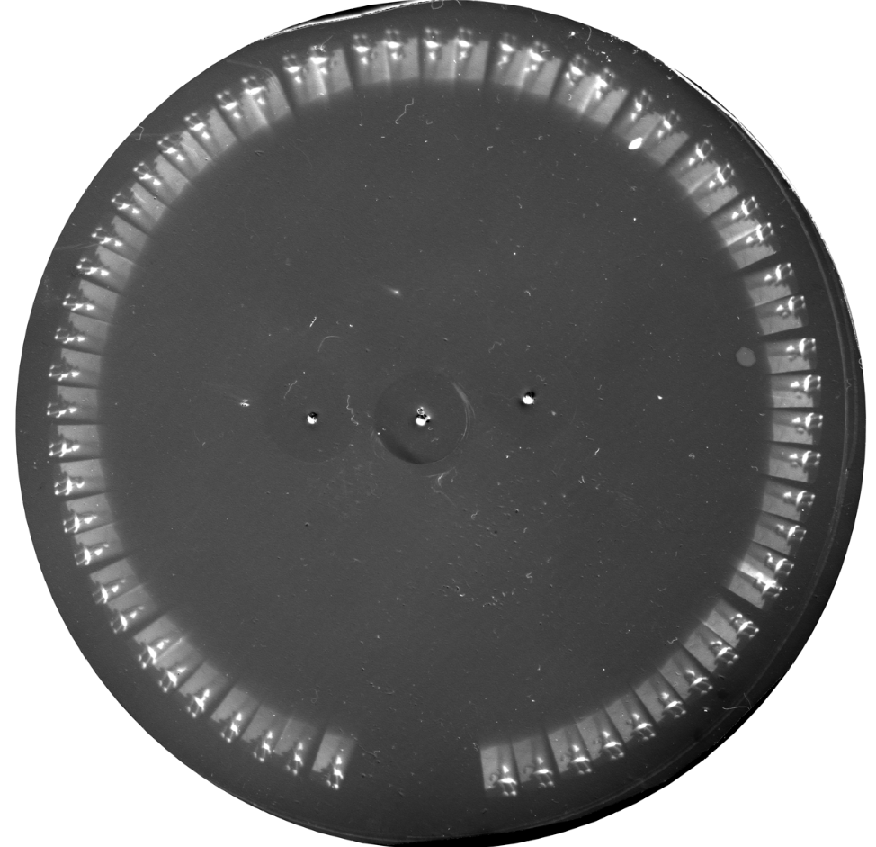

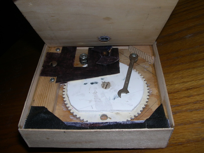

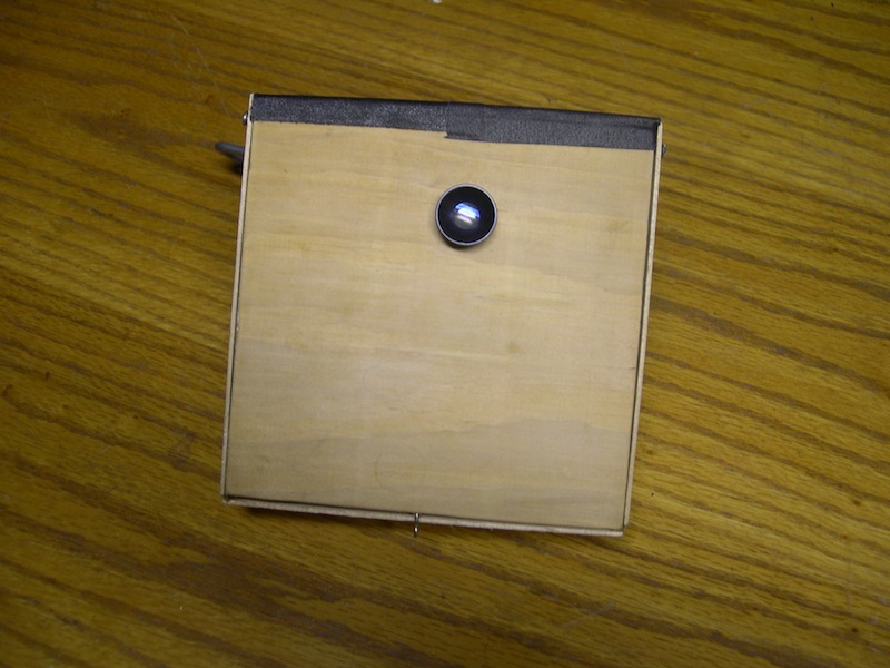

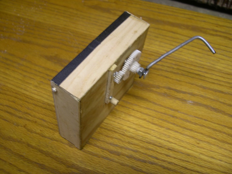

Hello Everyone, its been a while since I last posted on apug. I finally got some time off work to tinker around over the weekend. Having read through the limited info online on Leo Kamm's "kammotgraph" (a precursor to the kinetiscope) I decided it should be easy enough to build one. After working out the math -each image being 4mm tall with 1mm pitch in between=roughly 64 images on a 4 inch photo paper disc. I used Agfa paper and developed in HC110 (I was out of dektol) As you can tell from the image (that's supposed to be a waving monkey puppet w/ a banana) the f1.4 lens I found has a limited DOF and my focus was way off! But somewhat satisfactory for the first test run. Some frames overlap due possible gear slippage. Although not exactly a kammotograph (as Mr Kamm's device moved disc horizontally as it spun to allow more images on the disc) I will most probably build a Model N. 2 that would do this to at least get 10 seconds. In total 60 frames @ ~16fps. Maybe my brother, who is a woodworker, should've helped me with this one! to watch, click on link:

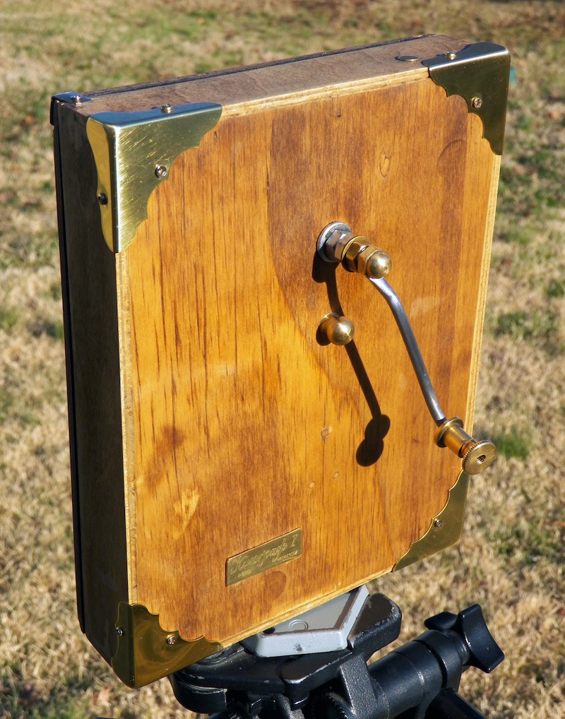

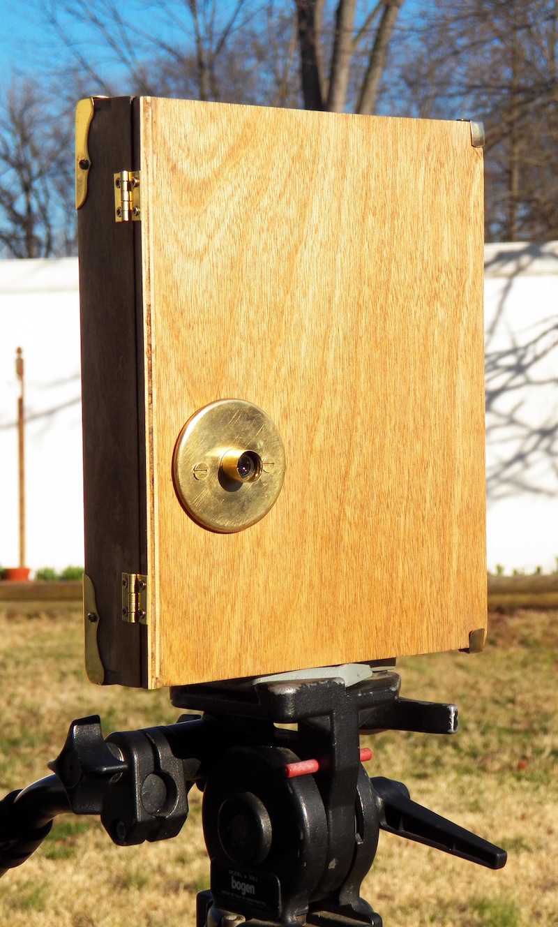

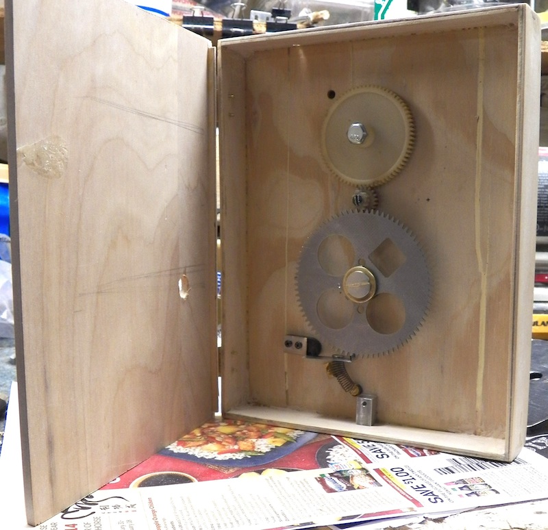

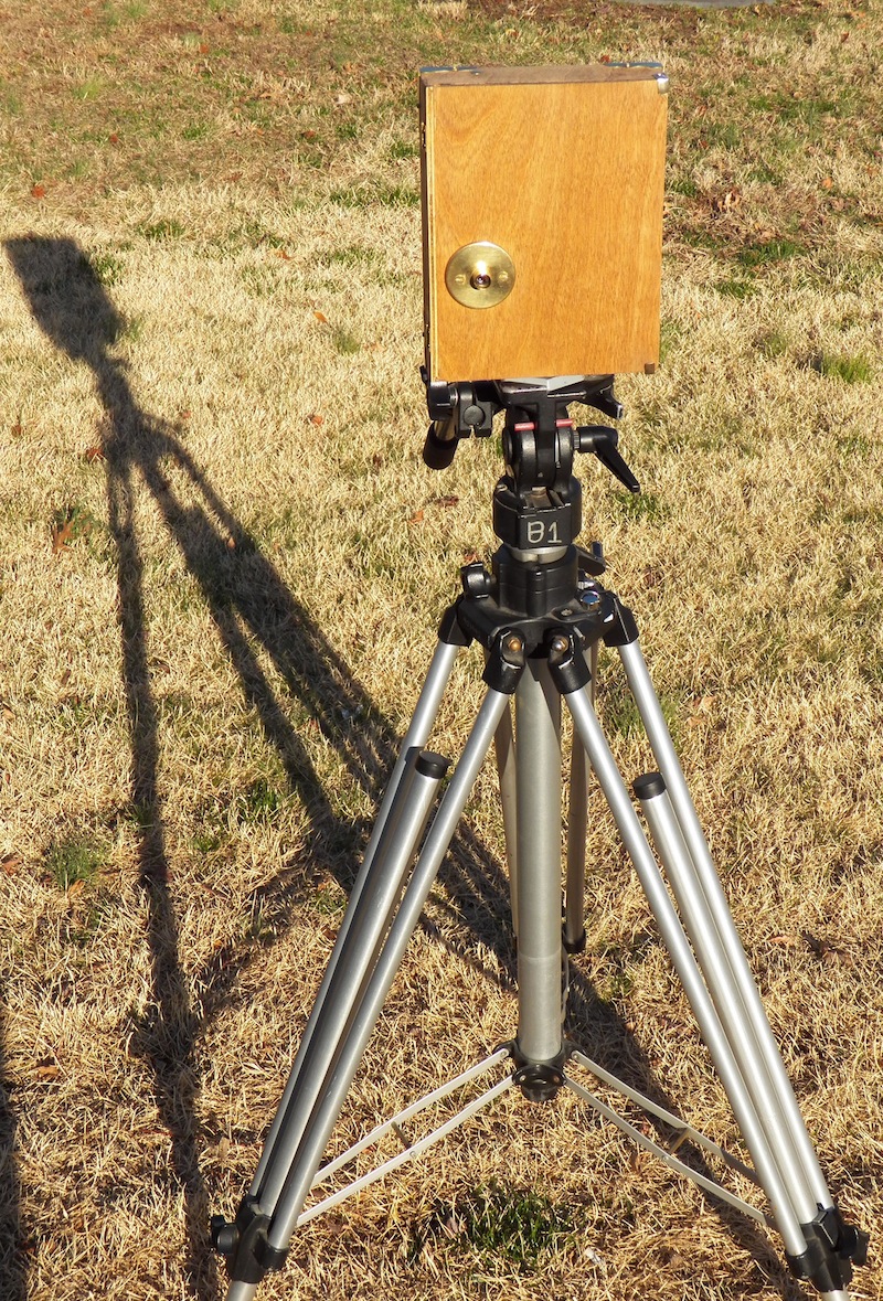

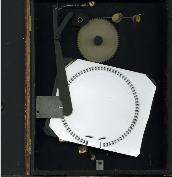

Hello, I’m back in school now and have had enough time to return to the Kammatograph project. As an update, I am still in R&D phase to build a true working model of a Kammatogrpah that uses 30cm glass disks and forms consecutive images in a spiral. In the meanwhile, however, I needed a platform to test various mechanical set-ups (lenses, intermittent mechanisms, etc. ). Hence this latest creation. I built it using some old gears I had around the house and plywood, stained "white oak" flavour. Essentially, it is a big brother to my original scratch-built camera. I’d like to thank Stephen Kamm (Mr. Leo Kamm’s grandson) for his previous post and also Barry S. for his advice on building a larger machine that eliminated having to cut the photographic paper. Tech Specs: f1.9/13mm Kodak Ektanon Lens with lens caps that have stops (not shown). ~90° shutter/ approx. 12 FPS/ 81 6mm x 3.3mm Images on 4x5 inch photo paper. Also, if anyone has any information on this particular lens, or where I can find out more about it, I’d be grateful. Total cost of project under $20.
link to camera tests (on youtube):
https://www.youtube.com/watch?v=6lp-5lKrJwE
link to see how it works: (a peek inside)
https://www.youtube.com/watch?v=M2XKuS1oEcE
