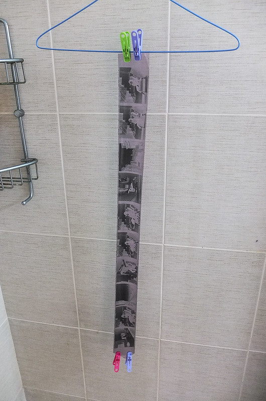

Well, after 20 years shooting cameras, today I finally developed my first roll of film. What an absolute BLAST that was! Piece of cake. Just getting that reel loaded was difficult.
I dont have a scanner now, nor can I print so I cant fully evaluate the negatives, but to my inexperienced eye, they sure look decent. I'm quite pleased and ready for roll #2!

Your story reminds my re-discovery of film some 4 years ago. So much thrill and still is. At first look, your film seems well developed. I just wonder which film you used: the base looks purplish. Is this Tri-X? Next time I suggest you get your film soak in water for 30s or 1min before the development, so you will get rid of some of the anti-halation layer.

Yeah. I'm a pre-soak guy too. Gets rid of the purple. But what you've got there is gorgeous. It'll print fine.

Yes, this film is Tri-X. I was wondering about pre-soaking and was not sure what to do about that. My house is a bit on the cool side so I loaded up the developing tank with developer when the temp was 20.5 C. Perhaps a pre soak would have been better.
So, to be clear, a purple look is a sign of temp that is too low?

OK, now that I have looked at my professionally developed negatives and compared them to my own, I see the difference. Mine definitely has a purple cast to it, and perhaps (i'm not sure), look a bit thin.
Is this a sign of poor temperature control? Should my film tank be in the water bath while waiting for the next round of agitation?

Affirmative on all counts.

If anything, those negs look a bit underexposed to me. The basic rule- expose for shadows, develop for highlights- will start making sense to you now. The shadow areas- lightest on the negatives- aren't affected much by time or temperature when developing. Well, easy to be an armchair quarterback on the internet, yes? Congratuations! After decades and what must be thousands of rolls, I still pull the film off the reel with excitement.
For drying 120 film, I used a printing roll box for years. If you have any digital printing outfits in your area- Kinkos/Fedex, sign companies, blueprint outfits- ask them to save you a box from a 48 inch or 54 inch roll of paper. Stand it on end. Poke a stick through the top edge- a chopstick works well. Spray a fine mist of water inside the box while the film is washing to settle any dust. Hang the film from the stick, close up the top, and wait overnight. Much less dust than open-air drying. When the cardboard starts getting ratty, go pick up another box!

I don't do a pre soak w/ Tri-X, but I wash it for 30 to 40 minutes to get rid of that color cast.
My experience has been that the developing process sets the purple. Only the pre-soak ever got it out. And to boot, gets the tank, reel, and film to proper temperature. I temperature-control my pre-soak water as if it were developer.
How long do you presoak and do you agitate during this time? If so, how much?

A couple minutes or so. Maybe even 5. Never clocked it. But I use the freeezer or the stove to get my developer and presoak water to proper temp, and get busy. I use a SS tank with a piece of electrical tape around the seam so that water and developer don't do osmosis, and drop the tank in a bucket of water brought to temperature, between agitations. Maybe a lot of over kill, but that's the only way you can track down density problems. From what I saw, your negs were a hair thin, but probably printable. Remember, Kodak time charts tend to err towards under development, IMO. The moral is to never let your temp drop or cut the time even one second shorter.

I am one of those who pre-soak.
I do it for three minutes with constant rotary agitation.
It probably wouldn't make any difference if I did it for two minutes with inversion agitation - 5 seconds for every 30 seconds - as long as the first 30 seconds see continuous agitation.

I don't agitate. I just pour the water in and go smoke a cigarette. It doesn't need to be agitated. It's only to temperature-condition the tank and reel. Washing the purple out is a side benefit. Agitation never changed that for me.
Ok, I'll do that, minus the cigarette part. I'll soak the film for 3-4 mins or so before the temp starts to drop. HUGE thanks.

The purple didn't used to be a problem. But nowadays all the paper is that damnable variable contrast stuff.. VC filters go from yellow on one end to purple on the other. The purple in your film wreaks havoc on trying to find a repeatable VC filter standard. You can't buy Kodabromide or Ilfobrom any more. It's all that VC crap. Were it not for that, we wouldn't have to have this conversation.
