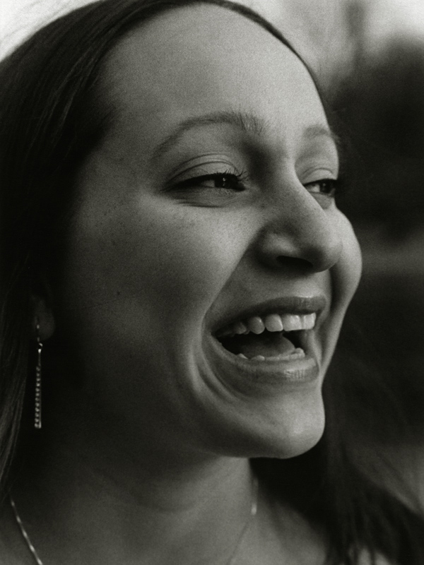

Diafine
Diafine works, and in my experience gives a similar grain to Rodinal if you process like dfcardwell suggests (with reduced agitation).
Attached image is a print from 35mm Tri-X at EI 1,000 in Diafine.
- Thomas

Thanks, everyone! I'm going to give D-23 a try, as well as Diafine. It sounds like the D-23 can help retain that grittiness that I've been enjoying with Rodinal.
