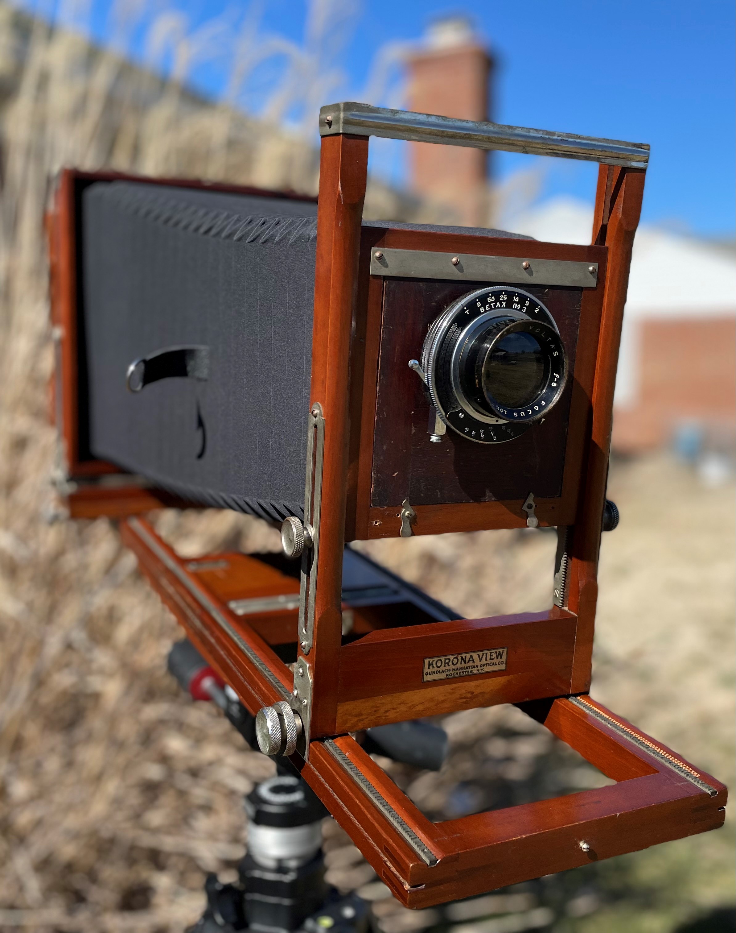

Thought I'd cap this off with the finished camera, ready to shoot. Just waiting on a focus cloth and to cut down some X-Ray film to start getting used to this camera.
After that, I'll start exploring maybe some Agfa Aviphot or Ilford Delta 100 when I am sure everything is light tight and functional.
Got my Wollensak Voltas F-8 convertible lens in a Betax #3 shutter mounted on a surplus lens board I had laying around, but will probably replace it in the future, as it is off-center, but I am tired of waiting and want to start shooting soon.

Nothing wrong with off center. Gets you more front rise or if you run out of fall turn it upside down. That’s a splendid lens for that outfit.

Thanks!
I thought that might be the reason for the off-center hole, but wasn't sure. Glad to have that suspicion confirmed!
The image on the ground glass is amazing. Wide open, I was expecting a lot less detail and more of a vintage look than I witnessed, but by all aspects it looks very modern; Stopped-down it should be incredible.
Guess those guys back then knew what they were doing after all.
Just hope I can do them justice...
