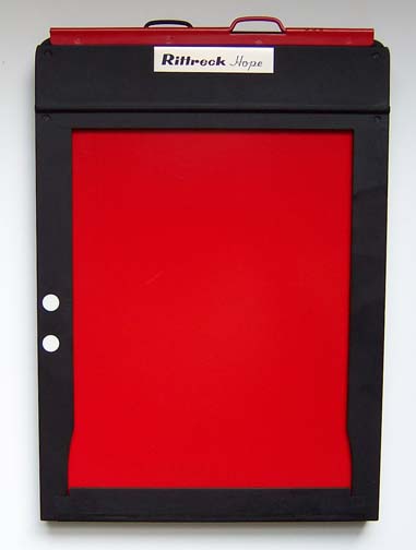

My Rittreck FP holders were probably some of the last made. They measure about 7-3/4" wide or just over 195mm width. They are 10-11/16" long or about 271mm not including the dark slides. I wouldn't take these as perfect measurements but should be pretty close.

The Rittreck WP holders are considerably different from the Eastman holders. In particular, the distance to the rib lock makes the Rittreck holders too long to fit in Eastman backs, or at least the Eastman backs that I have on hand.
