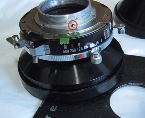

say, someon has said that there should be some sort of 'washer' or spacer between the back 'section', but when I bought mine there was none.
There is an outside thread (for the "nut" which tightens the lens board) and an inside thread (for the back section) but that's all I've ever seen.

hmm ... yes they do don't they
I don't think there is supposed to be a washer. The two pins (one circled red) hold it away from the lens board. I've seen them like that before anyway.

The pin fits into the small hole on the lensboard, it keeps the lens from rotating, some lenses have one pin some have two.

The "pin" is actually a small screw that you'll need to remove when mounting the lens on a board that doesn't have the corresponding hole.
(Tape that tiny screw to the inside of the lens case/box somewhere -- assuming you have one -- so you don't lose it.)
yes, I know, I've already unscrewed it and taped to that linhof board. I now use a Toho which has a round board and no hole ;-)
