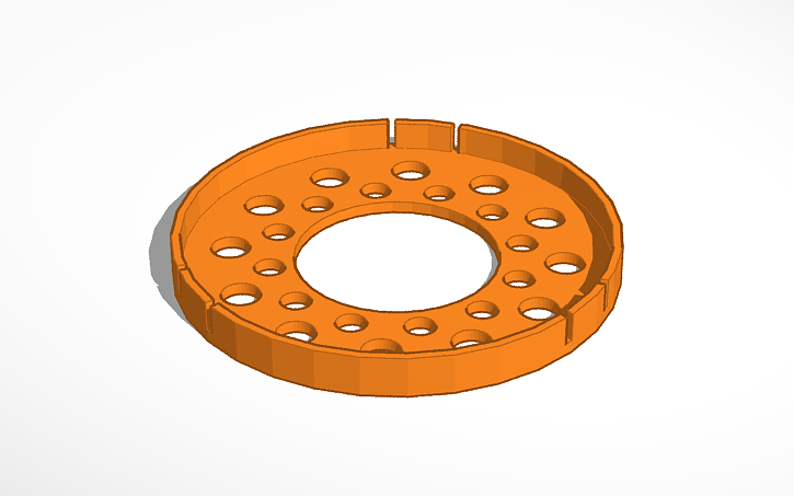

What I did was to design the (250mm yellow) disk in Thinkercad and 3D-printed it. I based the design on photographs from listings on the auction site and measurements of an actual lens. It was rather straightforward and I had a 3D printer available at that time.

Here are some dimensions for the disc set supplied with the Fujinon SF 1:5.6/250 #781350. These were measured with dial calipers, and ball-end small-hole transfer gages for the small holes.
The discs are made of aluminum alloy painted dull black. The measured dimensions (includes paint thickness) are:
Material thickness = 0.020” = 0.50mm
Outside diameter = 2.0127” = 51.12mm ϕ
Inside diameter of flanged edge (not across griping tabs) = 1.9647” = 49.90mm ϕ
Length over flange = 0.201” = 5.11mm (measured along the outside diameter)
Yellow-spot identification disc (large holes): The yellow spot is a 3.5mm diameter circle of thin plastic held to the disc with adhesive and is mounted between adjacent holes in the outer ring of holes (larger holes).
Center hole = 0.9288” = 23.59mm ϕ
There is an outer ring of 12 equally-spaced holes of diameter 0.155” = 3.94mm ϕ form a circle of 1.4888” = 37.82mm ϕ.
The inner ring of 12 equally-spaced holes are on radial lines midway from those of the outer ring. The diameter or the smaller inner holes is 0.133” – 0.134” = 2.38mm ϕ – 3.40mm ϕ. The centers of these lie on a circle of 1.141” diameter = 29.98mm ϕ (probable 29mm ϕ).
Red-spot disc (smaller holes): The red identifying spot is 3.5mm diameter plastic sticker as with the yellow-spot disc. The holes are in two rings as is the yellow-spot ring.
Center hole = 0.778” = 19.76mm ϕ
The outer ring is composed of 12 holes of 0.115” diameter = 2.92mm ϕ whose centers lie on a circle of 1.38” diameter = 35.05mm ϕ.
The 12-hole inner ring has holes of diameter 0.089” = 2.26mm ϕ and whose centers lie on a circle of 0.985” diameter = 25.02mm ϕ.
Who can help me please ? I'm desperately looking for soft focus discs for my fuji fujinon 180 sf. if i could have a simple copy with the scanner of both (red & yellow) that would be fantastic. The exact height & diameter would also be helpful. My son has a 3d printer and would print the soft focus discs for me, but i have no measurements ...
In the hope of an answer best regards ralph
Any chance you can share the file?
