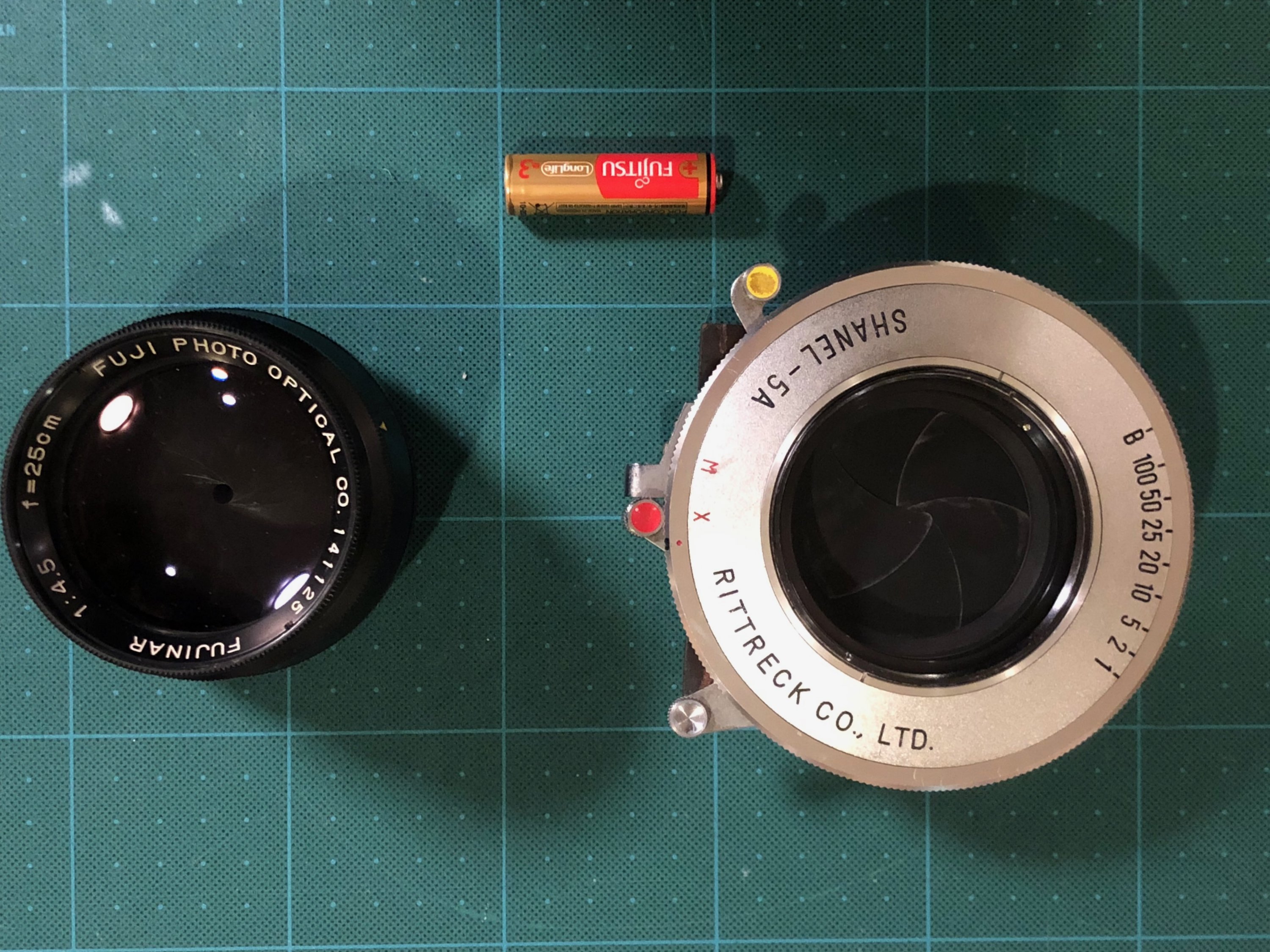

Pardon the thread resurrection... I have just purchased the same three 180mm, 210mm and 250mm Fujinar lenses in barrels and Shanel 5A, 5B and 5B-S shutters (one of each). The 210mm and 180mm barrels fit onto the 5A shutter front with step-up rings (with some effort I found the correct rings) however the 250 barrel is bigger than the shutter opening: an earlier post suggested the shutter is 65mm and the 250mm lens barrel flange is 72mm. Did you use a 72-65 step down ring to fit the 250 barrel to the 5A? Did it cause vignetting?

Vaughan, thanks for trying to reopen the thread. I have had a Fujinar 25cm barrel lens for some time and finally just got a Shanel 5A shutter. I am exactly where you were one year ago. I'm going to need a step-down adapter from the lens rear thread (approx 72mm) to the shutter front thread (65mm ?). Were you able to locate one that works, or have one made? I briefly thought about 3D printing one, but the fine threads, short length, and the weight of the lens (times its moment arm) would make that a risky route, I would think. I'll also need a flange to hold the shutter on the board, as needed by the OP in 2018.

Unfortunately no, I couldn't find the ring. Instead I picked up a Shanel 5B shutter which the 250mm lens blocks fit and has the correct f-numbers narked on the aperture scale. (The 5B-S shutter has f-numbers for the 250mm and 210mm lenses.)
