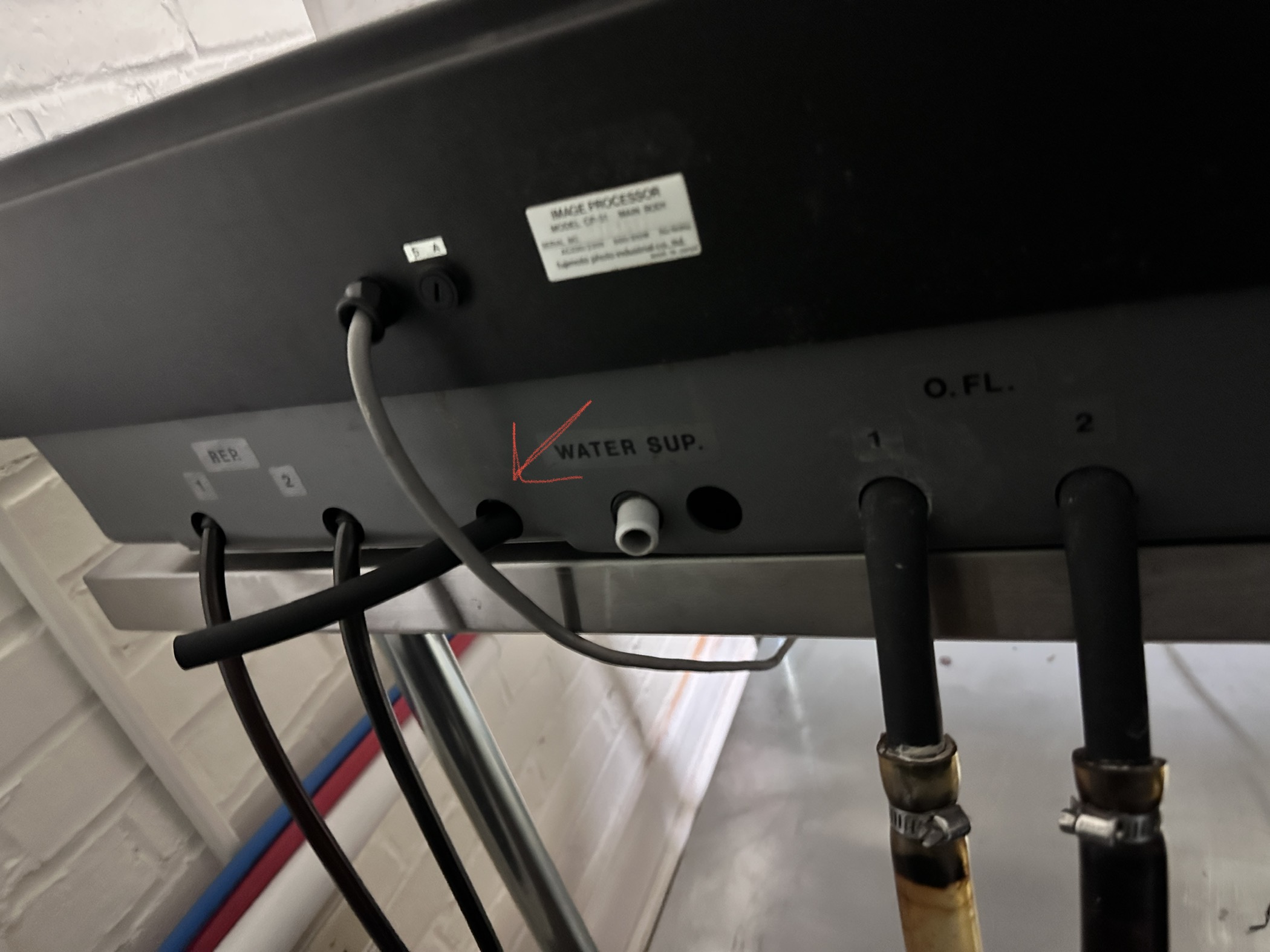

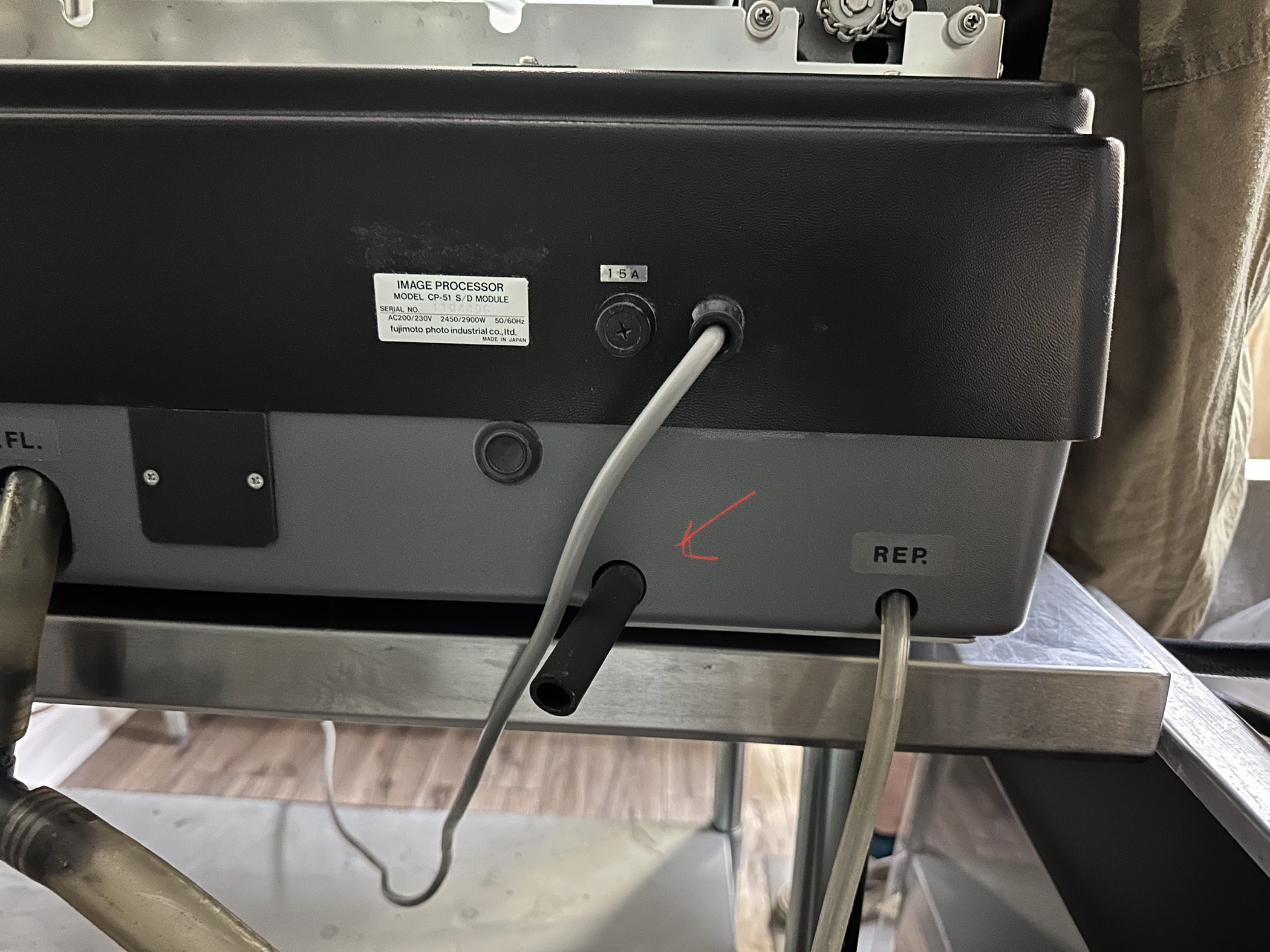

Ok brain trust, I have two mystery hoses. These are NOT overflow hoses, those are clearly marked, and I do not believe they are any kind of intake hose, as those are also marked. They are also not the drain hoses, as those come out the front and are obvious. Any ideas?

On the CP-31/32, there is a drain hose for the outer perimeter of the unit, above the level of the tanks, I think for if the usual overflow/runoff hose gets clogged or there are splashes. The manual mentions a 'gearbox drain hose', so that's my guess.
NortheastPhotographic
Mar 3, 2011
1,571
Maine!
I wonder if the previous owner cut them short. I'll run some prints and watch them a bit.

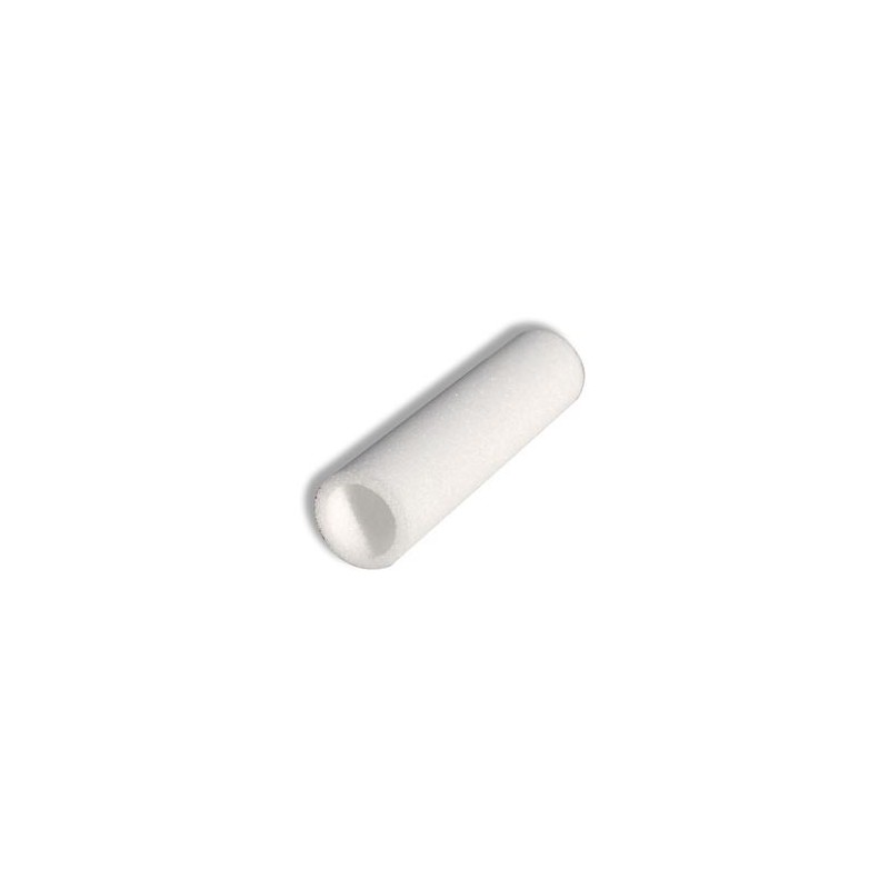

Has anyone found a replacement hard chemical filter for these? I know there are some around for sale but they're not listed as for the Fujimoto of course.
