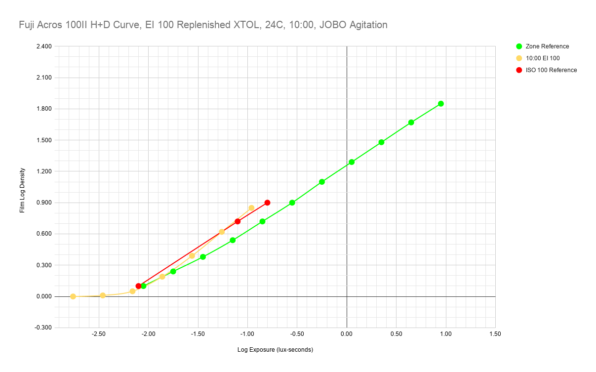

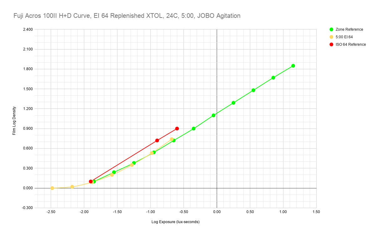

For reference, and if anybody wants to discuss.
I've made these exposures as carefully as I could and eliminated as many variables as I realistically could. While it is not scientific, and certainly not up to ISO or probably manufacturer standards, it is as accurate as I can make it with what I have available to me, and certainly accurate enough that I thought it would be share-worthy.
Each of the curves is from film base plus fog up to a correctly exposed 18 percent grey card in full stop increments using a studio strobe, and transmission rated lens set to infinity focus. The strobe was incident metered to 1/10 stop and varies less than +- 0.1 stops shot to shot. The intensity of the light to the film plane was controlled with the lens aperture, so once the strobe power was set, it did not change for the duration of the exposures. The 18 percent grey card filled the frame so there shouldn't be any flare.
The densities were measured with an X-Rite Densitometer.
I have 6 rolls left and am reserving 1 or 2 rolls for sample photos. If anybody wants to see anything specific, say so and I'll do what I can to generate it and post it.
Fuji Acros 100II H+D Curve, EI 64 Replenished XTOL, 24C, 5_00, JOBO Agitation.png
Fuji Acros 100II H+D Curve, EI 100 Replenished XTOL, 24C, 7_30, JOBO Agitation.png
Fuji Acros 100II H+D Curve, EI 100 Replenished XTOL, 24C, 10_00, JOBO Agitation.png

That looks about what I get in tray or hand-inversion drum results with other developers, so seems quite realistic.

yep. EI 64 at 5 minutes at 24C is pretty much bang on for zone contrast. I’m planning to do a run at EI 80:at 7:30, as that should be just about right for ISO contrast. The EI 100 at 7:30 puts zone 1 at 0.05 density, so it’s not quite in range to call it a 0.1 density, and pushing it to 10 minutes got it to 0.06. I think it’s between 80 and 100 in terms of ISO.

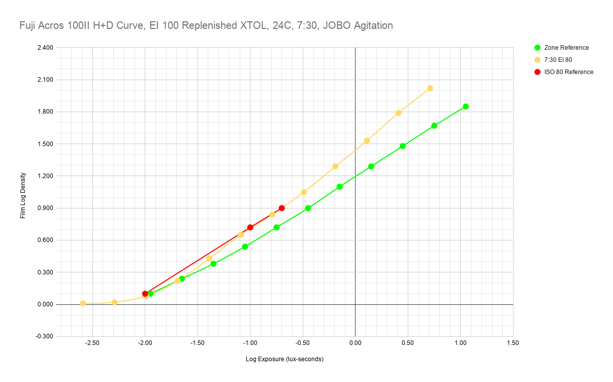

Here's EI 80 at 7:30, the full exposure range. Zone 1 landed at 0.08. A difference of 0.02 is easily inside the margin of error with my setup, so I'm good with calling Acros 100II an 80 speed film with replenished XTOL in a JOBO. At ISO contrast, you can basically shoot it at 160 and still have reasonable shadows.

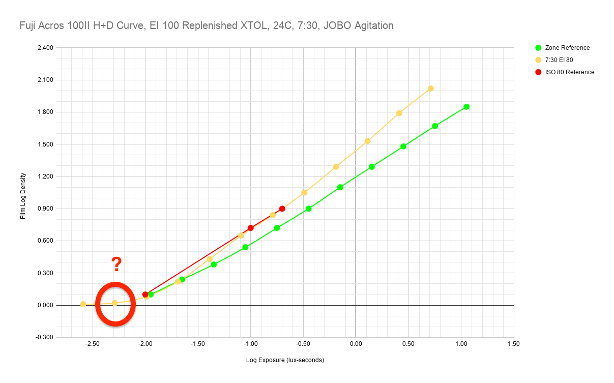

I might be misunderstanding, but it looks to me the circle here is Exposure Index 160, assuming the approximate 0.1 log d point is 80. I don't see how any shadow would be imaged on the curve there.

Well, I said reasonable shadows, not perfect shadows. There’s a third of a stop of density until film base plus fog. The next step over to the left from the speed point recorded 0.02 density, and the next step beyond that recorded 0.01. In that third stop of density you’ll be recording very low contrast shadows.
If I shot it at 160, what I’d typically do is place the new lower density middle grey at 0.18, then stretch the contrast so that there was still 4 stops between it and the speed point (instead of three stops), then still put the film base plus fog a stop below that (stretching the third stop of density between the speed point and FB out to a full stop of density) for a total of 5 stops between middle grey and film base plus fog.
that’s if it was scanned. If you are going to wet print it, that is also pretty straight forward if doing a split grade print as you’d basically be punching in your blacks with grade 5 or maximum contrast, which would have a similar effect of stretching out the contrast on the bottom half of the tone curve.
either way, 4 stops down is pretty dark, and if you punched in your film base plus fog until it was at max paper black, it’d be a lot less noticeable that there’s only 3 stops and some change in your shadows instead of 4 stops and some change.
