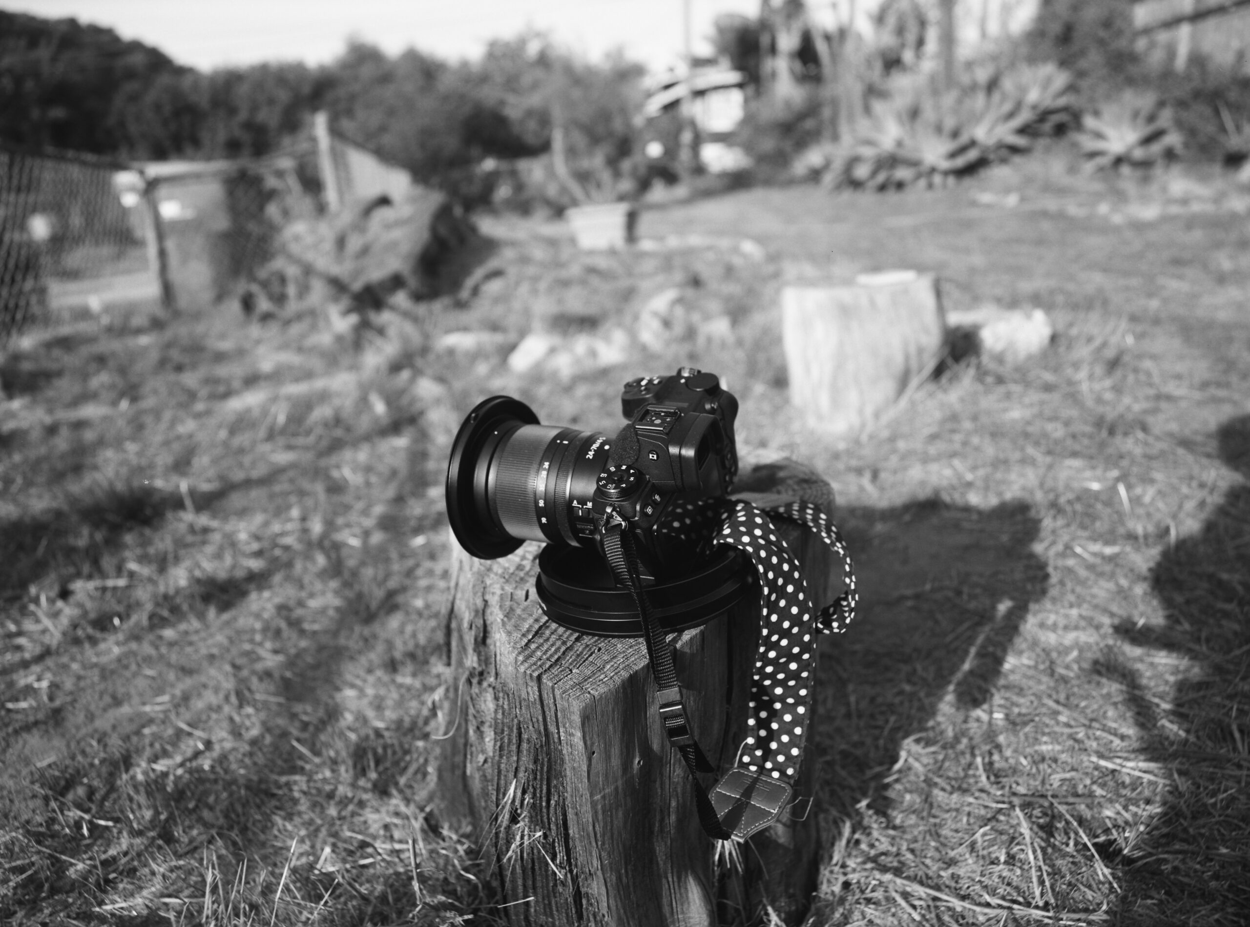

My favorite lens is the 50mm for landscape. It is just... lush I think is the word from the guy I got it from.
And, literally, the first pic I took with it:
It's great up close, with lovely bokeh when wide open. Big, though. The lens cap is that giant ash tray you see the Z6 sitting in in the picture above.
