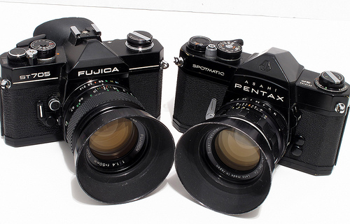

I own, use, and love the Fujica ST705, which is probably similar to the ST801. I use my ST705 and a Pentax Spotmatic as backups for my Nikon F2 cameras. Just in case it helps, here are my notes on the Fujica ST705.
Pros:
1. Solid weight and feel
2. Small size
3. Battery independent; only needs battery for built-in light meter
4. Beautiful looking; reminds me of my old Nikon F2 black body with standard viewfinder.
5. Large selection of M42 screw mount lenses available from Fuji and other manufactures
6. Fujinon screw mount lenses click into position like a bayonet mount
7. Manual focus ring same as Nikon
8. Aperture ring same as Nikon
9. Handles and feels like a Nikon
10. Low price
Cons:
1. Light meter battery position detracts from beauty of camera back; should have been placed on the bottom or on the side by the rewind crank
2. Hot shoe detracts from beauty; looks like an add on
3. Hot shoe slightly smaller; hard to insert some accessories
4. Right neck strap holder loose
5. Hot shoe is not located in line with the lens
6. Light seals near door hinge deteriorate
7. Filter size is 49mm; need 49 to 52mm step ring to attach my filters
https://flic.kr/p/8UaHwZ
