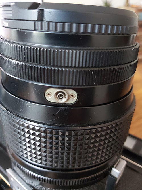

Hello,
I own a Fujica GM670. I have connected an external Flash Nikon SB-28.
I can´t manage to trigger it with any setting, whether as M, Auto and any shutter setting.
What is the right setting to make it work?
It would be very helpful to have some tip, since I could no find any info online so far.
Thank you!

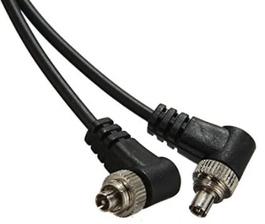

yes, of course. With a standard PC cable
As far as I know, the SB-28 should fire without issue when connected with a standard PC sync - this may be a stupid question but are you using a standard PC cable or the longer pin SC-11/ SC-15 type cord? I've been caught out all too often by trying to use a short pin PC cable on camera flashes...

I am using a 20cm cable wich, to afaik, has just 1 normal pin.
I have attached some pics.

Yes, that's the same type I've had issues with on similar speedlight flashes - it connects fine at the PC sync on the shutter, but just isn't long enough to make contact at the flash sync connector socket - it's very annoying, and makes a mockery of the notional 'standard' of the PC sync connector. If you can find an SC-11 or SC-15 - or similar sync cable with the screw lock - that should hopefully solve your problem.

I am trying with and SC-11 cable, settings on X. But it does not work. Strengely enough, if I move the pin when connector to the lens, it fires repeatedly and randomly.
