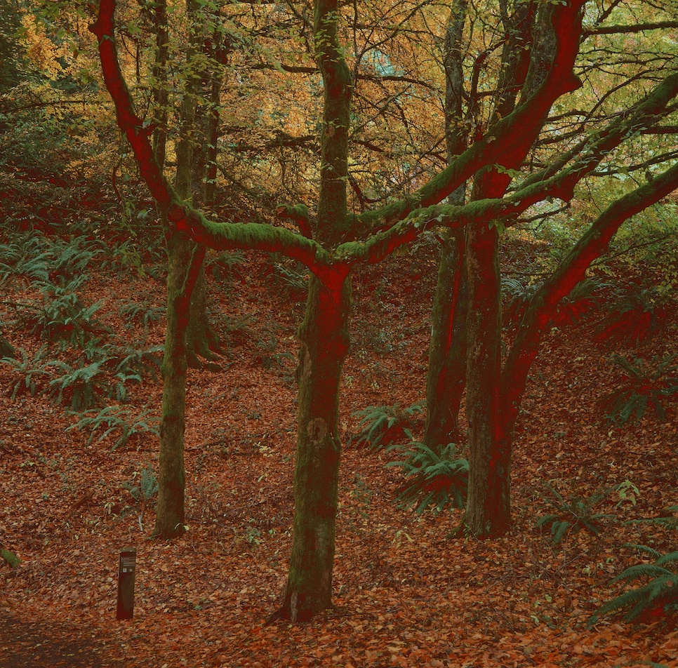

I just got back a roll of 120 Velvia, and a roll of 120 Provia that I shot in the forest near Portland, Oregon last week. Both rolls of film were fresh (expiration dates in 2024). Both have a heavy red color to the unexposed parts of the film (e.g. between frames) as well as the shadows of the images. The highlights and midtones look ~normal. The issue is less pronounced on the Provia than the Velvia. I talked to the lab about it and the guy running the line said he had no idea what was going on. He showed me today's and yesterday's control strips for the E6 line, and they looked normal (no red). He said he assumed my film had gone through an airport scanner (it hasn't).
I can only assume it's a processing issue, but with the lab itself (a long-standing, busy lab, FWIW) not knowing what could cause it, I figured I'd turn to the experts here.
See a couple of the scanned images attached, but note that it is *not* a scanning issue. I noticed it looking at the film itself in the parking lot of the lab after picking it up.
Provia:
Velvia:
Film itself (Velvia):

I realize that wasn't what you were expecting, but it looks pretty neat! The upside-down is real.....😈
Anyway, looks like it could have been some sort of light exposure part way through the process.

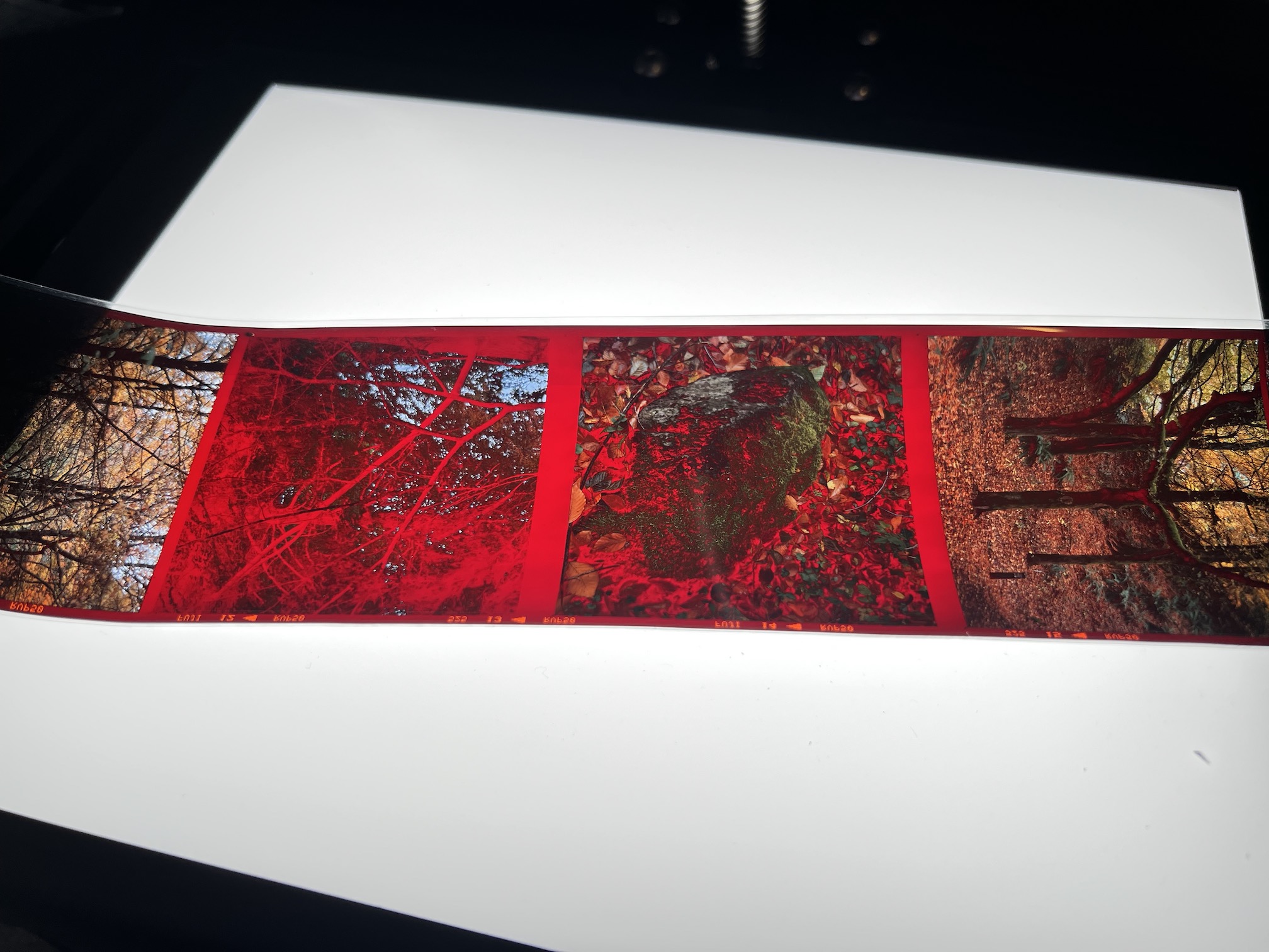

Did you try editing the scans to fix the shadow issues? Any tips or tricks you could share would be greatly appreciated. I've tried several methods, but I haven't been able to remove the redness without impacting the rest of the image.
Thanks in advance for any advice!

I'm sorry to hear about your problem with this film. Is it indeed slide film as discussed earlier in the thread, or color negative?
Have you tried re-bleaching and re-fixing the film? Is there a possibility of posting some photos of a strip of affected film against a backlight (i.e. no scans)?

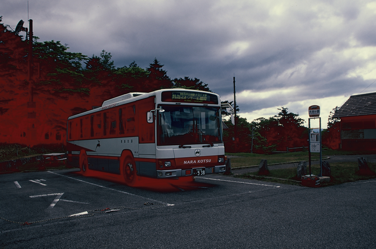

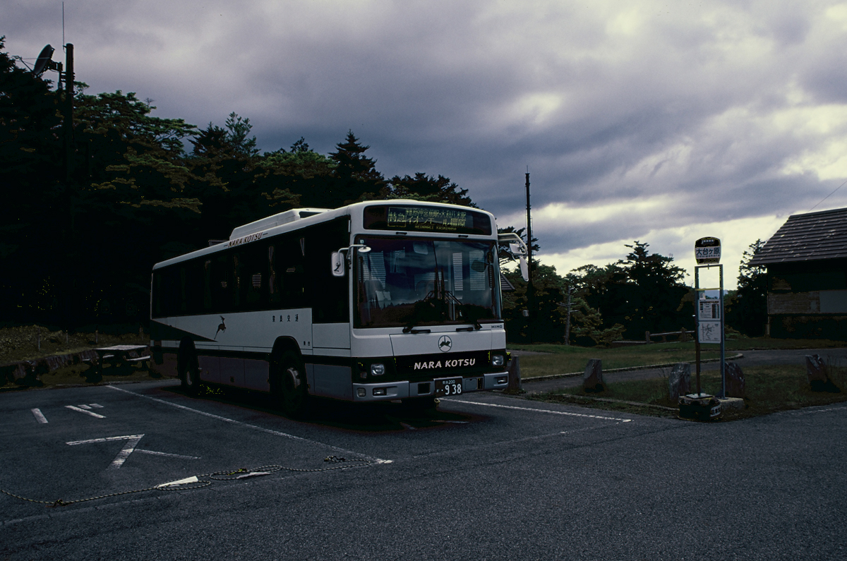

See the results in the image I posted. I did a quick and dirty job of it so you can take your time and do it much better than me.

Yes, it's the same film — Fuji Velvia.
No, I haven't, I didn’t even think that something else could be done with film. I'll ask around in the labs, maybe they can pull it off, thank you so much for the advise!

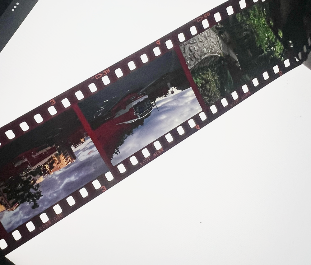

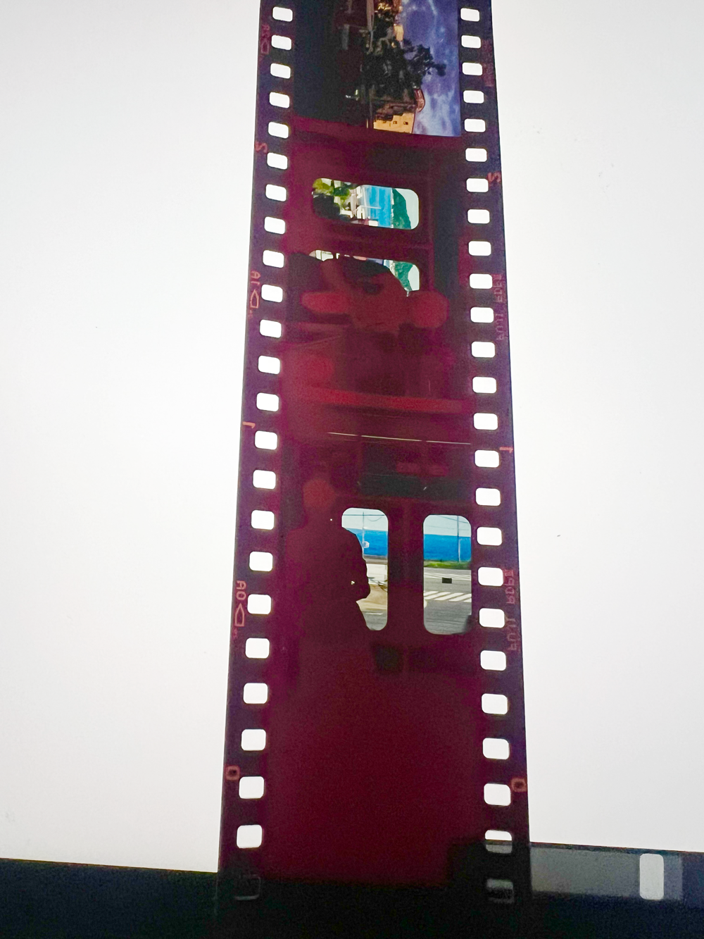

Here are photos of the film. The entire black stripe is indeed red
