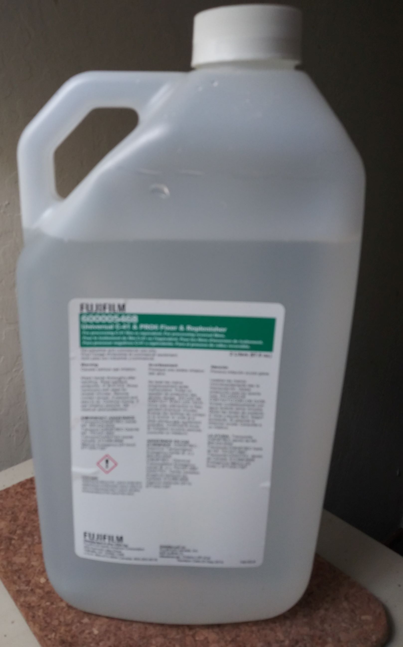

I have the fixer you are asking about in the 20L size. the concentrate comes in a 2L bottle that when mixed for E-6 gives you 20L.
sorry about the poor photo but my camera phone is garbage
