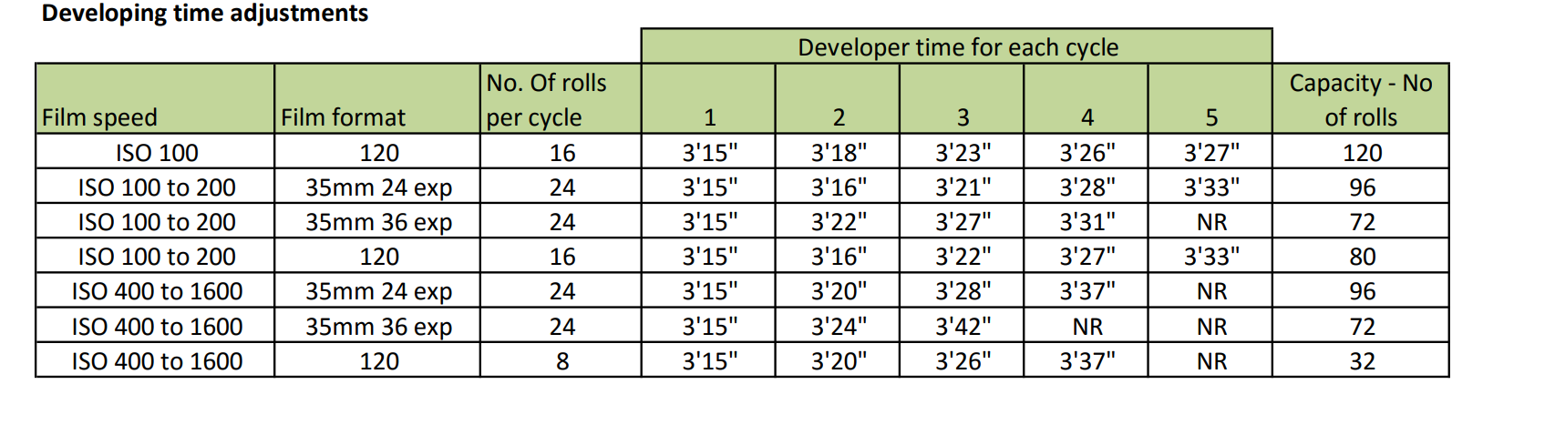

The development times progress throughout each of the 5 'cycles', so if I were to do the below, would that be suitable:
Rolls 1-4, 3:15
Rolls 5-7, 3:18
Rolls 8-10, 3:23
Rolls 11-13, 3:26
Rolls 14-16, 3:27
I've attached the timings table from one of the links above and have based the above timings on the first line, but I've obviously reduced the amount of rolls per L that I'm planning to develop, so the amount of rolls before increasing times has reduced.
My main concerns on the timings are that:
A) the timings are so close that the accuracy when hand pouring in and out of a Paterson tank may not be great.
B) the timings on the cinestill 1L kit climbed much quicker and by bigger amounts, however I appreciate this kit is different.
Finally, when it comes to the inversions/agitations/frequency, I'm honestly lost. The instructions are horrible to follow and they seem unnecessarily complicated!
Can anyone give me a quick run through on their approach to the frequency agitation and inversions? And if possible, their wash/rinse stages (especially if you've added any, as I've always rinsed between Dev and blix on the cinestill chemicals).
Thanks so much!
I agree. I would personally just round to the next quarter minute and call it good. So maybe up to roll 7 stick with 3m15 and use 3m30 for the remainder.

Essentially with these reuse scenarios in a small amateur lab, you're always pretty much off the beaten path of 'official' color processing. I suppose the Cinestill and Fuji have done their homework and have done some tests to verify how to remain within the ballpark. Which is to say, I'd just stick to what the manufacturer of your chemistry outlines.
