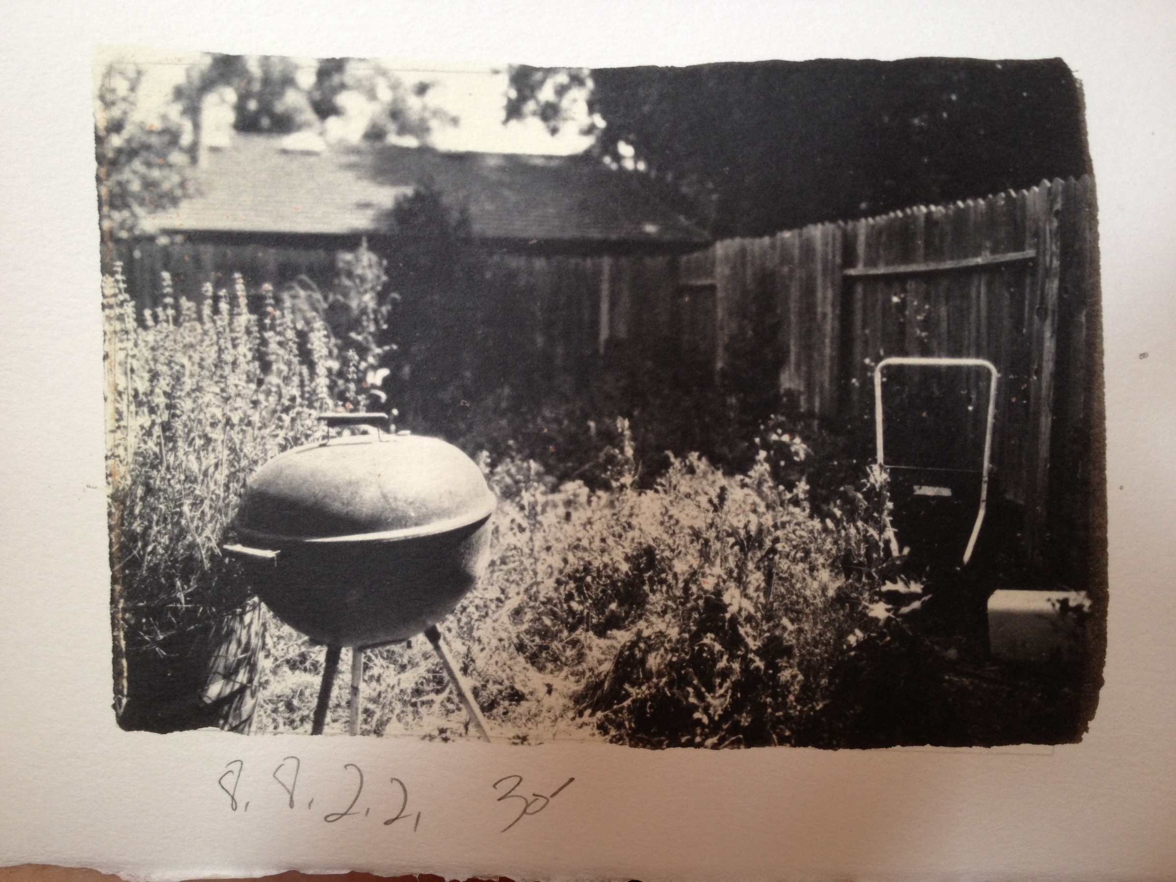

You have to keep an open mind about Xray film. Again, there's no anti-halation back so your highlight can bloom and it's not panachromatic.
Here's a shot done with Fuji RX film which is blue sensitive printed on palladium.
